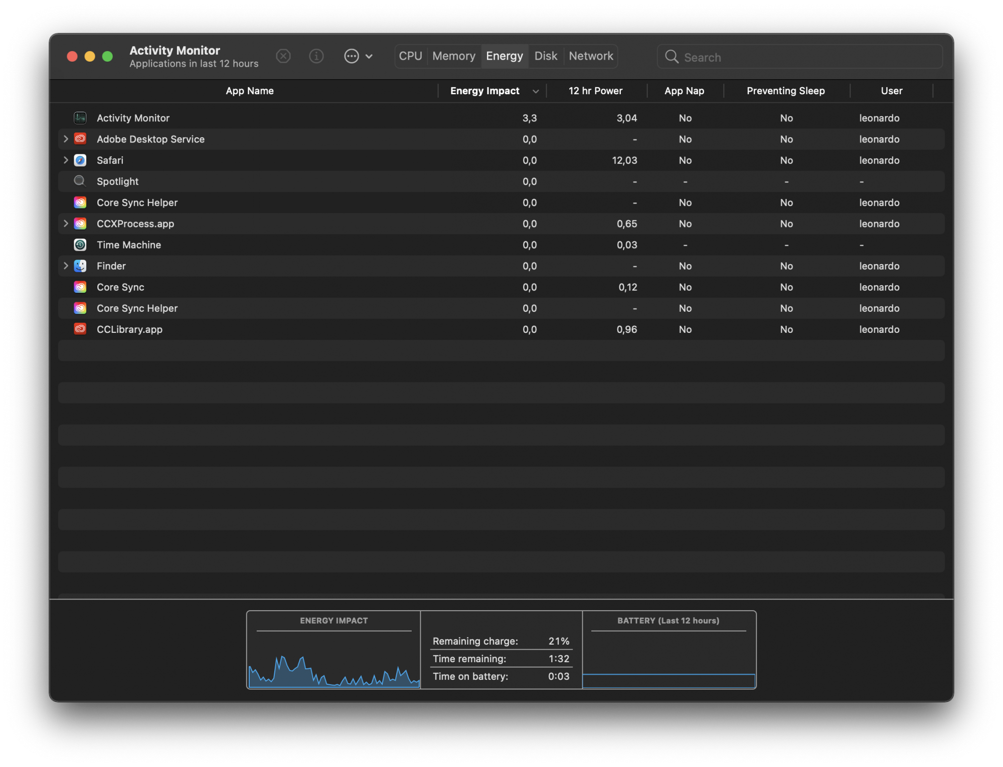

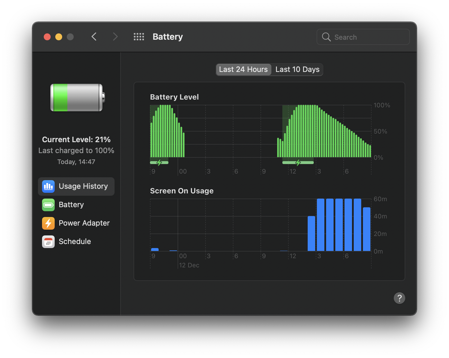

Hi guys.
I bought a low-tier MacBook Pro M1. After a couple of days of indexing etc, I was expecting the battery to last way longer.
Here's my setup and daily use:
- It is connected to an external HD monitor through a usb-c -to-HDMI adaptor, as well as an external mouse via USB.
- Laptop's display brightness roughly at half power, sometimes i even turn it completely dark.
- Apps running: Safari (just a few tabs, very little video watching, lot of forum and blog reading), and Activity monitor. That's it. No other "visible" apps opened.
- I also installed Adobe apps and Steam without really using them, and Anphetamine to be able to use an external display in clamshell mode without charging, and nothing more that could potentially run in the background.
Apparently, even though some Creative Cloud processes are running, they are not using much energy (at least according to Activity Monitor).
Anyway, here are a couple of screenshot for your understanding:

Run the activity monitor for longer and get a solid full to empty run and see what's using the energy.
That's simply the "Applications in the last 12h" view. But sure, I suppose I could run it again tomorrow and leave it on for several hours before taking a screenshot.

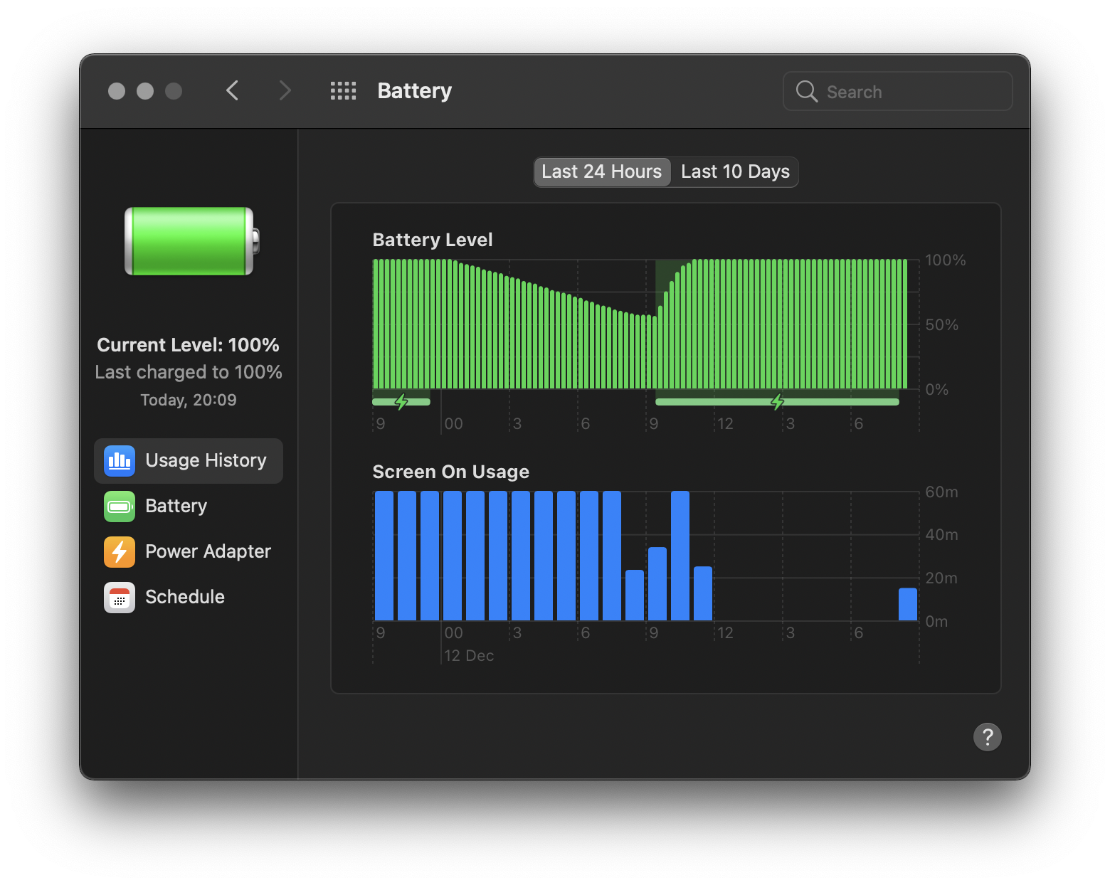

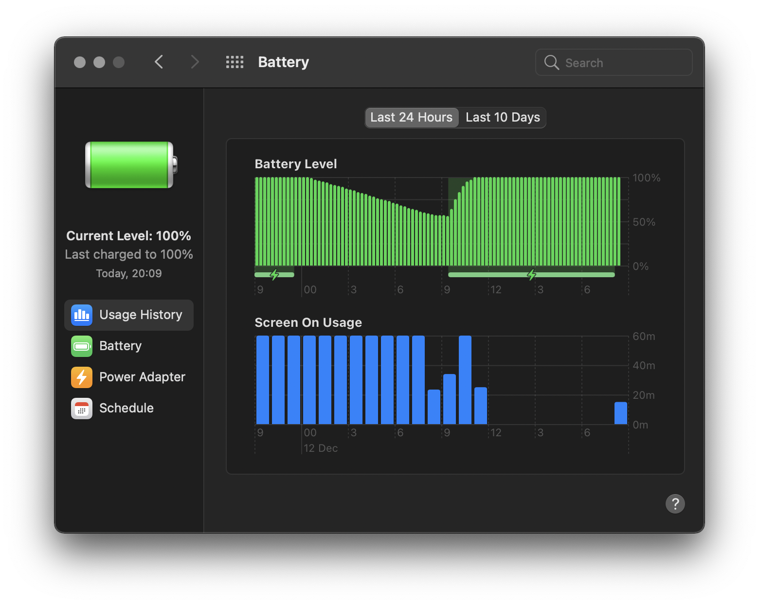

Somethings definitely not right, low end MBP user here too, I fell asleep with YouTube running on Safari and woke up to over 50% 8 hours later:

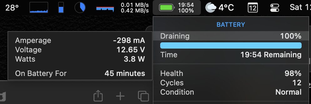

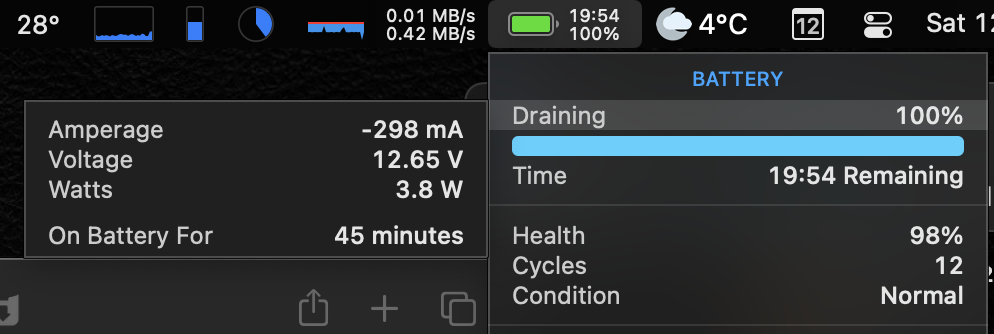

When I first got it I had similar battery drain, somewhat unrelated but I had OneDrive constantly uploading a file over and over, which didn't show on Activity Monitor power drain. If you have iStat Menus you could keep an eye on the Amperage/Watts consumed as you change things, which is how I narrowed it down:
