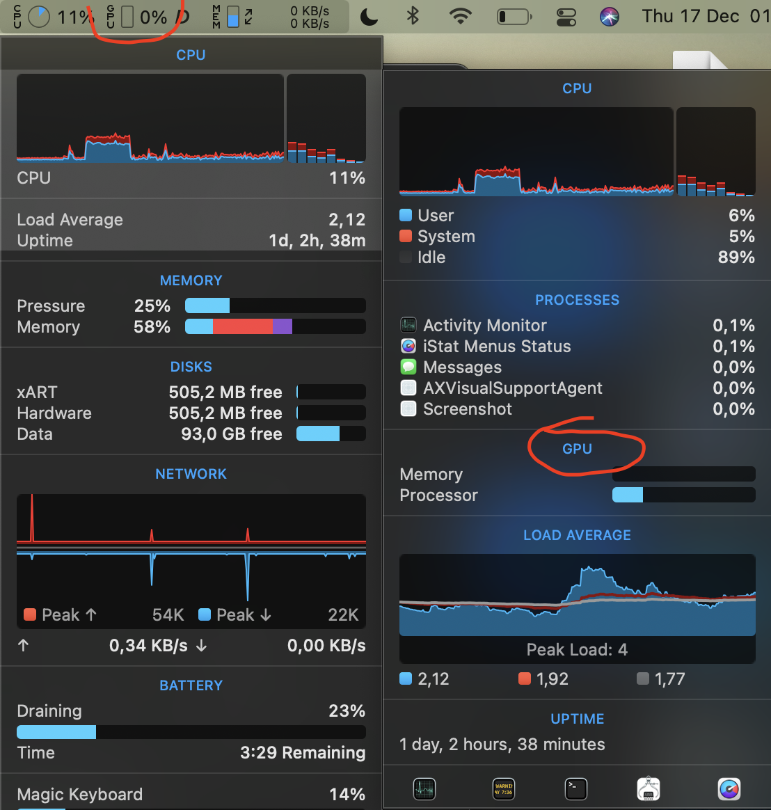

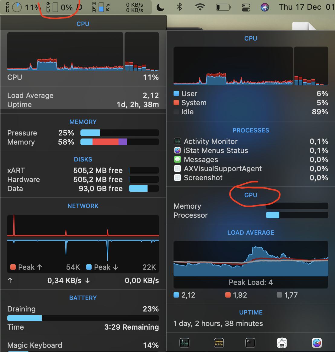

I noticed a very weird thing: through the iStat graph, the GPU usage is always 0, no matter the usage. Other similar apps act the same way, like iStatistica, for instance. The only exception seems to be Activity monitor, which actually do show GPU usage with credible values.
In the iStat Menus screenshot, the GPU graph won't even be shown.

Is anyone else experiencing the same thing?
I'm running Big Sur 11.1.

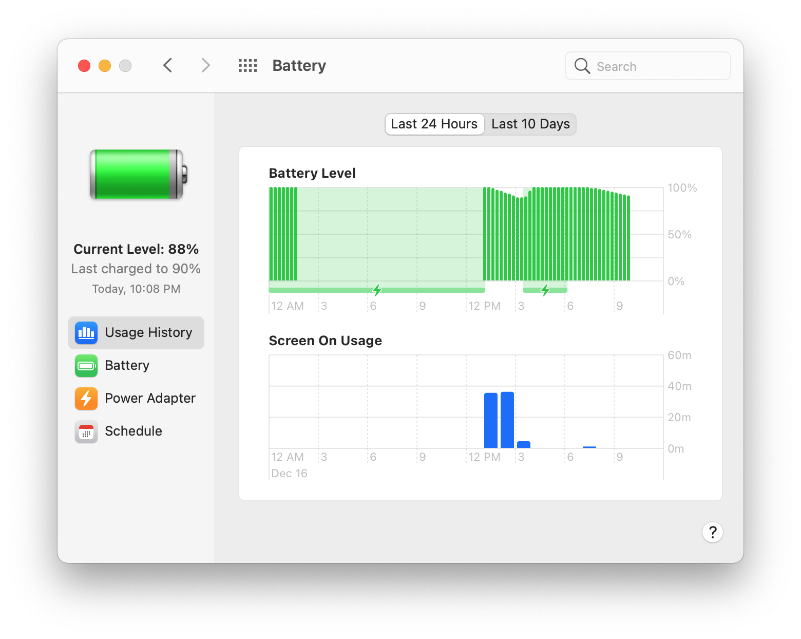

I've been experimenting with battery only clamshell mode which I thought was impossible but someone posted an undocumented pmset command to enable it:
sudo pmset -b disablesleep 1
Since I set that, I've been running my MBA in clamshell mode since around 6:00 PM EST. after 4.5 hours, I'm down 12%. I've been playing around with the latest Docker and reading and posting here and doing a little video. Normal moderate usage. At this rate I would get another 15 to 20 hours of battery.
Edit: The last charged to 90% 10:08 PM was when I plugged it in for about 2 minutes to wake the screen (it didn't work, I had to open the display briefly and then when the external woke up, I put it back in clamshell).

Very interesting, both the amount of battery charge it uses in clamshell mode, and how you were able to force-use clamshell mode even without charging nor third-party apps (like Amphetamine).
May I ask if you used third-party apps for this purpose before, and if you saw a big battery drain?
Also, with that terminal command, does your mac go to sleep if it's not connected to external displays?

No, I didn't even realize it was possible until someone posted this magic incantation. In the past it was probably a lot less useful to use your MacBook in clamshell but now that the battery is so good, it becomes something I will use a lot of.
Looks like you're running an old version of iStatMenus. The GPU topic is now called Apple M1.
I'm running the 6.5.1 version, and I'm pretty sure it's the most recent one. And it should support M1. But alas...
