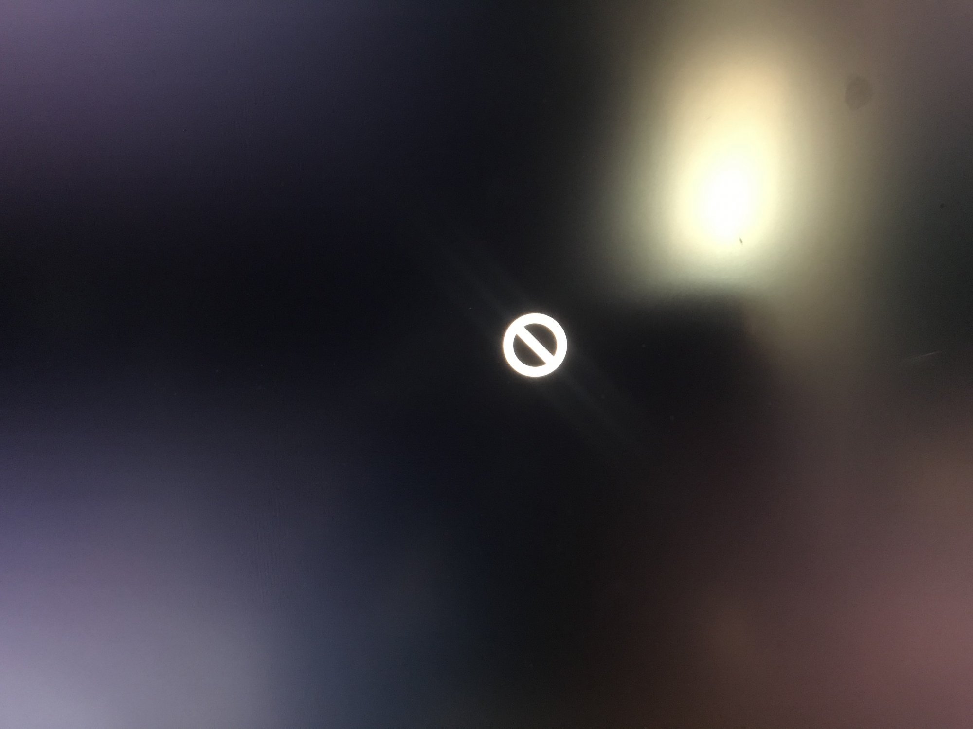

Unfortunately with your config.plist I can't boot both Catalina and Big sur. Photo attached. thank you

Then this (I didn't expect you removed the no compat check boot argument, you shouldn't do that for Big Sur / Catalina)
Great! it works perfectly now!
Thank you for your hint... I think I have taken that disinformation somewhere when tried to install big sur the first time...
Now I'll compare and study the config.plists in order to understand what you have changed...
thank you again for your help

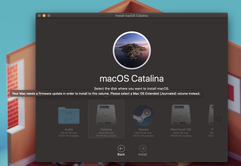

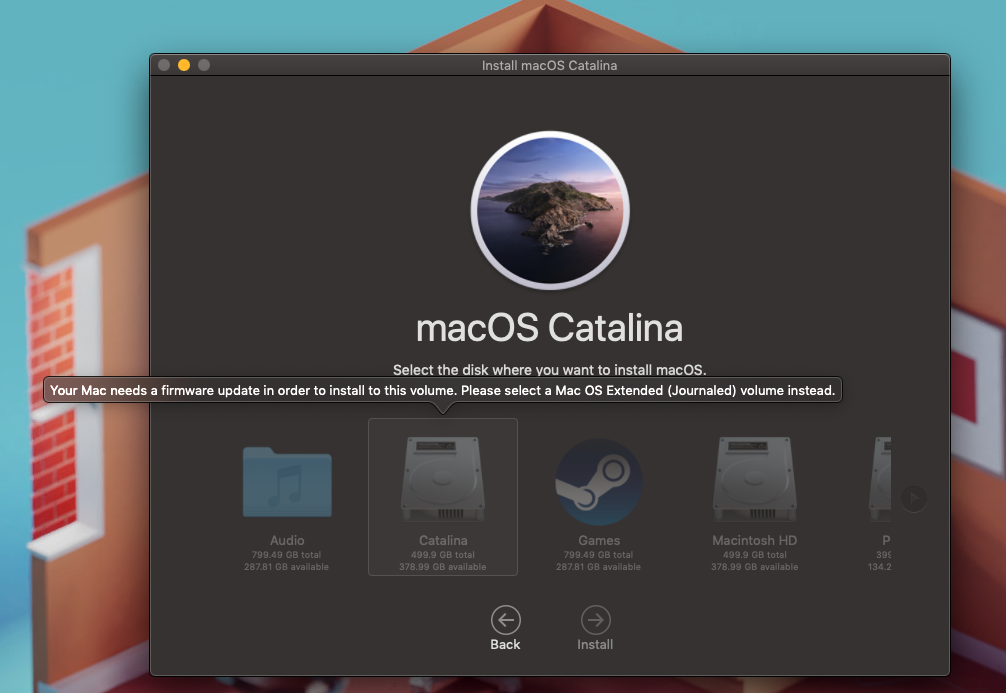

When I try to install Catalina, Even with a blank drive installed ready for it to be installed on, I get this error: "Your Mac needs a firmware update in order to install to this volume. Please select a Mac OS Extended (Journaled) volume instead.
I'm on Boot ROM version 144.0.0.0.0 already...
Any suggestions?
Additionally, if I format that drive as HFS+, it allows me to install, but on reboot I get "An error occurred while verifying firmware"

To all who replied to my request for help, thank you very much!
After checking a few things I realized that when I downloaded the OpenCore I didn't pick the right version, so the configuration file was wrong for the version I had.
When I opened the page the first time I assumed the version I needed was at the top of the page and away I went with that. In any case, it is all good now.
I downloaded the proper one and repeated the process and I am at the point now that I am downloading Catalina to then proceed to the installation.
Any suggestions?
Turn off SMBIOS spoofing if that still on.

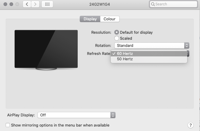

Hi everyone, sorry if this is a dumb question but I couldn't manage to find an answer on this thread.
I'm new to opencore, and I successfully installed it (v. 0.6.1) on my dual CPU 5,1 using h9826790's config. Everything seems to work fine, except that my 144Hz monitor is now stuck to a maximum refresh rate of 60Hz. The monitor is a AOC 24G2U connected to a RX580 through DisplayPort. Disabling DirectGopRendering didn't changed anything.
Any idea? Thanks!
Any idea? Thanks!
So without OC you get 144Hz with the same cables in Mojave?
Thanks for your reply! I forgot to mention that I was already under Catalina, installed with the compatible Mac method. I directly installed OC on the EFI partition of my Catalina install.
But basically yes, I had 144Hz recognised by default and working with the same cable and it disappeared since I installed Opencore.
I did a little bit of trial and error, and changing the "DP capability" setting in the OSD of the display to 1.1 and then reverting it back to 1.2 recovered the 144Hz setting in System Preferences. However, it is gone again after a restart... Not very convenient if I have to do this trick every time I boot the Mac.
Please try to boot to Catalina directly (e.g. by inserting the no compat check boot argument) to check if that's really OpenCore related.
Reactions: startergo
Ok, so I deleted OpenCore, reseted the NVRAM, went into recovery with a Mojave backup drive to add no-compat-check, and went back to my main Catalina install... and it worked, the AOC is recognised as a 144Hz monitor straight away.
