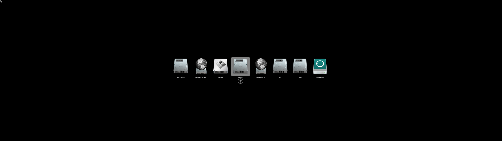

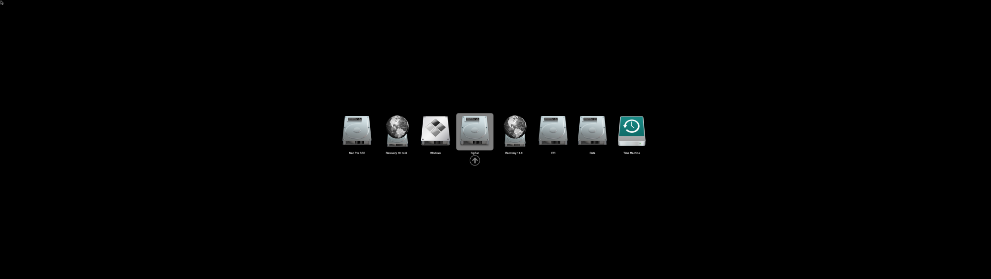

Is it possible to configure OpenCanopy for ultra widescreen resolutions, such as 3440x1440? My boot picker is stretched really wide.
It works fine on my 32:9 (3840x1080) monitor.

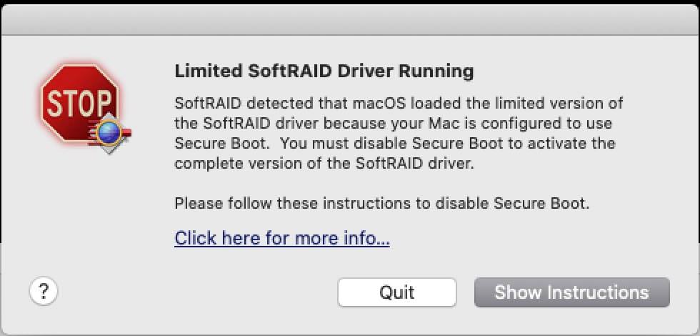

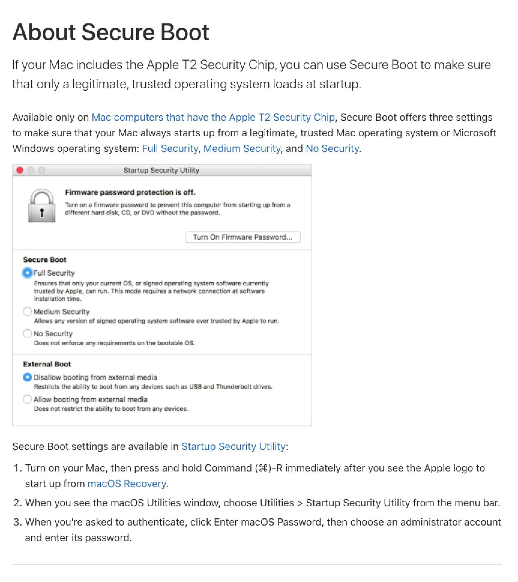

I run a single Xeon as a media server w/4x8tb drives in RAID5 by SoftRAID. Everything worked fine with all the 0.5.x and 0.6.0 releases of OpenCore. Yesterday I updated OC to 0.6.1 and today I got a message from SoftRAID (see below) that it thinks I'm running with SecureBoot (a T2 chip), which obviously isn't the case.
I've never enabled any Security Settings in Recovery Mode, so this must be an OC implementation w/0.6.1. Can anyone provide any insight to managing this in 0.6.1, otherwise I'm going to revert to 0.6.0.

When updating to a newer version always consult with the relevant OC manual, because there might be new parameters introduced. Also there is an ocvalidate utility for checking the configuration against the current release.
In your case there is a SecureBootModel parameter introduced, which you will have to set as disabled.

0.6.1 added a few options about Secure Boot. Did you config them properly accordingly?
I posted my 0.6.1 package at here
You may try it.

I'm using DisplayPort on a Vega 64. 3440x1440 works fine once booted, just the boot picker is stretched.
I have the same issue with my Vega 64 over displayport and hdmi on my 21:9 monitor. Running the debug version of OpenCore showed it wasn't detecting the 3440x1440 resolution. I tried forcing the resolution but lost my video output. I've chosen to accept it and use my secondary 2560x1440 monitor as my boot display since it displays correctly.
