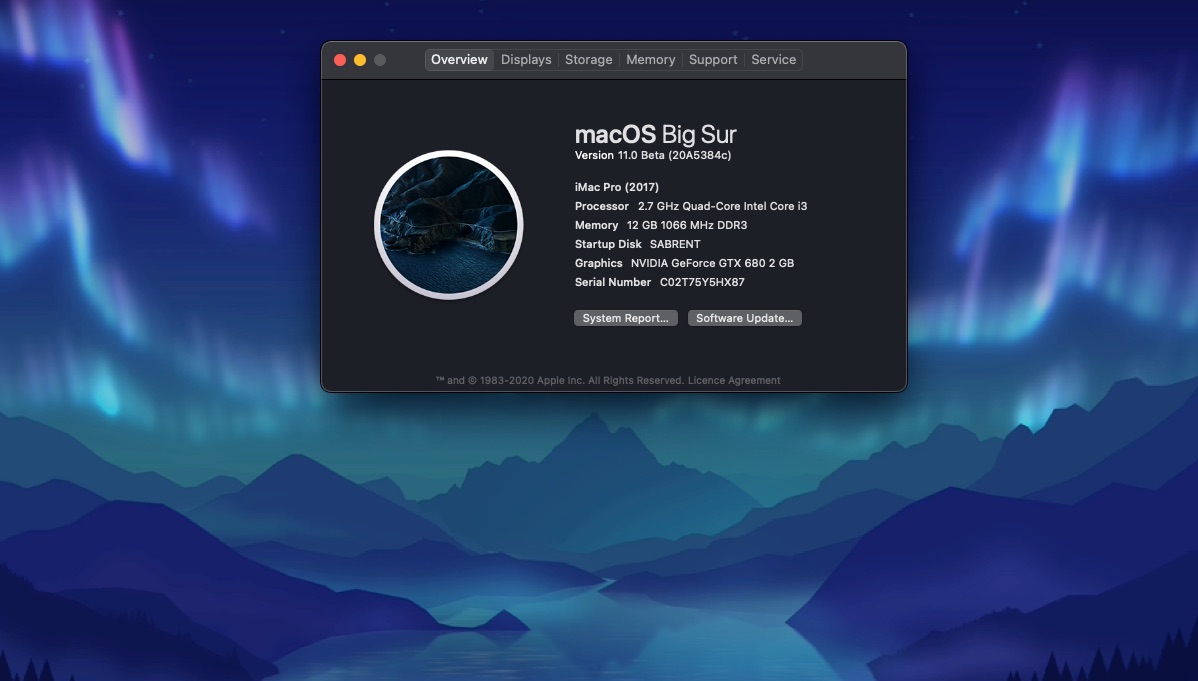

After some messing around in terminal and turning of SIP and authenticated-root from the recovery drive beta 9 installed
Our macs are turning into iPads
Grrrrrrrrrr🥺🥺🥺

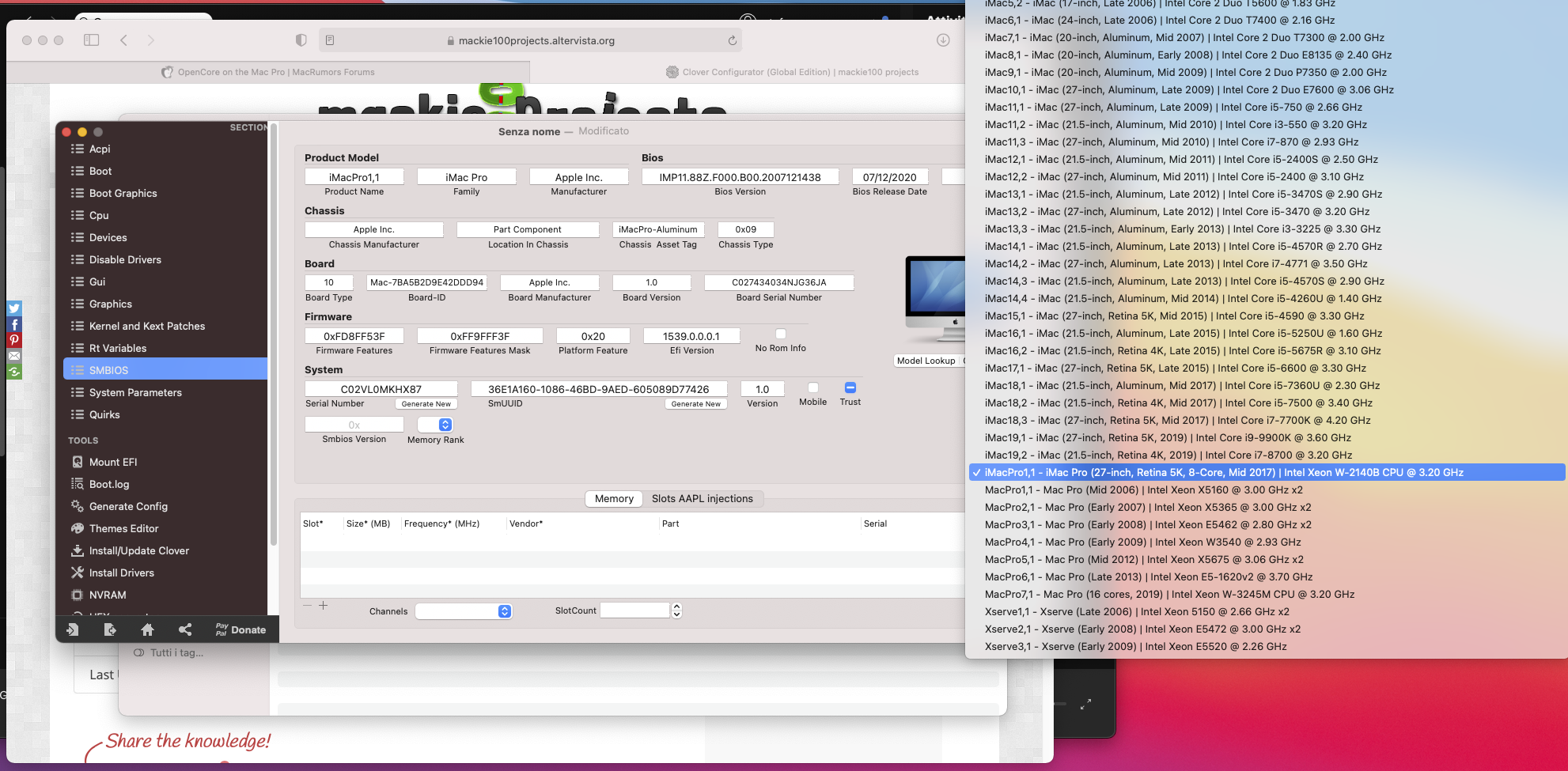

I have just followed what you said, I have modified the smbios part according to your post #7 and let cloverconfigurator create a “unique random” serial for an iMac Pro 1.1. The update appeared immediately. The only downside is that I had to connect an hdmi cable to the monitor instead of the DP connector at first boot after the config mods to correctly boot and seen the desktop.
After the update I’ll copy my previous config.plist backup.
EDIT: your posts and helps are always clear and helpful. Thank you
I've never used clover configurator before. I've only used mac tools and Opencore editing with TextEdit
Can you explain how to let it create a “unique random” serial for an iMac Pro 1.1?
thanks
thanks
Hi David, just download latest clover configurator than on SMBIOS section select iMac Pro 1.1 from the list and click on generate new near the "serial number" field.
Then just pick up one of those for install/update purpose.
attached a screenshot

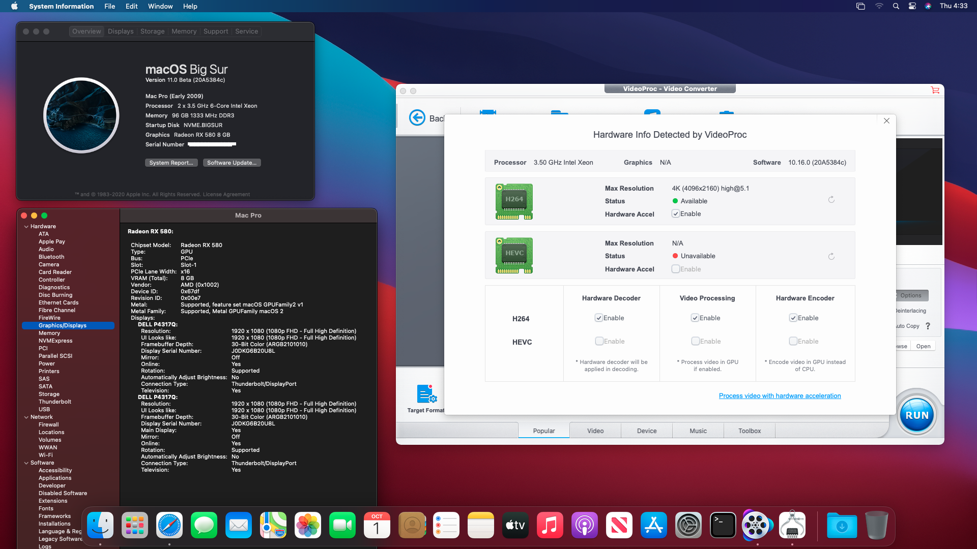

I installed Big Sur Beta 9 last night on my MacPro4,1(5,1) running OpenCore 0.6.1 with RX580.
Odd thing is that HEVC hardware acceleration is now listed as unavailable by VideoProc. Only H264 is listed as available.
To troubleshoot, I booted into macOS Catalina with the same exact hardware and OpenCore configuration, and Video Proc reported that both HEVC and H264 hardware acceleration are available.
Does anyone know how to resolve this and get HEVC hardware acceleration back? I have not encountered this issue in the prior Big Sur betas, so I assume Apple did something to Beta 9.

You right!!!
They might have done something this time, because I have the same... Well I am gonna have to look into it too, or maybe because video proc needs an update I do not know.
Looking into now...
Well updating VideoProc did not do anything but they then they really did something this time...
Apple when you hold us!!!!

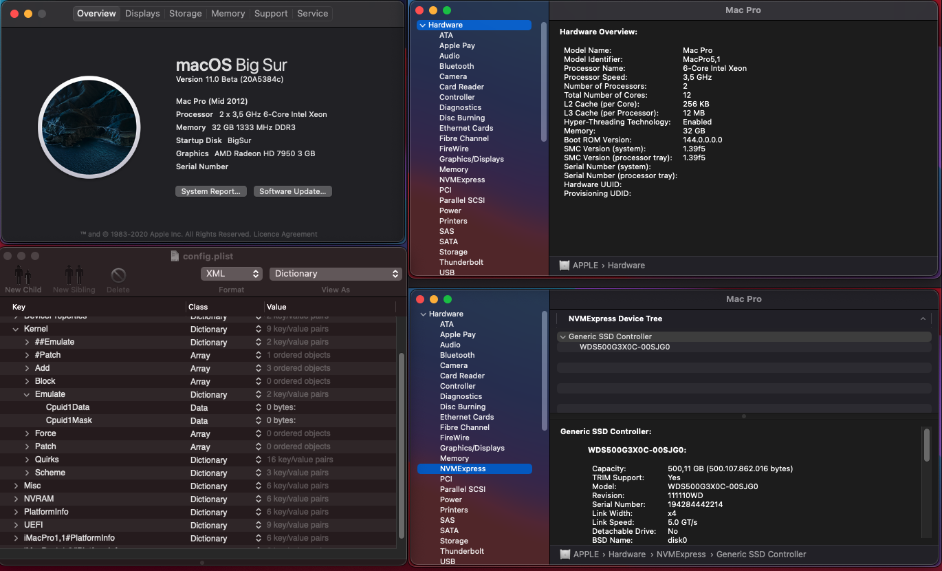

Hi, just want to add some findings about SecureBootModel and big sur beta 9 (maybe other betas too?) that maybe you didn't notice.
I don't have a mac pro, but this should be the same..If you are able to boot with "Disabled" or "Default" you will notice that with Disabled you are booting from a snapshot, with Default you are not booting from a snapshot, but directly from the big sur system disk.
I noticed this during the upgrade from beta8 to beta9, because I received Download failed error and I noticed that with SecureBootModel Default mounting / for read and write returned error 77 (because of sip enabled) instead of error 66.
Setting it to Disabled returned error 66.
I don't know if this is an expected behavior, but as far as I remember with the setting to Default I was able to update from beta 7 to beta 8.
I guess you referred to a previous opencore version 0.6.0 , but seems from 0.6.1 setting SecureBootModel Disabled is required to boot BigSur on unsupported Mac, and either with Disabled you can have a snapshot booting and OTA update, while to disable snapshot booting this should work to fix "sudo mount -uw /":
https://forums.macrumors.com/thread...unsupported-macs-thread.2242172/post-28958380
while to make a new bootable snapshot simply: sudo bless --folder /System/Library/CoreServices --create-snapshot
I add also that from recent BigSur releases to disable SIP without a "Custom Configuration" this value for OpenCore worked csr-active-config: fwgAAA== , for @startergo and @Dayo customised refindGOP this new value 0x87F for BigSur correctly disabled SIP.
