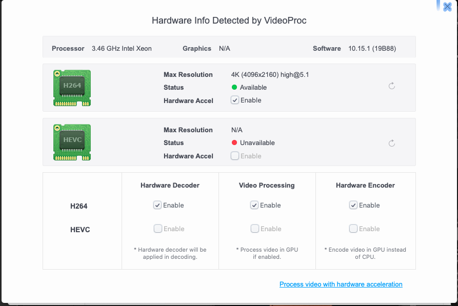

@startergo What are you trying to say? None of this works, neither on a real Mac Pro nor on a Hackintosh. Shiki is broken right now. Some people in here tested it, a bunch of other people from the Hackintosh scene tested it, I personally tested it on my Hackintosh. I am trying to get the WEG developers on this issue for a couple of days now but as I said above, nobody does believe me.

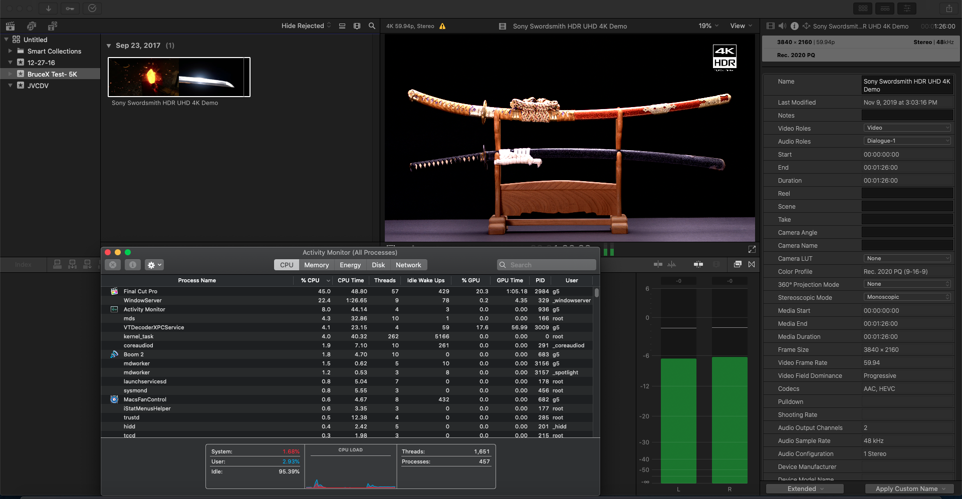

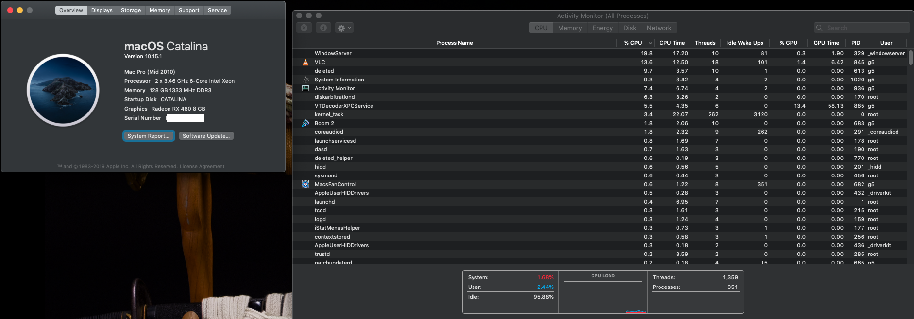

Can you please elaborate what exactly is not working? I am testing it now.
Playback of HEVC works. Does somebody know how to insert the onscreen debug messages from Lilu to a log file? I use -liludbgall argument and the messages scroll on the screen during boot.

Catalina HEVC playback.
[automerge]1575056384[/automerge]
FCPX HEVC playback. Of course 10.15.1. I believe @h9826790 said things are broken in later Catalina development release. No official release yet. Maybe the things will get better.

HEVC acceleration on the AMD is not working on your machine as for anyone else. VideoProc shows red light, CPU load is high. The GPU load displayed in Activity Monitor is something else. Decoder / Encoder load isn't displayed there.
