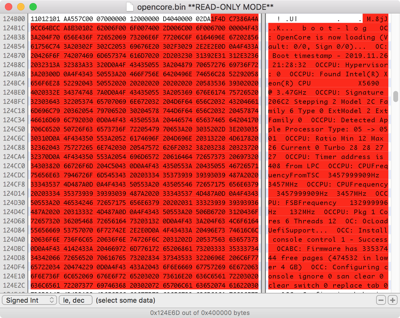

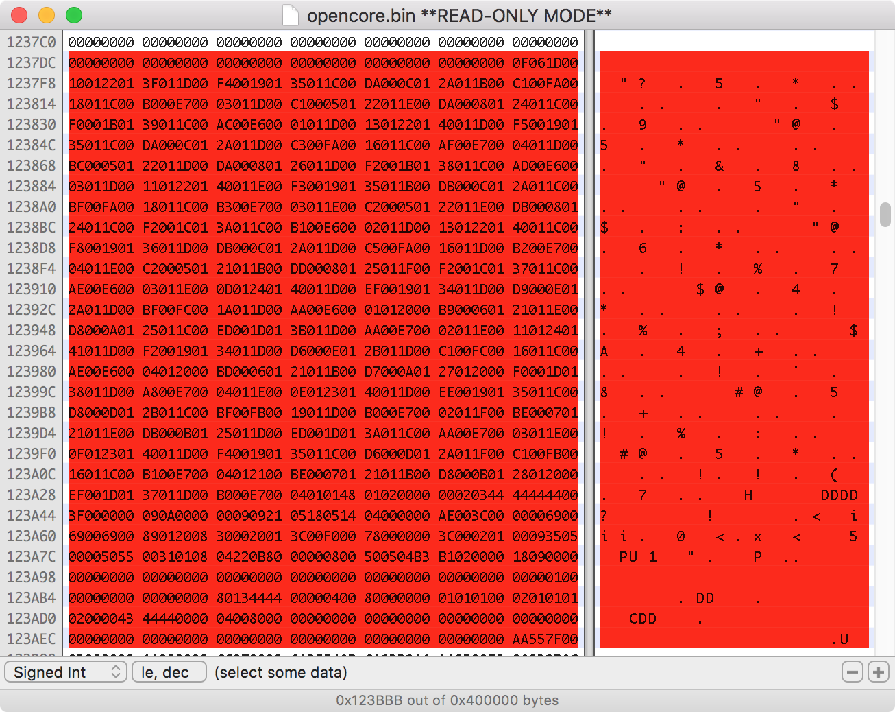

So I inserted the debug version of opencore.efi, enabled debugging to file and rebooted. I saw all debug information scrolling on the screen after which it halted saying NVRAM full so I dumped the firmware for analysis. Alex quickly inspected the firmware and said it was writing the log to NVRAM . I Compared the firmware to a known good firmware with WinMerge and recompiled both files as text.
First and most important thing I noticed is that the XML property list was missing. For instance here is the XML file in a good firmware NVRAM:

In the firmware with OC that section is missing. Also if I use bless --info it complains the XML file is broken (now I know why).
Second thing is that it logged everything in the NVRAM :

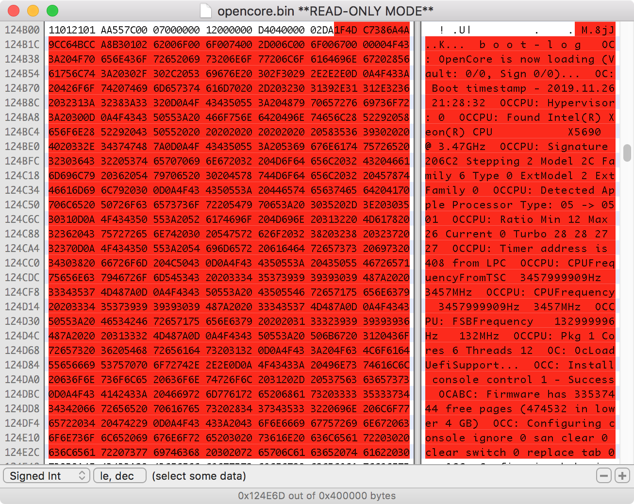

There were sections in the NVRAM completely FF'd.

I enabled these options:
0x01 (bit 0) — Enable logging, otherwise all log is discarded.
0x04 (bit 2) — Enable logging to Data Hub
0x10 (bit 4) — Enable UEFI variable logging
0x20 (bit 5) — Enable non-volatile UEFI variable logging
0x40 (bit 6) — Enable logging to file
My wild guess is "0x04 (bit 2) — Enable logging to Data Hub" writes to the NVRAM.
Debug file in the EFI folder is attached.
IASInstallPhaseList.plist is a log that macOS installer (Recovery too) creates to facilitate debug process of unsuccessful macOS installs. It's not needed for anything else and it's recreated when you run macOS installer or Recovery again. It's not permanent and can be erased if NVRAM space is needed.
Again, no one without means to reflash the SPI should mess with OpenCore, besides the log that fill up @startergo NVRAM, a big binary table was inside the first stream/store of the NVRAM. Enabling OC log to NVRAM can cause flash cell starvation, be warned.
If you don't have a clean dump, you can't repair a messed up BootROM since this NVRAM areas are not cleaned by Command-Option-P-R.
View attachment 879549View attachment 879550
