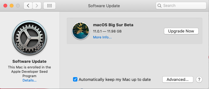

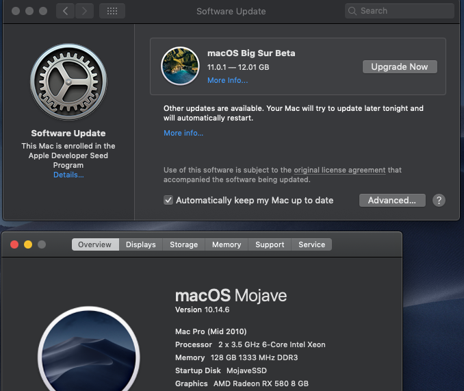

Actually, you should be able to install Big Sur from Catalina without VMM.
Does this mean we can permanently set VMM off by default? Before we needed VMM to check updates. I just checked the first post and it says VMM is required for updates?

Just updated Big Sur with OC 0.6.3 without VMM. I just use h9826790 package, the first reboot will creat a macintosh HD for update no matter what is your main disk name. For second boot, it return to my default drive and it should boot inside OS, my monitor run at full resolution and loupdeck show normal activated. everything smooth and easy up to 11.0.1 RC. Thanks for all effort.
