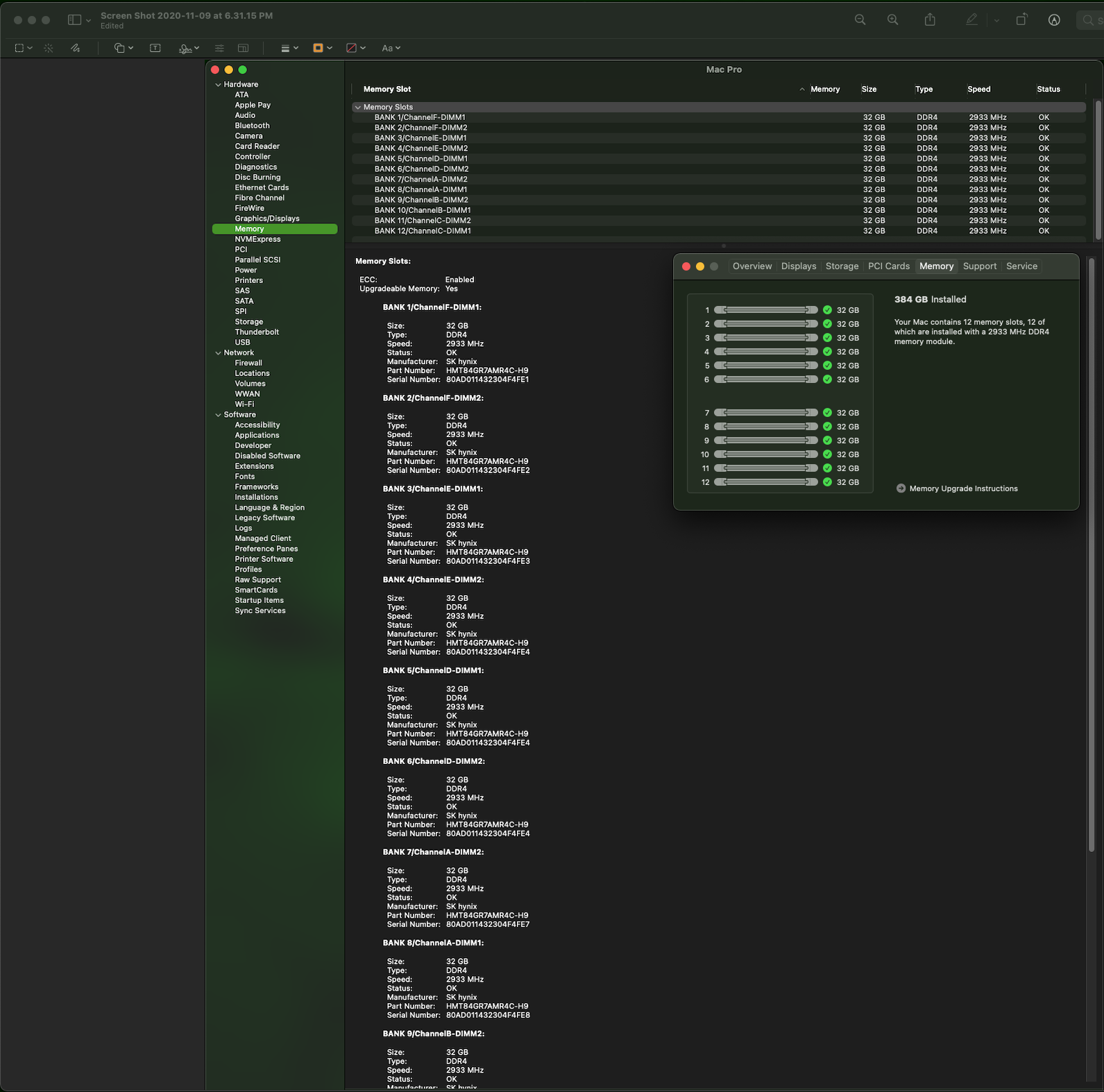

All credit goes to cdf, he found the critical firmware feature ma
I can today confirm that we can have 256GB of ram 8x32GB. Running it in my Mac Pro ( see my signature )
Tomorrow I will try 512GB with 8x64GB. It should not be a problem though.
I have also ECC Registered sticks, and ECC shows enabled in the System Information.
I will tomorrow post pictures.
Y'all have a great Sunday.

Tried and Tested 64GB Modules and it did not work. Unless I have missed something.
So 256GB 32x8 is the maximum we can have in our MacPro here is a screenshot.
Hey 205Maxi. So you got 384GB working? That's perfect. It's a triple channel CPU anyway. Personally, I was never going to use 8x64 anyway. From the screenshot you sent it looks like that's the limit you are hitting? Is that the issue you mean or is it something else? Are you saying it doesn't work because it's not reporting properly in the RAM section?
