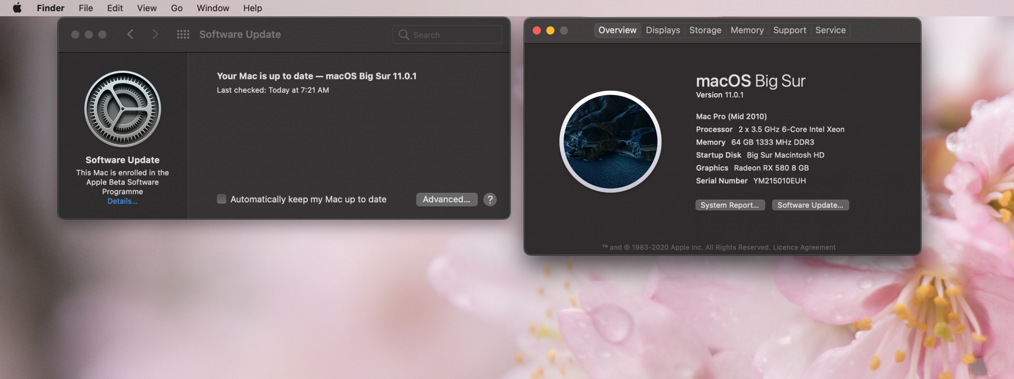

Big Sur RC 2 / open core 0.6.3 no vmm upgraded without problem.
Reactions: h9826790

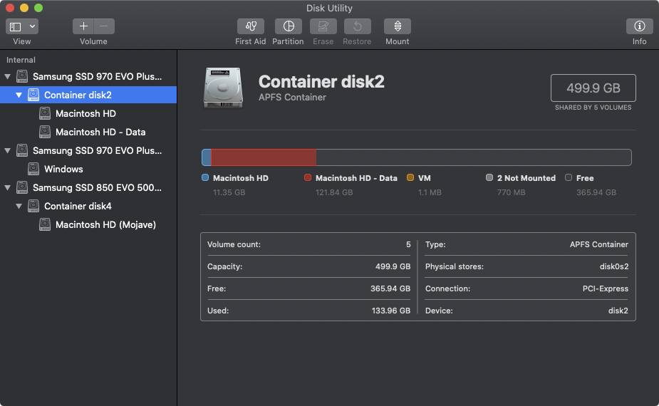

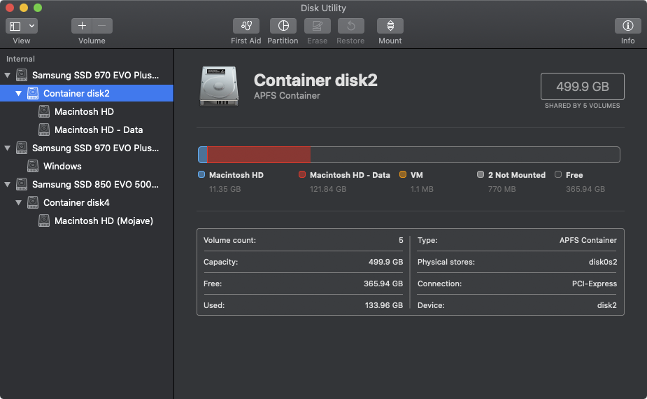

I have a standard setup, running Mojave on Disk A and Catalina with OC blessed on Disk B. Will I need to format the B hard drive, if is currently formatted as APFS?
Code:
$ diskutil list disk0
/dev/disk0 (internal, physical):
   #:                       TYPE NAME                    SIZE       IDENTIFIER
   0:      GUID_partition_scheme                        *500.1 GB   disk0
   1:                        EFI EFI                     209.7 MB   disk0s1
   2:                 Apple_APFS Container disk2         499.9 GB   disk0s2
I have a standard setup, running Mojave on Disk A and Catalina with OC blessed on Disk B. I will need to format the B hard drive, is is currently formatted as APFS?
Code:
If you do that correctly, only format the APFS partition (or more precise, the container), but not the whole drive B. Then OC should stay, and you can still make a clean Big Sur installation on drive B.

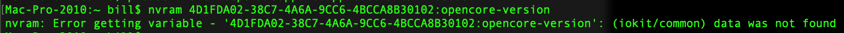

Bash:
Machine:~ username$ diskutil list
   0:      GUID_partition_scheme                        *960.2 GB   disk0
   2:                 Apple_APFS Container disk1         704.0 GB   disk0s2
   3:       Microsoft Basic Data Windows                 255.9 GB   disk0s3
/dev/disk1 (synthesized):
   0:      APFS Container Scheme -                      +704.0 GB   disk1
                                 Physical Store disk0s2
   1:                APFS Volume Macintosh HD            197.2 GB   disk1s1
   2:                APFS Volume Preboot                 27.1 MB    disk1s2
   3:                APFS Volume Recovery                507.4 MB   disk1s3
   4:                APFS Volume VM                      20.5 KB    disk1s4
Bash:
Machine:~ username$ sudo gpt -r show /dev/disk0
Password:
gpt show: /dev/disk0: Suspicious MBR at sector 0
       start        size  index  contents
           0           1         MBR
           1           1         Pri GPT header
           2          32         Pri GPT table
          34           6
          40      409600      1  GPT part - C12A7328-F81F-11D2-BA4B-00A0C93EC93B
      409640  1374945080      2  GPT part - 7C3457EF-0000-11AA-AA11-00306543ECAC
  1375354720         160
  1375354880   499767296      3  GPT part - EBD0A0A2-B9E5-4433-87C0-68B6B72699C7
  1875122176      262799
  1875384975          32         Sec GPT table
  1875385007           1         Sec GPT header

The lines from 125:171 00:110 are what displays after I pick "Windows". The last entry in the log above is what displays on the screen when the boot process gets stuck.
Also note lines 08:412 00:027 to 08:641 00:027. Those show the process of adding the bless entry for Windows. I don't see anything there that looks amiss.
From my reading of the OpenCore code, InternalLoadBootEntry() is called on BootEntryManagement.c:1923, it prints the last log line at DefaultEntryChoice.c:1180, then my best guess is that InternalLoadBootEntry() returns without an error status and Context->StartImage() is called at BootEntryManagement.c:1931. OcLoadBootEntry returns to OcBootManagementLib.c:687. It looks like it's supposed to play a sound on success or failure--but from the log, it looks like audio is disabled. However, on failure, it looks like it should show the boot picker menu again. I don't know much about EFI code, but I think the context at this point in OcBootManagementLib.c:OcRunBootPicker is an infinite loop looking for key presses (see OcBootManagementLib.c:555). I don't know if the Context->StartImage() call only returns on failure or if OcBootManagementLib.c:OcRunBootPicker runs in its own thread.
Any ideas for further troubleshooting?

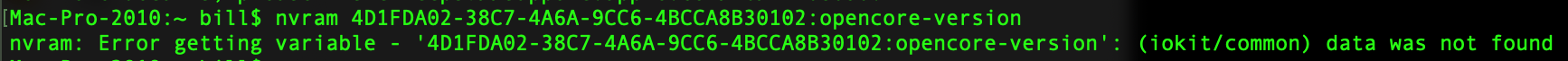

I confirm that each step is strictly in accordance with "PART I Basic Installation", but when enter "nvram 4D1FDA02-38C7-4A6A-9CC6-4BCCA8B30102:opencore-version", it prompts Error 'nvram: Error getting variable - '4D1FDA02-38C7-4A6A-9CC6-4BCCA8B30102:opencore-version': (iokit/common) data was not found"
You have a space between the ":" and "opencore-version". Remove the space and it should work.
