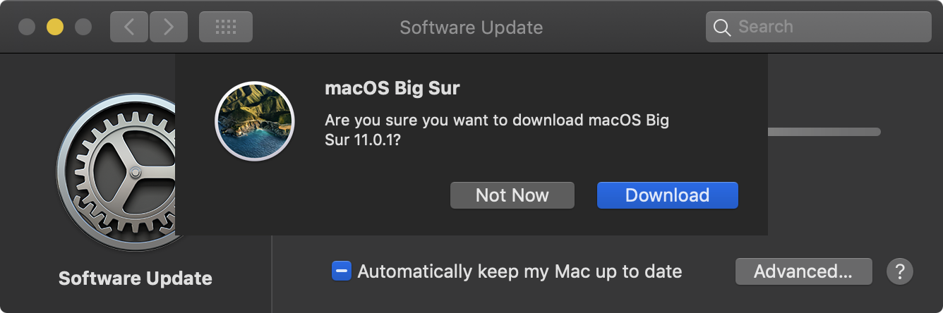

On a Mac Pro 5,1 currently running Catalina and with updated BT hardware, has anyone actually installed the latest release of Big Sur, either from scratch or on top of Catalina, just using OC 0.6.3 with VMM, spoofing et cetera? I mean WITHOUT patching the installer in any way? If so, would this be the recommended way to update, or are there better options (for instance, in order to have Night Shift)? If patching the installer is deemed unnecessary, are there any post-install patches or processes one can run in order to solve minor issues like Night Shift?

I can confirm doing a clean install of 11.0.1 beta by adding the necessary firmware features bit. See post #4,399. No VMM flag necessary. The installer was not patched in any way. I later updated to RC 1 through Software Update. Again, without VMM. I expected the same approach will work for today's release of Big Sur.
Getting Night Shift and DRM to work in Big Sur is another story: I will be looking into full MacPro7,1 spoofing for that.

I would recommend getting the full installer using installinstallmacos (or gibMacOS) and doing a clean install from Mojave or Catalina to a freshly formatted drive. If you've already enabled hybridization, the only OpenCore configuration step should be adding the firmware features bit. See post #4,399.

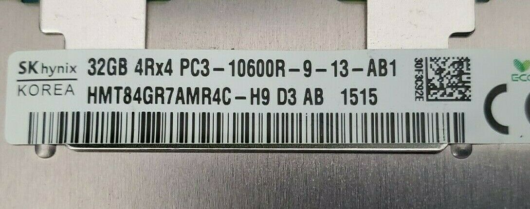

I will do that, ASAP but I can tell you that it ran the 128GB 4x32GB. Guarantied!
I only use SK Hynix R10600 but I am pretty sure that we could have a higher speed like 1867MHz or above... I will test that and report here...
Hey 205Maxi. Do you have the model number of the RAM you tested? Also, did you hit a wall at 1333MHz?

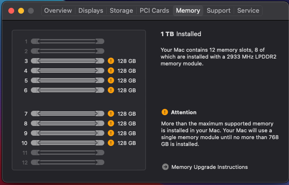

For the memory config I followed the Apple MacPro 2019 scheme -> https://support.apple.com/en-us/HT210103
8 DIMMs is the one we need, note still shows 12 slots. I have configured it on 12 slots scheme because I did not want to see the notification, which as no incidence whatsoever. You would put 1.5TB memory config that it would not change anything.
However when I tried the set the 8 slots according to the supported configuration I would get the error notification. So I reverted back to 12 slots configuration even though we only have 8 slots and the error's gone.
I guess that in the near future if IOIIIO works on the kext notification disabler, that we can properly set the memory config to reflect the true memory configuration of our MacPro5,1.
I preferred to set it that way so 1 less .kext in the driver folder.
I would love to have it configured this way which reflect the true config but then you get error and orange check, which I don't like 😉

Hi, I did it just installing OC 0.6.3 replacing a previous 0.6.1 version I had. Both upgrading from Catalina and doing a fresh install. So it works "out of the box" without patching ( at least for me, in my MacPro 4.1 with 5.1 firmware updated years ago ).

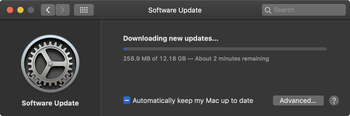

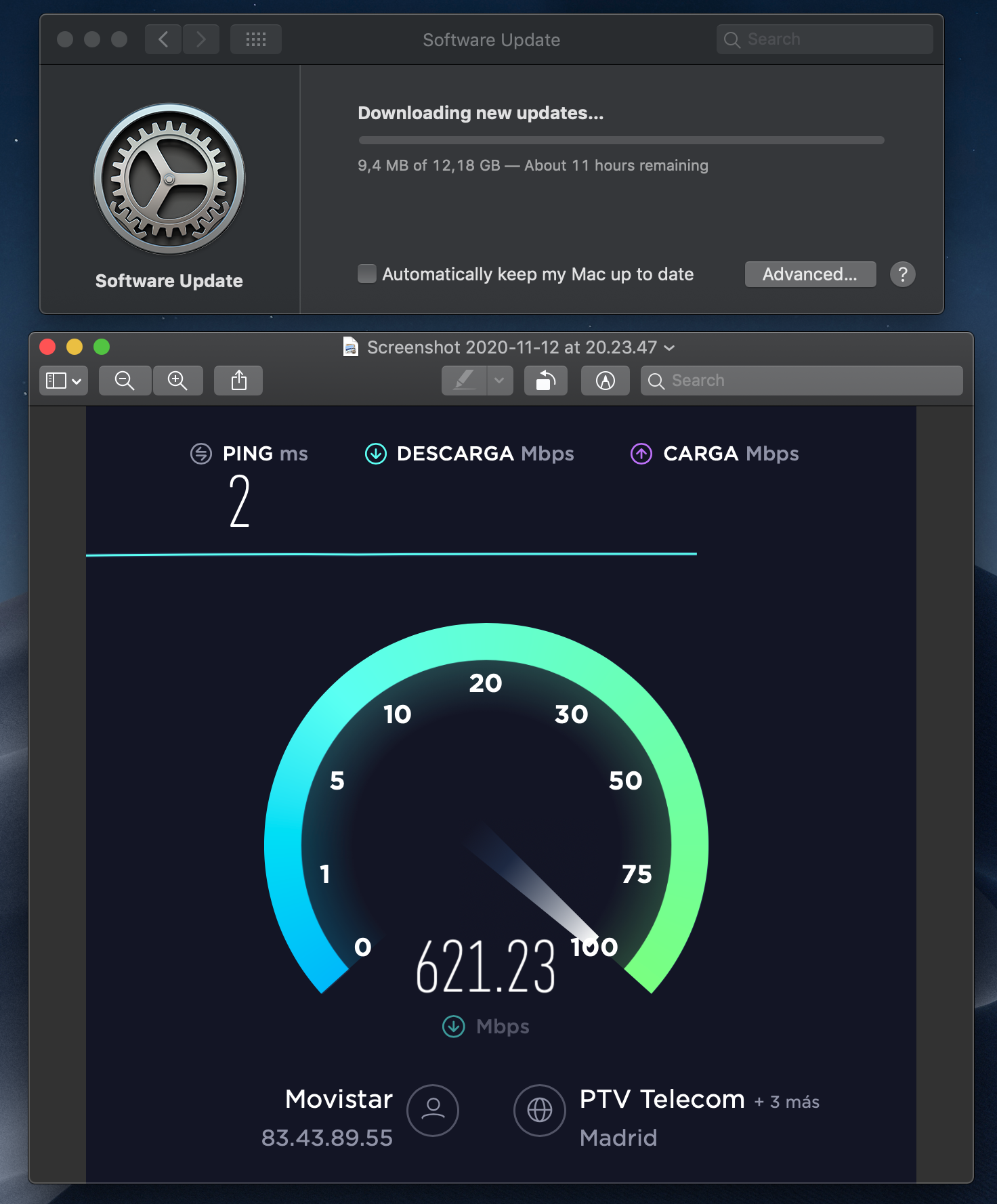

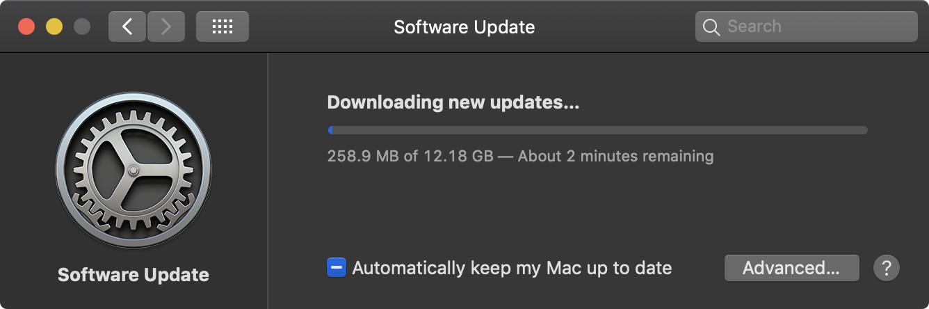

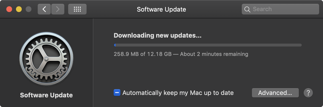

Something looks wrong there. It says you are going to get 12+GB downloaded in less than 2 minutes??? Here's what I got:
Sad to say my connection is that much slower. ???
Servers seem to be super busy to download Big Sur at the moment:
I have 1Gbps internet connection. And Apple server can provide 100MB/s download when not busy. So, 12000/100 = 120s, which is 2 minutes.
Anyway, most likely there are millions of people downloading at the same time. It's expected to be very slow now.
