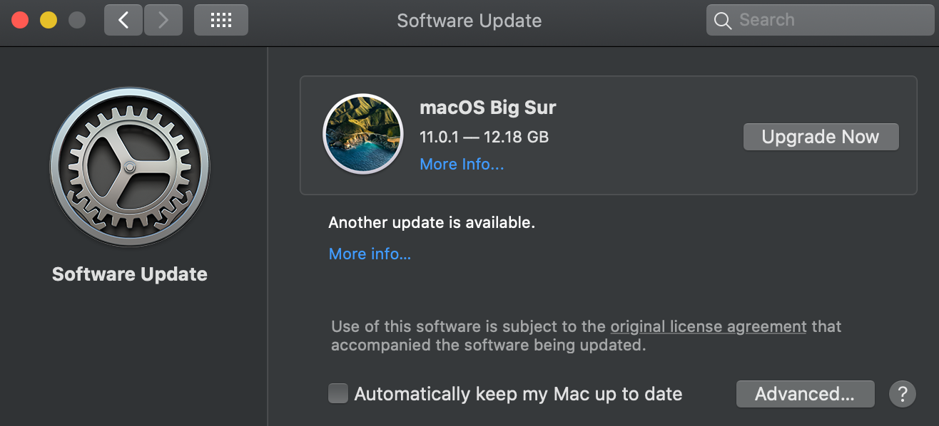

I'm running Catalina here on a cMP5,1 and just got the update notification.
Someone mentioned I might lose WIFI after upgrading (with the standard card)?

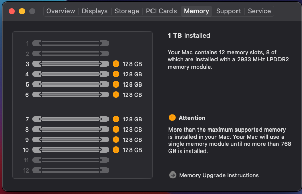

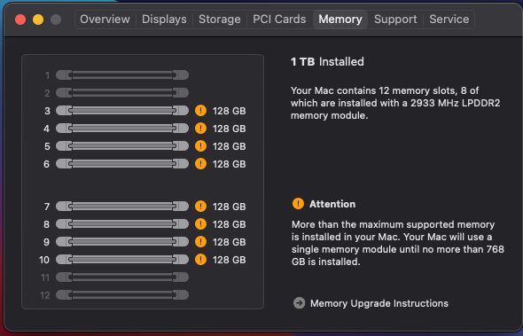

This is what I run in my MacPro have a look here too #4,648
For the memory config I followed the Apple MacPro 2019 scheme -> https://support.apple.com/en-us/HT210103
8 DIMMs is the one we need, note still shows 12 slots. I have configured it on 12 slots scheme because I did not want to see the notification, which as no incidence whatsoever. You would put 1.5TB memory config that it would not change anything.
However when I tried the set the 8 slots according to the supported configuration I would get the error notification. So I reverted back to 12 slots configuration even though we only have 8 slots and the error's gone.
I guess that in the near future if IOIIIO works on the kext notification disabler, that we can properly set the memory config to reflect the true memory configuration of our MacPro5,1.
I preferred to set it that way so 1 less .kext in the driver folder.
I would love to have it configured this way which reflect the true config but then you get error and orange check, which I don't like ;)

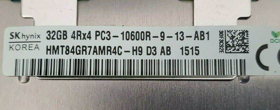

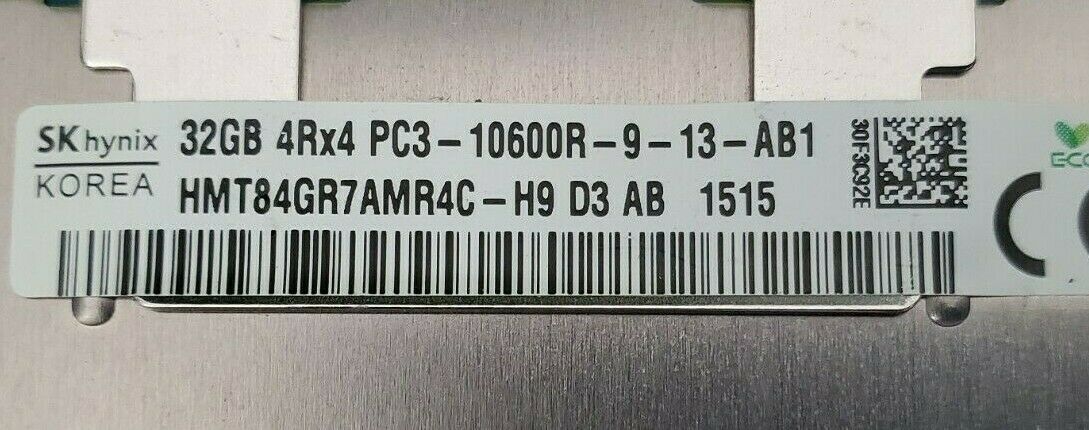

We’ve been able to spoof the 7,1 but can’t get 32GB’s working. Is there any changes to the OC config file you’ve done to get the 32GB’s working?
I would recommend getting the full installer using installinstallmacos (or gibMacOS) and doing a clean install from Mojave or Catalina to a freshly formatted drive. If you've already enabled hybridization, the only OpenCore configuration step should be adding the firmware features bit. See post #4,399.

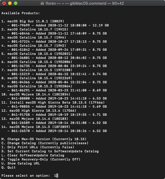

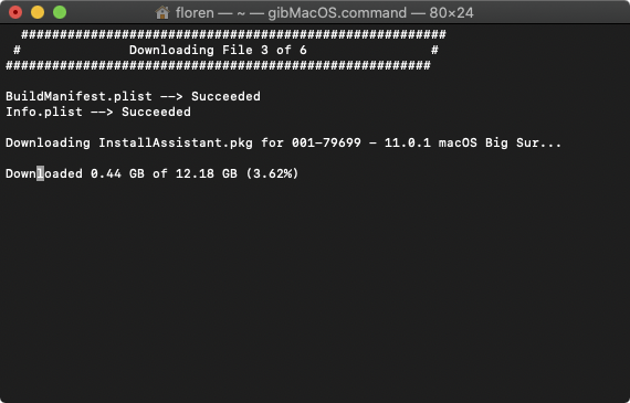

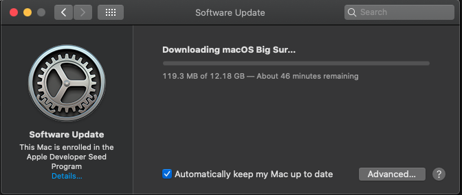

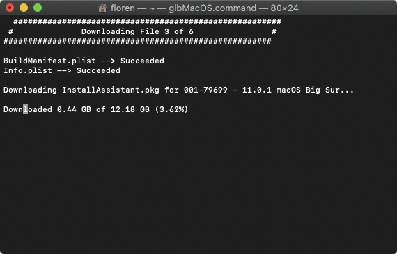

@cdf, I cannot download Big Sur directly. I will try with gibMacOS, never used it before.
Edit, cannot download Big Sur with gibMacOS neither (works fine with Catalina), I get:
Probably Apple servers related.

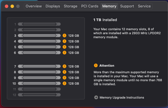

Everything working normally? Any errors? Did you run geekbench?
Code:
curl: (22) The requested URL returned error: 403 Forbidden
Could not replicate http://swcdn.apple.com/content/downloads/50/49/001-79699-A_93OMDU5KFG/dkjnjkq9eax1n2wpf8rik5agns2z43ikqu/InstallAssistant.pkg: Command '[u'/usr/bin/curl', u'-fL', u'--create-dirs', u'-o', u'./content/downloads/50/49/001-79699-A_93OMDU5KFG/dkjnjkq9eax1n2wpf8rik5agns2z43ikqu/InstallAssistant.pkg', 'http://swcdn.apple.com/content/downloads/50/49/001-79699-A_93OMDU5KFG/dkjnjkq9eax1n2wpf8rik5agns2z43ikqu/InstallAssistant.pkg']' returned non-zero exit status 22
Code:
Is that the official direct link?

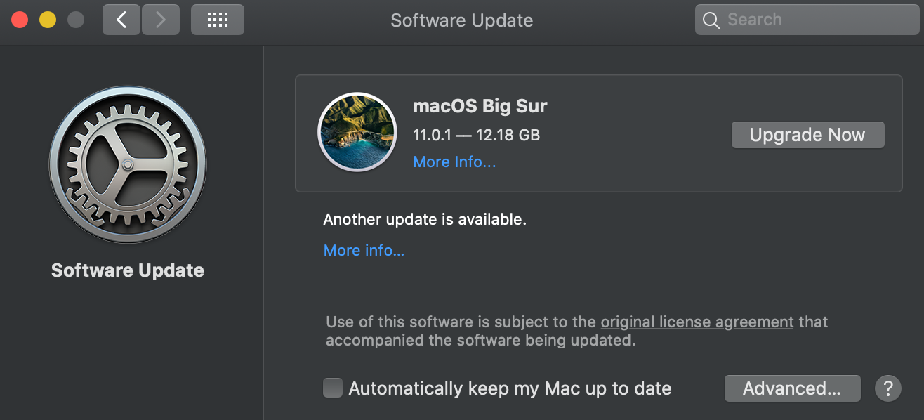

Did anyone else get the option to install Big Sur without VMM mask on? It just popped up in my system settings.
same here.. should we update? anyone knows whats broken? I currently have nightshift enabled, and hardware acceleration with with opencore 0.61 on catalina 10.5.7 would love to upgrade
