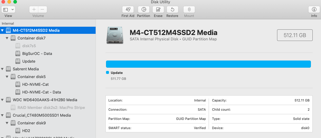

Hello again. It's all right :). I did the clean install via Mojave on a second HD that I have. In the first tests I did here, Metal's performance dropped a lot. At least on Geekbench. I will do real tests of use.

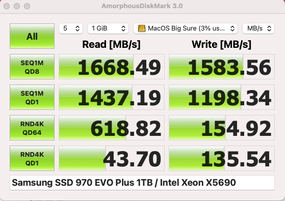

Single core performance is poor on both systems. Is yours also that low ?? It's smaller than an i3 :-(
Very interesting.. I'm seeing the same poor graphics benchmark.. Just tested with fresh installs of both OSs...
MacPro 5,1
Dual Xeon X5690 3.5 GHz
96 GB Ram
RX 580
OC 0.63
10.15.7 GB5 First Pass:
Single Core = 629
Multi Core = 6783
CL = 45357
Metal = 49440
11.0.1 GB5 First Pass:
Single Core = 629
Multi Core = 6816
CL = 31201
Metal = 32163
H.264 and HEVC HW accelerator are working

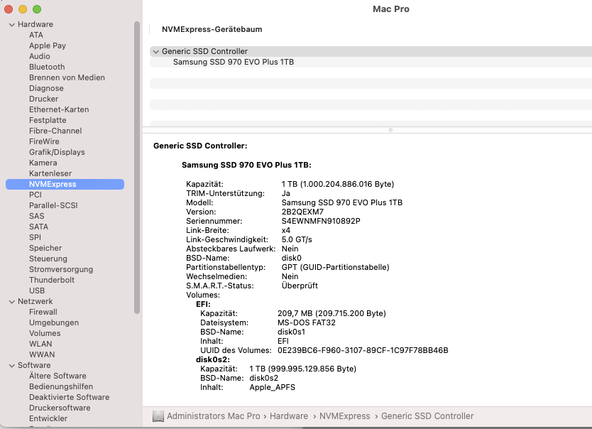

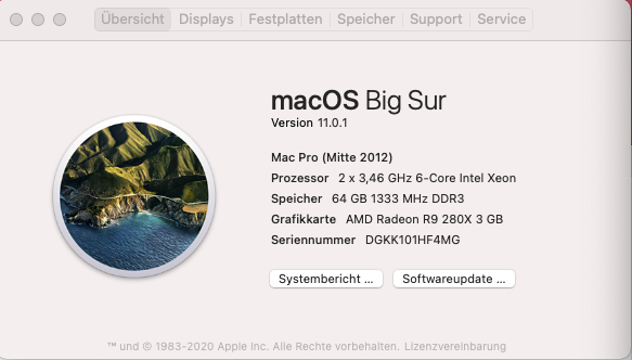

Many thanks for the your help. Running my MacPro (Mid 2012) with Big Sur.
What to Do:
- update Graphic Card to a RX580 or Vega 56 (have both cards)
- Replace dump NVME Adapter with an LyCom DT-130 (ordered)
- Replacing 8x 8 GB Ram with 6x 16GB Ram
- Fine tuning OpenCore
Dieter

hi folks managed to get BS/OC on cmp 5,1 internal SSD clean install from Catalina on another HD. `It booted into it BUT no wifi. I've the original Wifi in 2012 5,1.
Anything I can do here?
Update 1
using ethernet for now...booted back into Big Sur and it's slow and unresponsive this time.... not sure why.... maybe something to do with network connection. Nothing is blasting Activity Monitor CPU or disk that I can see.
Installed Kext:
AppleMCEReportDissbaler.kext
Lilu.kext
RadeonBoost.kext
WhateverGreen.kext
Update 2
This is odd. Booted back into Catalina and the Volume with Big Sur / OC has disappeared, instead there's a new volume called "Update"!?
Cheers
