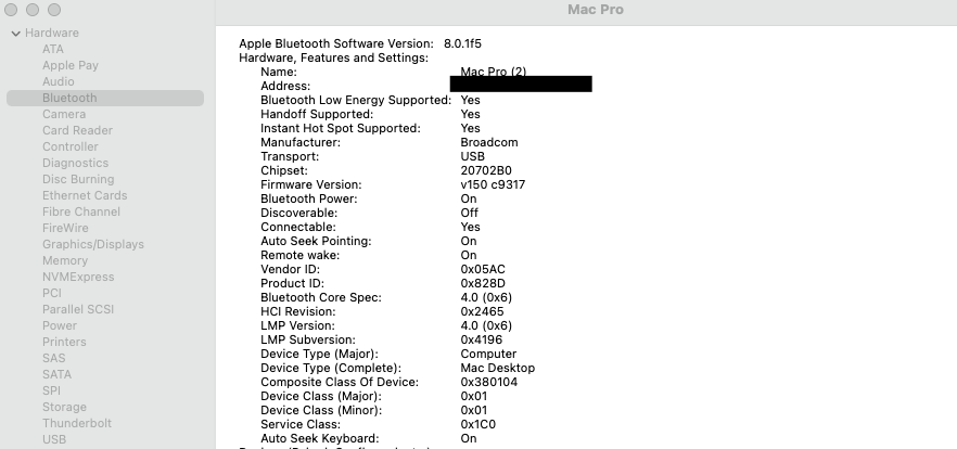

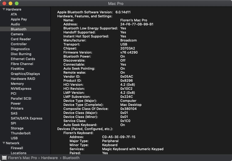

Here are some BigSur screen shots for comparison if it helps. WiFi/BT4.0 card and on the WiFi page the card is using the AirportDriverBrcmNIC.kext which is a plugin of the IO80211Family.kext which resides in SLE for BigSur. There is no AirPortBrcm4360.kext but the card does not need to use it. In fact if I remember correctly the card was using BrcmNIC.kext in Catalina as well. This may be a reason why it seems to work for me.
