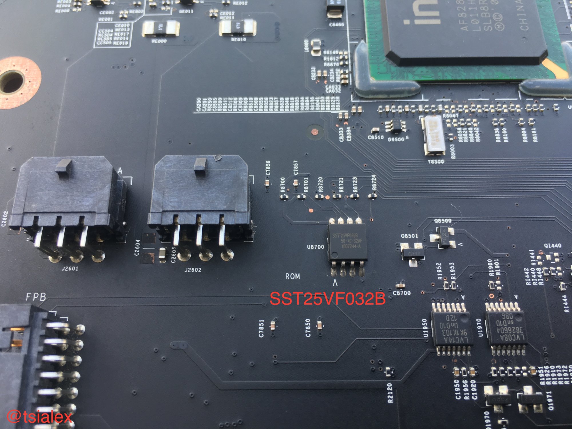

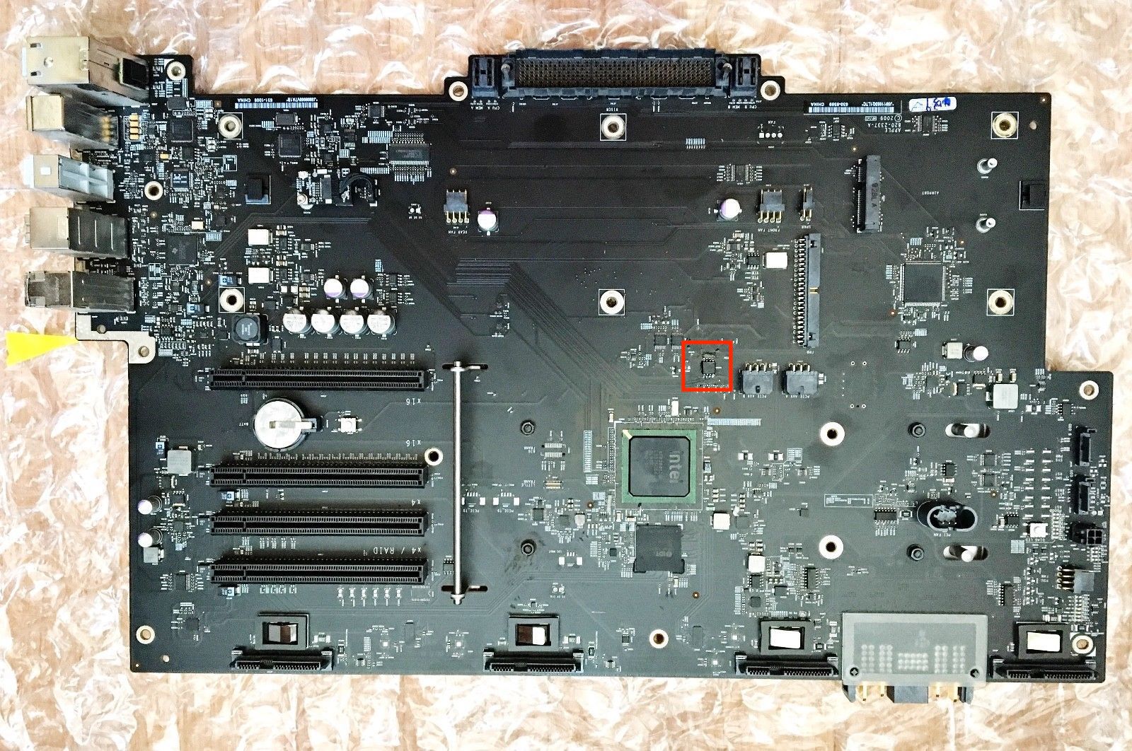

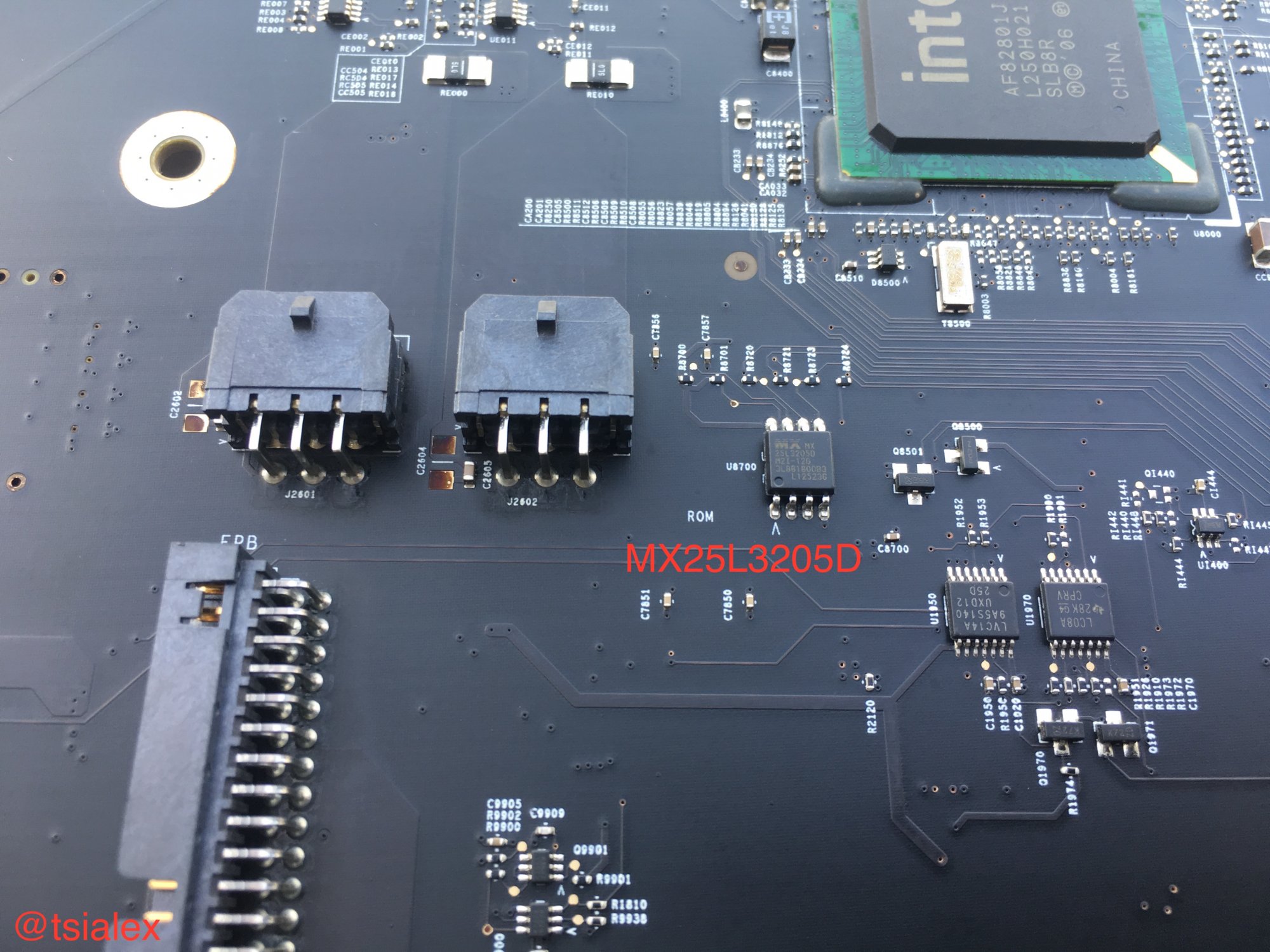

I’m trying to backup my efi eith RomTool but it’s asking me to confirm which of three EEPROM id’s is the correct one. Where can I find that info to confirm? I’m not sure where that actual chip is inside the case to see if it’s labeled there
This is the type of question that is one search away…
If ROMTool asks you to confirm what is the model of your SPI flash, it's the 8-pin SOIC flash memory next to the PCIe AUX-B power connector, label U8700 - see the photos. The model of the SPI flash memory is usually related to the model year:
  • with 2009 almost every backplane has SST25VF032B,
  • with 2010 usually is MXIC MX25L3205D, sometimes can be MXIC MX25L3206E, very rarely is SST25VF032B,
  • with 2012 usually is MXIC MX25L3206E, sometimes can be MXIC MX25L3205D.
  • If ROMTool don’t ask you the SPI model at all, Apple used a SST25VF032B.

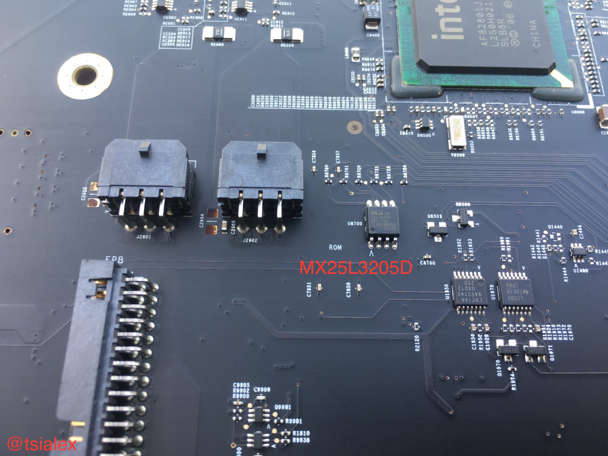

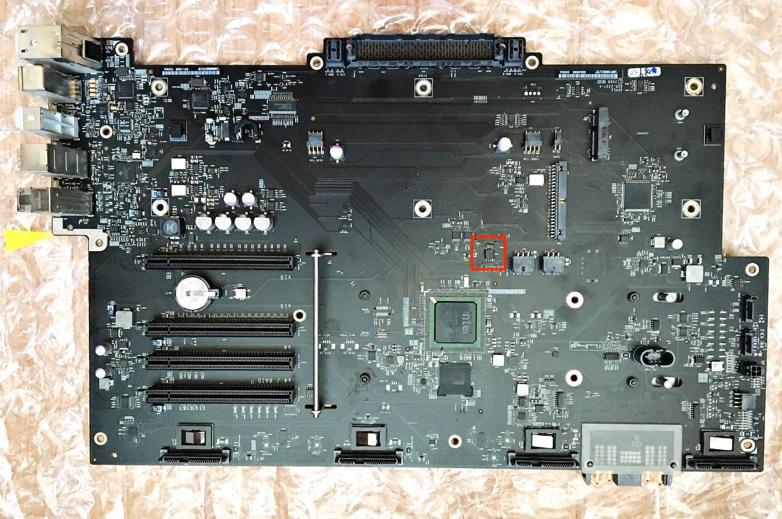

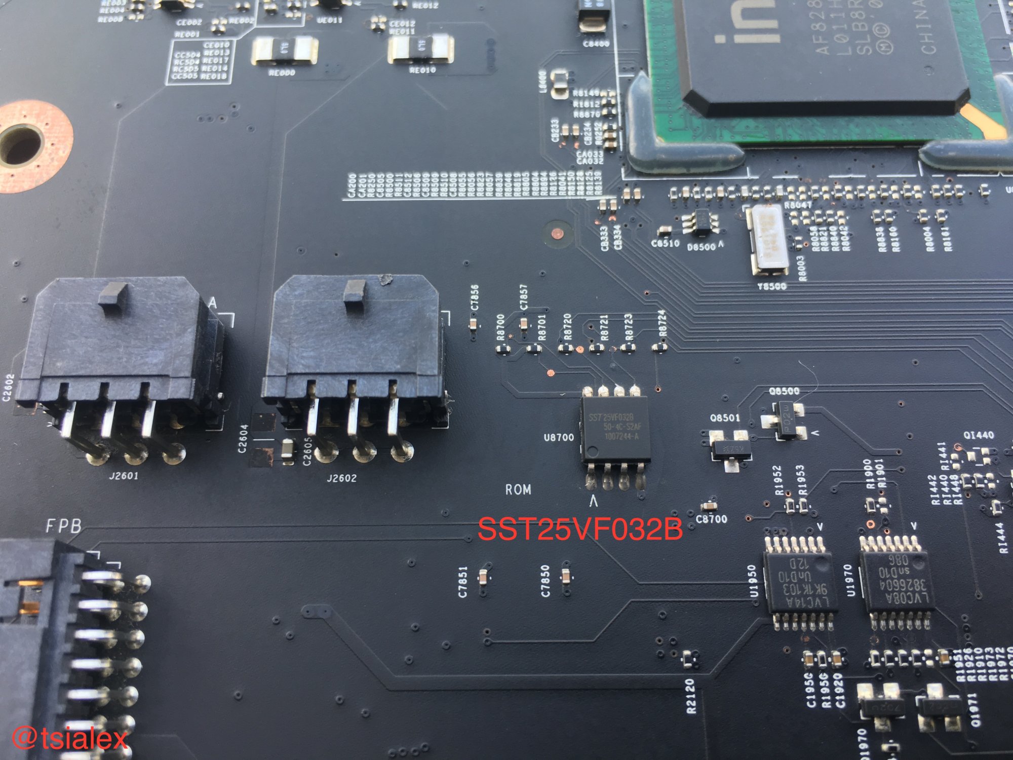

@tsialex I did NVRAM reset (3 chimes) and after 2 reboots the Bluetooth came back. Do I still need to dump the BootROM?
I have no idea what happened, I did not added the ProcessorType. @h9826790 @cdf where do I see the SMBIOS ProcessorType value in my Mac?
Since you got the BT back, you don't need to do it immediately, but you probably already have a fragmented/pre-corrupted NVRAM volume. Keep in mind that you will need to investigate this sooner than later. You can PM me your dump and I'll scan it with my diagnose tools.
This is a problem that every MP5,1 owner already have, or will have in the near future, the only solution is to flash a clean BootROM image from time to time. Btw, it's much worse for early 2009 Mac Pros cross-flashed with MacEFIROM tool.
I tried to send you a PM but you do not accept private conversations. I searched in your wiki thread as well Google and I could not find the procedure to dump the BootROM.
Download dosdude's ROMTool here (archive password is in zippasswords.txt), run, "Dump System ROM".
@tsialex May I kindly ask to send you my ROM as well for the analysis and repair? Please send a DM with the details, I'll gladly pay for this, as my Mac Pro is already showing lots of symptoms of corrupted ROM.
tsialex - I would appreciate your analysis of my ROM as well. Please let me know if that would be possible. Regards.
