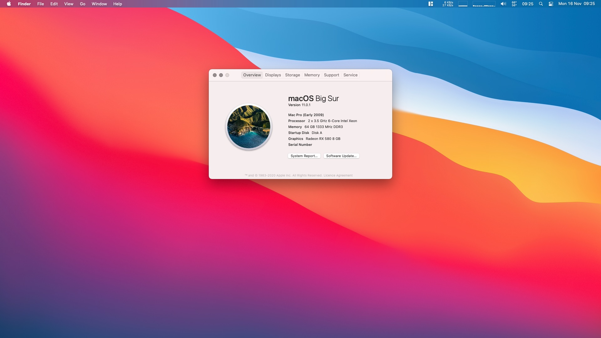

I'd like to thank @cdf for his awfully helpful guide, @TECK for his python plist generator and @h9826790 for all the help provided! I was able to install Big Sur this morning up from Catalina, and upgraded OpenCore from 0.5.9 to 0.6.3 all very easily. Thank you everyone here, for getting even more juice out of these machines! 😁

That says it can only ignore eligible UPDATES from what I see ... is the Big Sur UPDATE eligible for being ignored on Catalina?
Not sure where machines come in.
The message is saying that I am not eligible for BigSur, therefore I can't ignore it...even though its not being ignored. I'm guessing this is because I have the so called "hybrid" machine id as described in forum post #1
You are interpreting it that way but that is not what it says.
It says Software Update can only ignore updates that are eligible for installation
Software Update is a program/utility on your machine. It is the Software Update utility that has this restriction. If you roll back a few versions of Software Update, it will work fine but this means undoing some security updates.
Restrictions on ignoring major updates were introduced into Software Update in one of the recent security updates. That's what is probably behind your issue. I believe there is a way to delay things but that the ability to completely ignore was removed. (Always read the notes that go with the security updates. Can't recollect the details for Catalina as I use Mojave)
Check online for workaround.

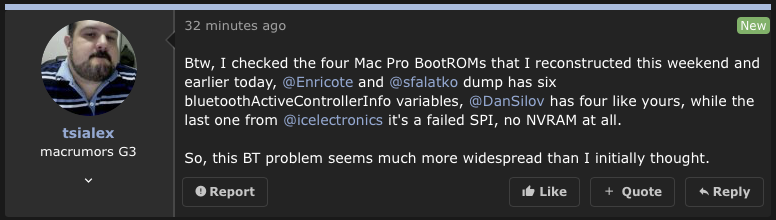

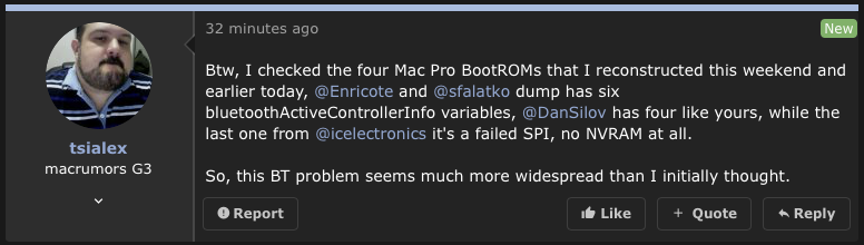

I had similar experiences, except I'm losing Bluetooth on random reboots. I'm using the @cdf setup with my plistlib generator, @tsialex showed me where are the issues and I hired him to rebuild my ROM, so I can flash it clean and fix all problems. I have a feeling you are in the same boat.
Edit: @tsialex noted the Bluetooth looks like is being a widespread issue.
Hello,
So the Bluetooth that comes with the 4,1 is a hit or miss thing?
Can someone please add the fix to the main post?
Thanks!
Is a BootROM fix in cMP, not related to OC. Basically, you need to know what you are doing or be a firmware engineer or an Apple technician to fix it. That is why I hired @tsialex to build me a clean ROM. From what I read, the ROM gets corrupted in time and the only solution is to re-flash a clean ROM.
