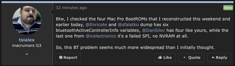

I had similar experiences, except I'm losing Bluetooth on random reboots. I'm using the @cdf setup with my plistlib generator, @tsialex showed me where are the issues and I hired him to rebuild my ROM, so I can flash it clean and fix all problems. I have a feeling you are in the same boat.
Edit: @tsialex noted the Bluetooth looks like is being a widespread issue.

The configuration problem is exclusive for BT, and don't happen for Wi-Fi.
Differently from Bluetooth controllers, where your Mac Pro firmware have to initialise and configure it very early at the pre-boot time, or you won't have KB/mouse support, AirPort Extreme don't have hardware configuration inside the NVRAM, just credentials.

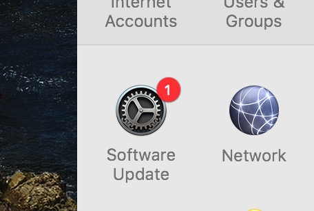

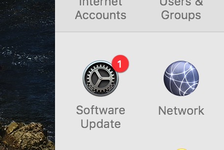

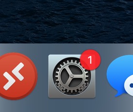

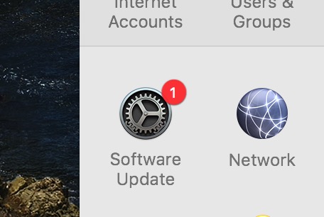

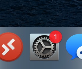

They are removing the ability to ignore updates in Big Sur, it is supposedly just a warning in Catalina, but people can still do it...IF...their machine is eligible, which mine is apparently not.
So again... how can I remove that notification from my OC Catalina MP5,1? It appears to not be possible unless there is some OC hackery around it.
I have installed Catalina on OpenCore using CDF's instructions. Nothing else changed, exactly like his instructions. And it works fine. Except that the System Preferences Software Update module shows a big red badge on it that I need to update it...and opening it up, it shows that I need to update too BigSur..which I do not want to do. I do not know how to make that go away so that I don't have to look at it.
This shows up regardless of whether I have VMM enabled or disabled.
I google around and found the command line trick (see my earlier post)..which is supposed to tell software update to ignore that particular update..the BigSur one...however that command line trick doesn't work, it complains that my machine is not eligible...and there is some dispute here apparently about the exact meaning of that message, but regardless...it doesn't work..I cannot tell software update to ignore BigSur. Presumably if I had a newer mac...I would be able to...but with this OC MP5,1...no I can not tell software update to ignore BigSur.
Do you know a workaround?

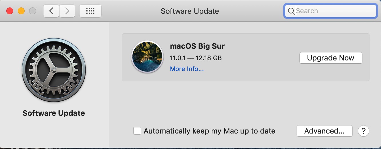

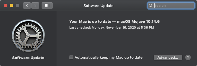

You mean this? (screen from my Mojave disk)
When you turn off VMM, it will stop the Catalina updates, but not Big Sur. To our big surprise, people started getting Big Sur update notifications, even when they had VMM off. So that is what we have on hand, for now.
Just curious, why do you not want to upgrade to Big Sur? In order to upgrade, you will need to apply the changes described in post #4,399 to your existing config.plist.
From my perspective, I use OC because I always want the latest OS with latest fixes. Before I used to use dosdude1 releases which did not offered updates.

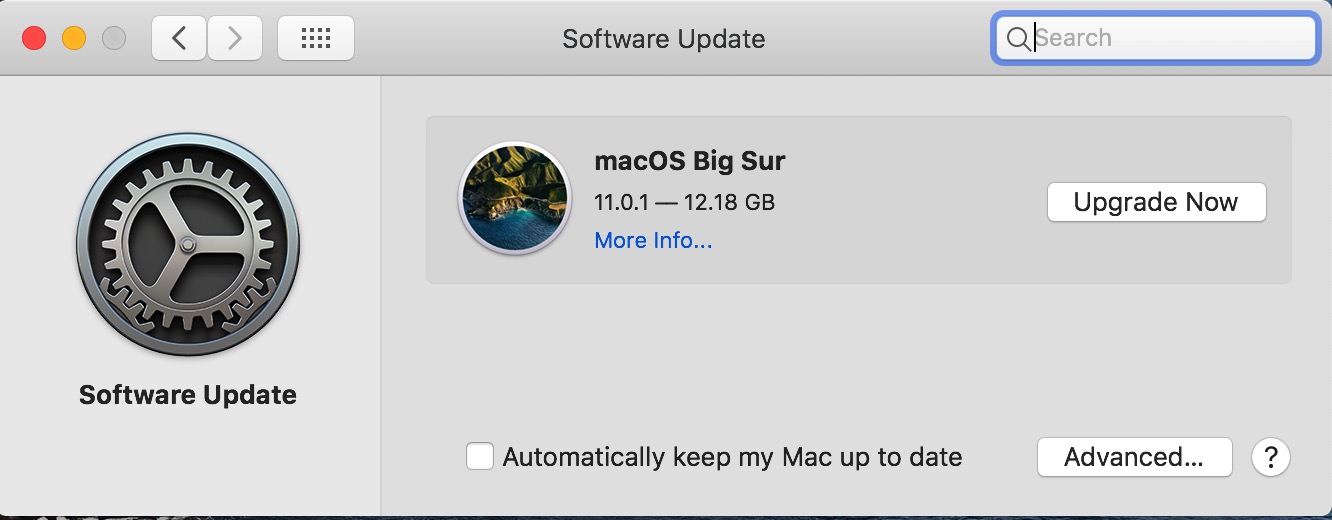

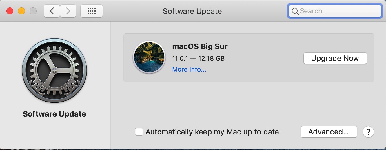

This is what I see now:
I understand that much. I more or less thought even with VMM off, it doesn't block the notifications about Catalina updates, but if you try actually run the update, it will fail.
, but not Big Sur.
Well certainly its displaying the notification. I suspect that if I enable VMM, then I could theoretically run the BigSur updater and it would work. With VMM off, the notification is still displayed and running the updater would fail.
Right, which is why I was looking for a way to disable the notification. The above command line trick is what most people normally do, but in my case, it doesn't work, it complains about eligibility.
The irony is that with VMM disabled:
  1. I can't run BigSur update (check)
  2. I still see the notification
  3. I can't run the command line tool to ignore the notification because machine not eligible to run it, so therefore it assumes I'm not eligible to ignore the notification either.
I already tried to enable VMM and try the command line trick, but same complaint...so VMM trick doesn't work to fake the software updater into ignoring BigSur notification.
Regarding your question about why not Big Sur....baby steps. I may get there eventually. I waited to go to Catalina until now for a reason, stability. I'm still not even 100% sure I will stick with this configuration, I'm just trying it out. It will be at least 6 months before I will consider moving this machine to BigSur...for a lot of reasons...not just whether or not OC can do it. I use a lot of audio software and stuff that as of now is not even compatible on BigSur and we are told by dozens of software makers to wait, as of now.
View attachment 1670037View attachment 1670038View attachment 1670039
