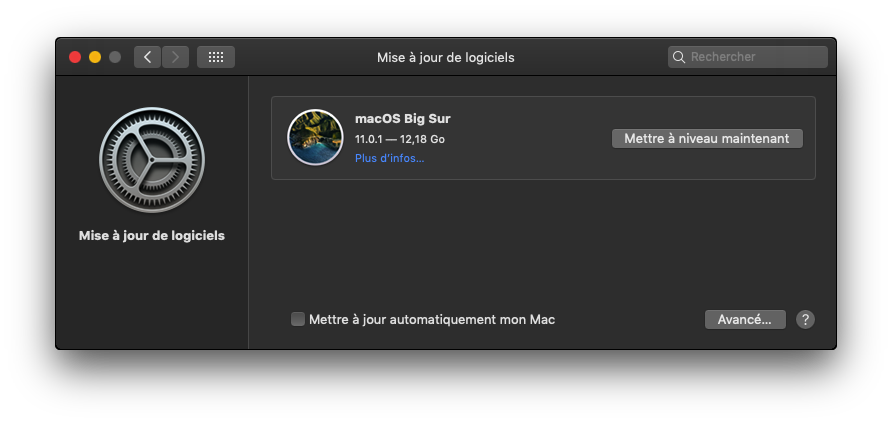

Yes, I followed post #1 exactly, including advanced config. Nothing else.
There is a thread here:
Which is for Catalina, but you can adapt the commands for Big Sur, but honestly this is not related to OC and may need a topic on its own.

You are really confusing me now. I already did check online for workarounds, which is what I tried to do that doesn't work.
Do you know another work around that will work with OpenCore MP5,1 running Catalina?
That's what I'm trying to tell you.
Telling Software Updates to ignore an update is not a workaround but a standard feature. This feature was removed in the Catalina 10.15.5 update. To get it back, you need to roll back your installation to one before you installed the update that removed this capability from Software Update which is not really a viable option.
What I have done on my Mojave installation is that before installing the equivalent security update, I saved the Software Update Utility. Then after installing the security update, I put the old version of the Software Update Utility back in and been repeating the procedure for every update since then.
I now ignore both Big Sur and Catalina.
Read more here: https://www.macrumors.com/2020/05/28/macos-ignore-software-updates/
They are removing the ability to ignore updates in Big Sur, it is supposedly just a warning in Catalina, but people can still do it...IF...their machine is eligible, which mine is apparently not.
It is not related to your machine but to the version of Catalina you have in place as explained. Once you went past Catalina 10.5.4, this capability was disabled.
So again... how can I remove that notification from my OC Catalina MP5,1? It appears to not be possible unless there is some OC hackery around it.
Not OpenCore related obviously and if you do not have the old Software Update Utility (before it was amended) saved somewhere, you can no longer ignore such major updates. You might be able to grab a copy from time machine.
I followed this process at the time: https://forums.macrumors.com/posts/28519784. Maybe best to post in that thread.
The updater also just popped up a notification that I need to update GarageBand...but when I open up App Store, it says I can't update it because its only for BigSur,.
So clearly there is something broken about this OpenCore configuration with regards to Software update.
I am not sure what you mean about Catalina version, this is my first try at installing Catalina at all, I went directly to 10.15.7, using OpenCore as described in post#1.
Rolling back to older Catalina is not an option.
Are you saying that all Mac users everywhere....running Catalina...with or without OC...are having these same problems...notifications about Big Sur that won't go away and also notifications to update to apps that can't be installed without Big Sur first? if so that is really lame on Apple's part...
I am lost as to how to restate that this has nothing to do with OpenCore or your machine but the version of Catalina that you are running. It doesn't matter whether you installed Catalina natively, via OpenCore, via DosDude patch, or by any other means.
You have v10.15.7 and I told you that the capability to ignore major updates was removed as from v10.15.5 onward and provided a link for you to read on this as well as how this issue can be bypassed if desired.
As mentioned, this subject is off-topic on an OpenCore thread and best to either start a new thread or post to a thread dealing with the subject such as the example I posted.

peace Dayo, you're being way too aggressive man. I'm just ask questions... I just installed OC for the first time, so I started here. No need to get so angry and rude. The garage band thing seems more suspect to me...as I should not be getting any notification about apps that need to be updated for BigSur when I am actually running Catalina. Again, if that turns out to be a general problem for all Catalina users, than I will find that out now that you have yelled at me to go away, I will go find out. Peace man.
The thing with Garageband has nothing to do with OpenCore either. I still have Catalina on my 16" MBP and was just offered an update to Garageband that won't install because I'm not on Big Sur.
In fairness to Dayo, I don't think he was being angry or rude--I think he was just getting frustrated that you weren't understanding what he was saying after multiple posts. Remember that you asked for help and he was spending time trying to help you.
Reactions: paalb and naerct
and likewise I didn't feel like he was understanding me
Yes but in this instance the burden is on you because you're the one who asked for help. As they say, "beggars can't be choosers". Understand that even if you didn't like his tone, he was attempting to help you understand and solve your problem.
Reactions: naerct
Sorry ... I raised my voice as it seemed you weren't hearing me despite repeating the same thing a number of times. Particularly after taking time to search the forum to give you info which your "Clearly, there is something wrong with ..." response indicated you hadn't read.
Anyway, summary is that the feature was disabled in 10.15.5 and you are on 10.15.7. You need to either live with it as Apple wants or hack your installation as I described. Ultimately not OpenCore related and best discussed in a relevant thread if desired.
