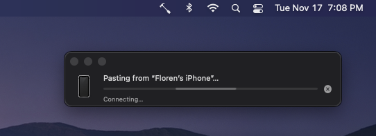

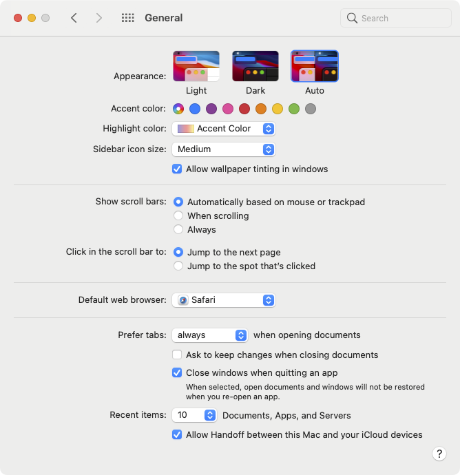

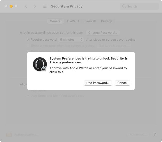

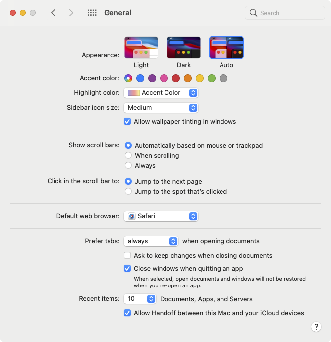

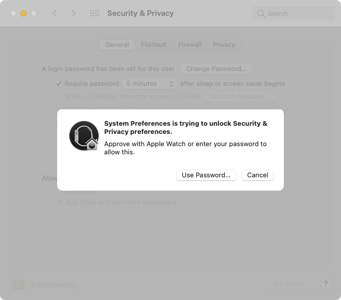

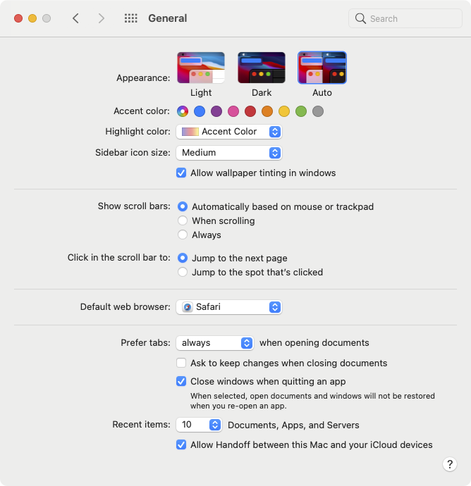

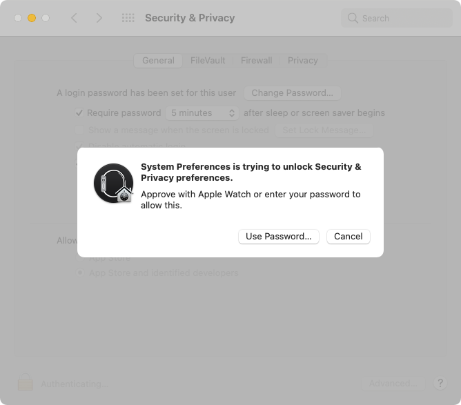

@tsialex I was having trouble with the Handoff, the fix was quite easy. All I had to do is iCloud logoff on both iPhone and Mac, then login. Now handoff works, as well Apple Watch authentication from sleep or screen saver or lock unlock. So far everything is finally proper, Bluetooth working smooth with no lag in Big Sur.

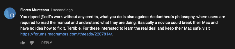

Edit: never mind, I thought you already run OpenCore. I just watched the video and these clowns copied @cdf work without any credit! I added a comment:
From your current Catalina setup, all you have to do is set VMM to off and add the @cdf fix explained in post #4,399. Then you can upgrade directly.

What they show you is plain wrong. Say you follow their guide which basically skips a lot of important steps for users to understand (by creating a custom package). If things break, who is going to help you, these clowns? And what if your Mac has different components, or you want to upgrade the packages? Terrible idea to use their dumb setup.
What you need to do is read first post and follow it, is detailed in a way that even a baby can understand it, if you take the time to read. At least here you have a group of people who can help you fix the problem, but nobody will spoon feed, as the @cdf guide is very well written.
