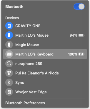

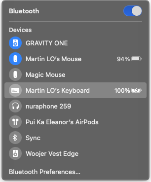

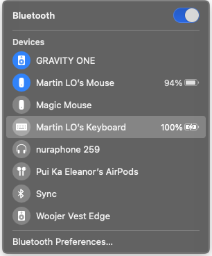

For Magic Mouse, that’s for charging only.
But for keyboard, that can become a wired keyboard. In fact, when you connected the keyboard via the Lightning cable. The keyboard shows inactive in the BT panel.
Until you disconenct the Lightning cable, MacOS will show you the OSD that Magic keyboard connected via BT again.
Or you can even completely switch off BT, but connect the keyboard via the Lightning cable, and it still works. Magic mouse doesn't have the same behaviour.

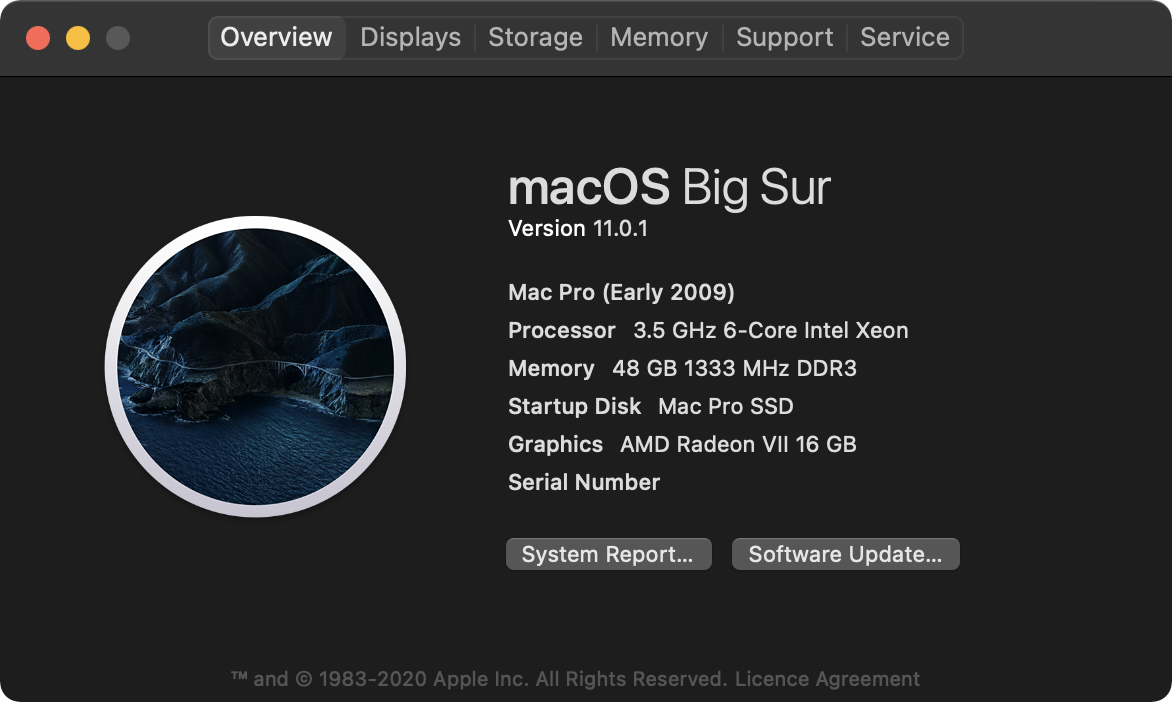

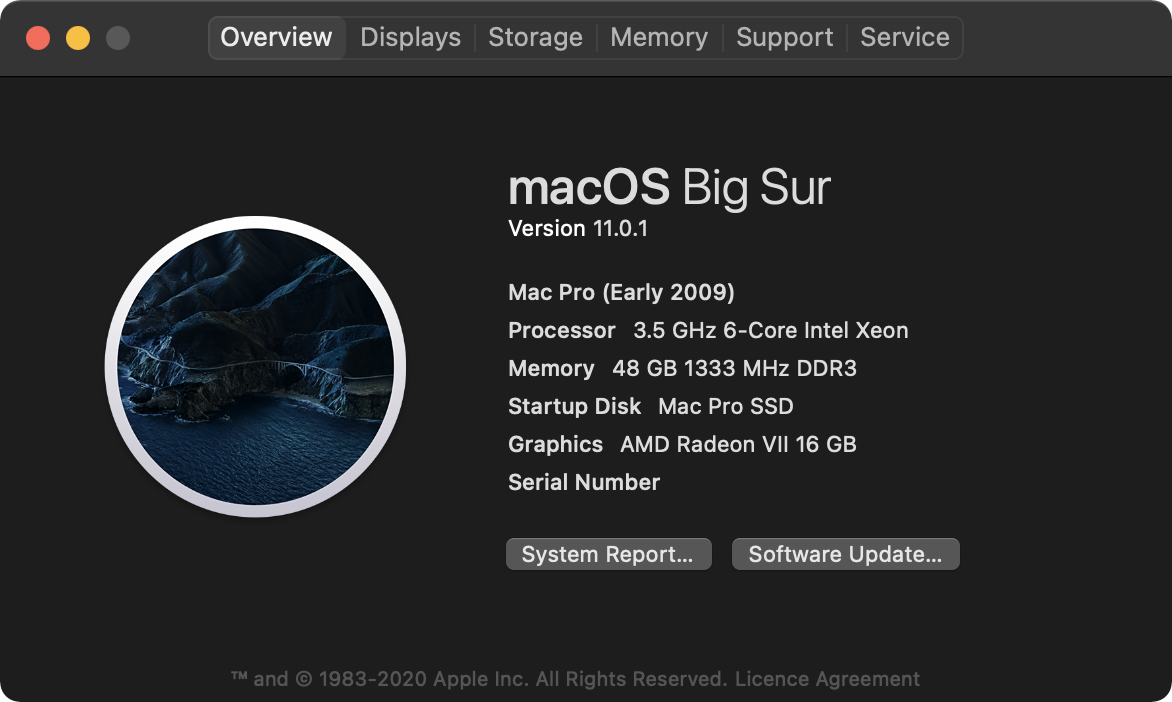

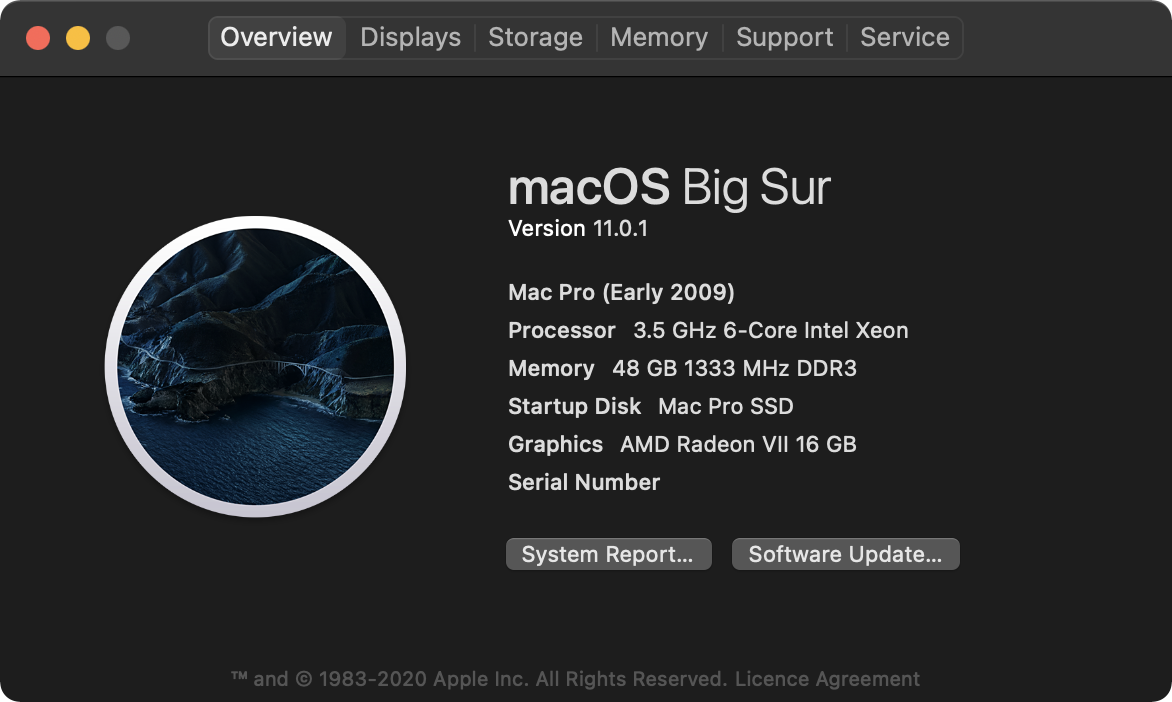

From memory, no report about Nano yet, but I believe only RX460 or above can provide HWAccel in MacOS.
Anyway, from your screen capture, the code for HWAccel isn’t working yet. Otherwise, you should see 3.5GHz but not 3.46GHz for the CPU speed.
Would be a bummer if there's no support for it, as it's a better card than most any of the other options until you get to RX580 and above. And I already have 3 of them. :D
I'm not sure what else I need to do for the HWAccel support in regards to the CPU speed. Any advice? Want to look at my config.plist or something?
That's nothing about CPU speed, but if you inject the required board ID correctly to activate HWAccel. The About This Mac will be changed the CPU speed presentation from 3 digit to 2 digit.
Therefore, you should see 3.5GHz, but not 3.46GHz anymore.
