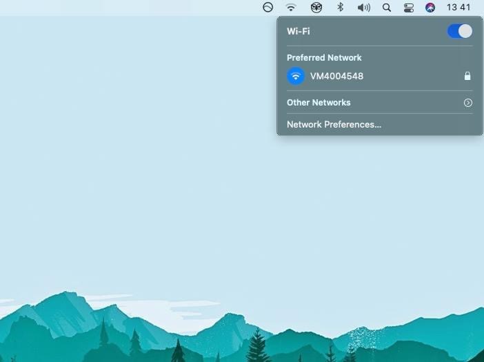

@GSXB @csxlab
here attached my config.plist and the patched kext to put in the OC/Kexts folder
Clearly pay attention if you think to use my config.plist... I think the best is to only use it about how to insert the strings into your one.
Thank you, I compared the two config .plist files and amended mine accordingly.
Hey presto WiFi
