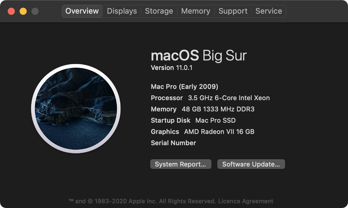

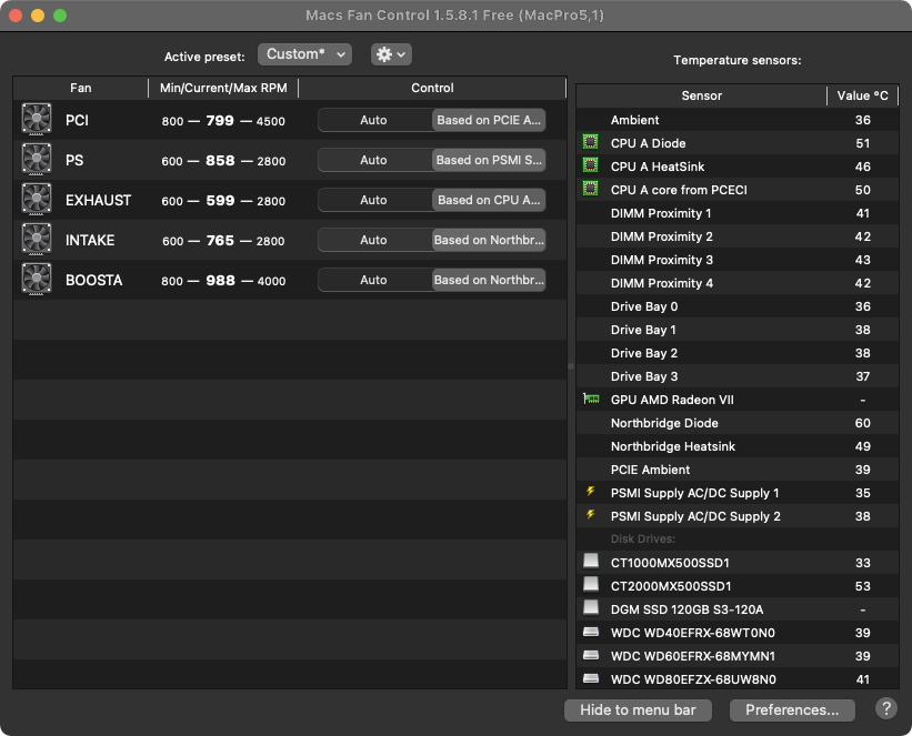

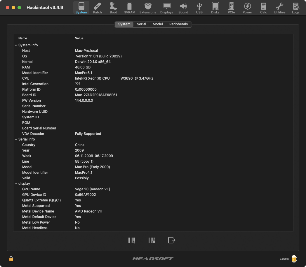

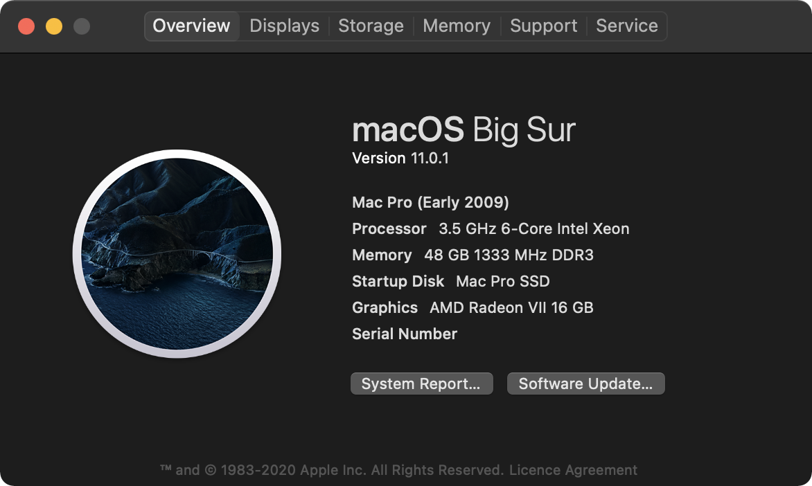

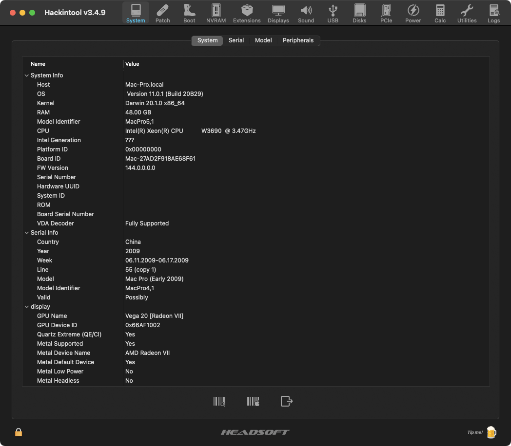

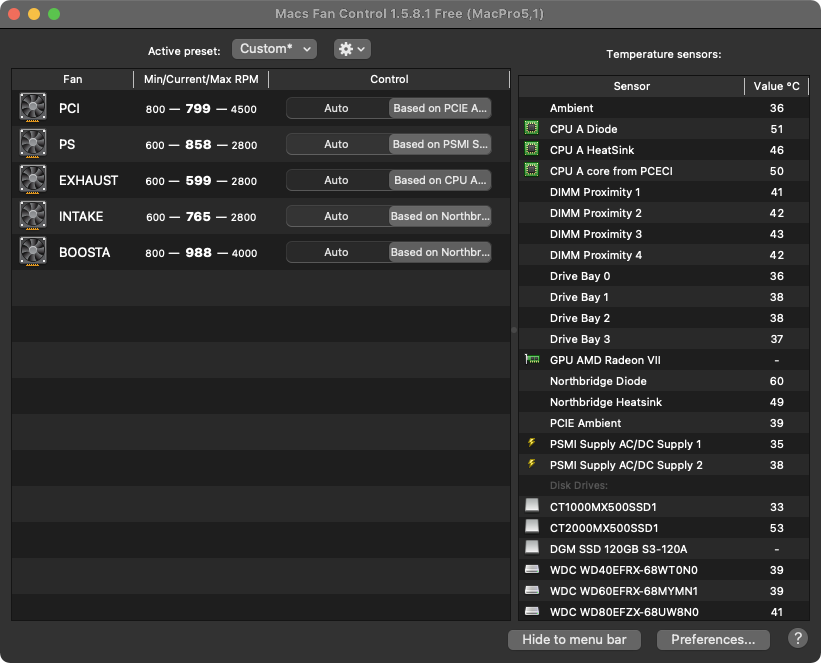

Shouldn't be, I am using the 7,1 board ID right now. That won't change the ident. And won't trigger the memory error notification in Big Sur. And all fans & temperature still works.

Did you spoof the ident by yourself as well?

When you spoof the ident as well, sensors and fans (and SMC) still working. Just some software (e.g. iStat) can't function correctly (because they base on the ident to look for some specific sensors value, not base on whatever available).
Anyway, the whole idea of spoofing the ident is to make the cMP ident as the 7,1. Therefore, About this Mac shows 7,1. And all functions availability also base on 7,1.
But if that cause other issues (e.g. network issue), then I also believe better to avoid this config. We can use F.lux to replace Night Shift, and Duet to replace Sidecar, etc.
