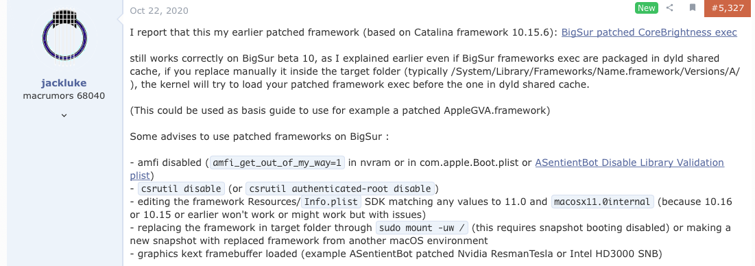

@jackluke Better temporary solution ( Before Lilu userspace patching is resolved ) would be to patch that custom CoreBrightness so it will not collide with system versions just like this

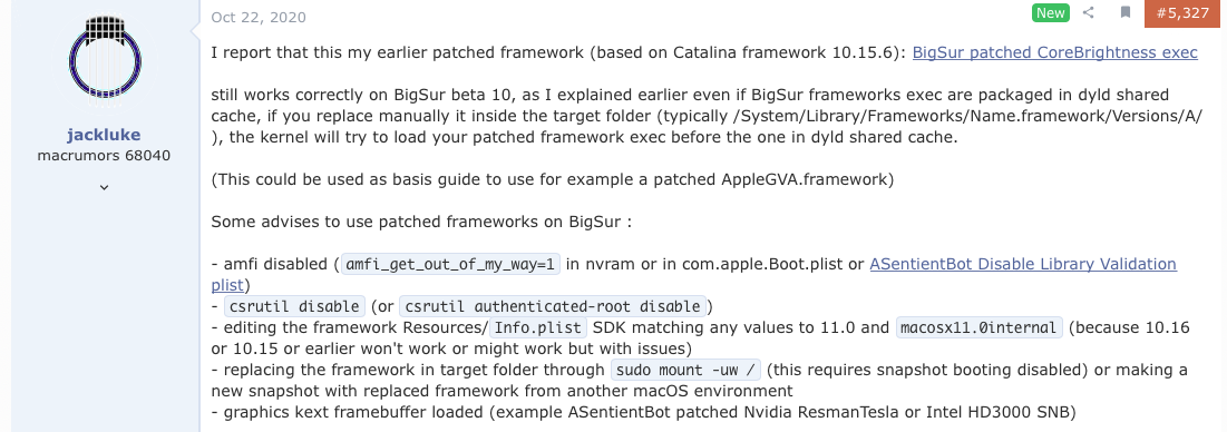

Through pikeralpha method I patched the CoreBrightness binary exec, but to use patched frameworks you need also to Disable Library Validation or AMFI disabled, that I already included in my BaseSystem fix.
I haven't tested if a framework exec can be used as kext exec through OpenCore, while for Extensions this works I guess for Frameworks won't work, framework loading from BigSur kernel is enough different from kernel extension.
My patched CoreBrightness doesn't collide because is installed only on BigSur (without opencore) and it's simply copied in this path /PrivateFrameworks/CoreBrightness.framework/Versions/A/CoreBrightness
(I used this for 11.0.1 https://github.com/jacklukem/BigSurfixes/blob/master/BigSur 19H2 patched CoreBrightness.zip)
on BigSur all the frameworks exec are embedded here: /System/Library/dyld/dyld_shared_cache_x86_64
so simply removing that CoreBrightness patched file the stock BigSur CoreBrightness is used that is embedded unmodified on that dyld shared cache.

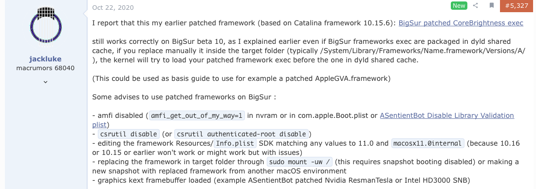

so simply removing that CoreBrightness patched file the stock BigSur CoreBrightness is used that is embedded unmodified on that dyld share cache.

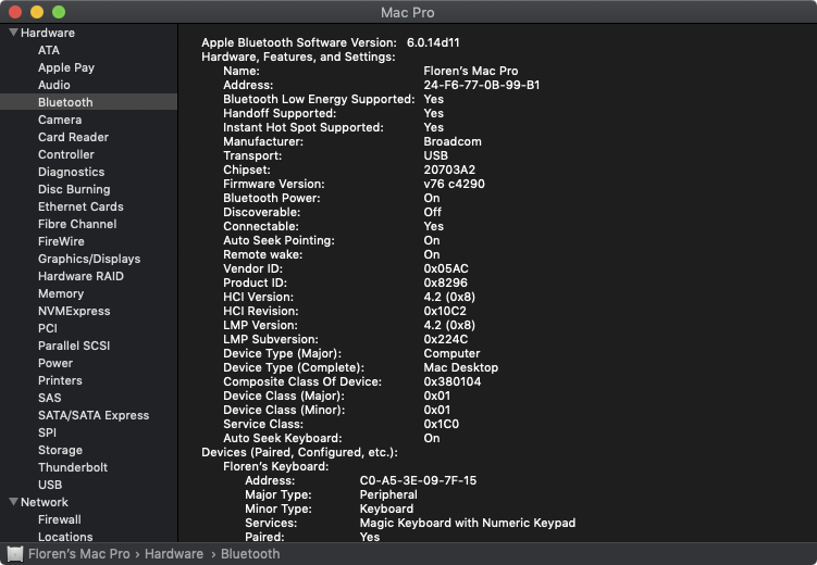

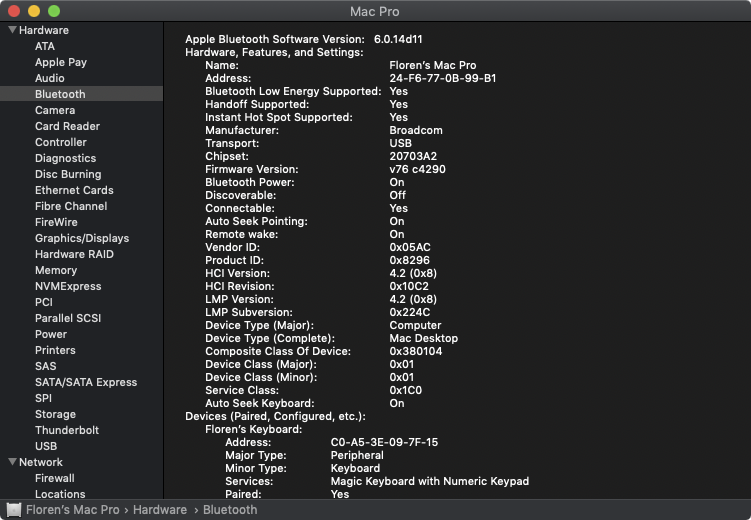

I upgraded the stock card to BCM943602CDPAX in order to get Bluetooth 4.2 and continuity, it was fine in Mojave/Catalina, now invisible in Big Sur. Here are my details in Mojave:
@startergo @h9826790 @cdf if you have any suggestions where it might be the issue, please let me know.

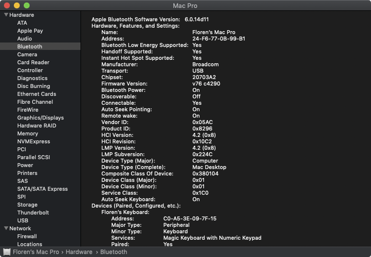

I had a very similar issue with my upgraded bluetooth from iMac17,1. It stopped working at some point and I installed this USB dongle to fix it.
Everything still works fine in Mojave and Windows, only in Big Sur is not recognized:
