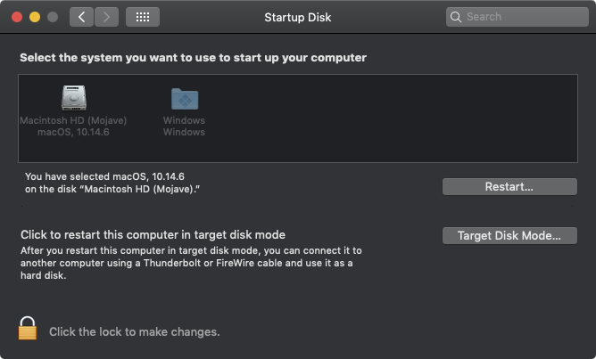

Since I have OpenCanopy off by default, I wanted to make sure I always boot into Mojave disk, so I checked is default into Preferences (Big Sur disk was already formatted at this point):

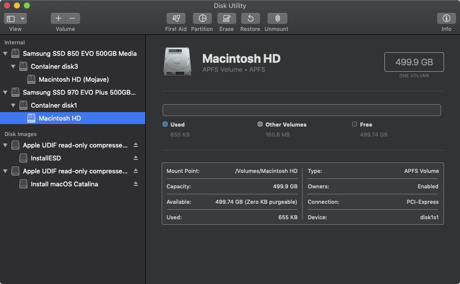

When I tried to format the OC disk (previously APFS) to same type APFS, it was failing. I had to format it with previous Journaled format to destroy the data, then I was able to format it back to APFS. Obviously OC files were gone, but I rebuild them in 2 seconds with the plistlib generator, here it is the Big Sur PR:

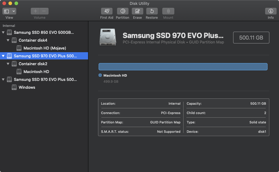

@cdf I will update this post, once I'm done with the clean install, for now I will experiment with the Windows disk in place:

Here are my clean install findings so far. If I format the OC disk (previously APFS) to same type APFS, it will fail.
I had BS beta installed and this is what I did:
Deleted the BS beta APFS container:
Code:
diskutil list
diskutil apfs deleteContainer diskXsY (as shown in the diskutil list)
Erase disk in Disk Utility (and rename to something meaningful)
Install BS on that disk.
Code:
diskutil list
I did something similar but via disk utility gui.. Big sur has 3 entries under it's container. Right click on each one and say delete APFS Volume. I then erased the container as hfs extended. Then erased the container as APFS.
This provided a fresh APFS container for fresh install.

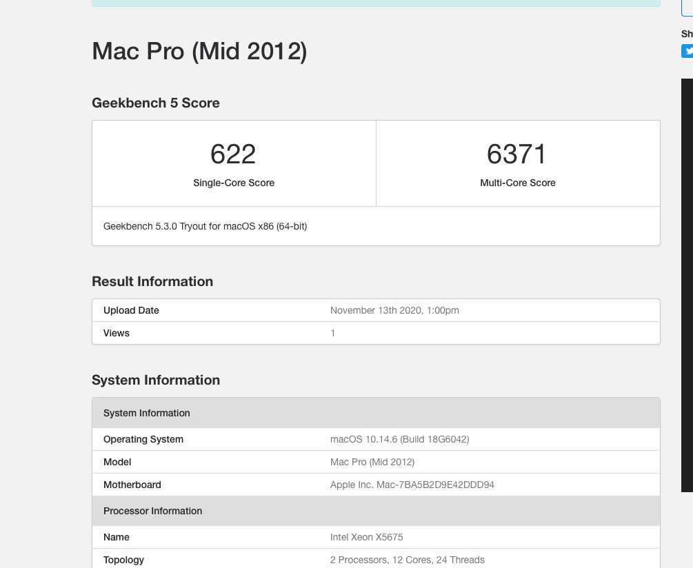

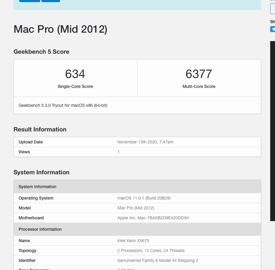

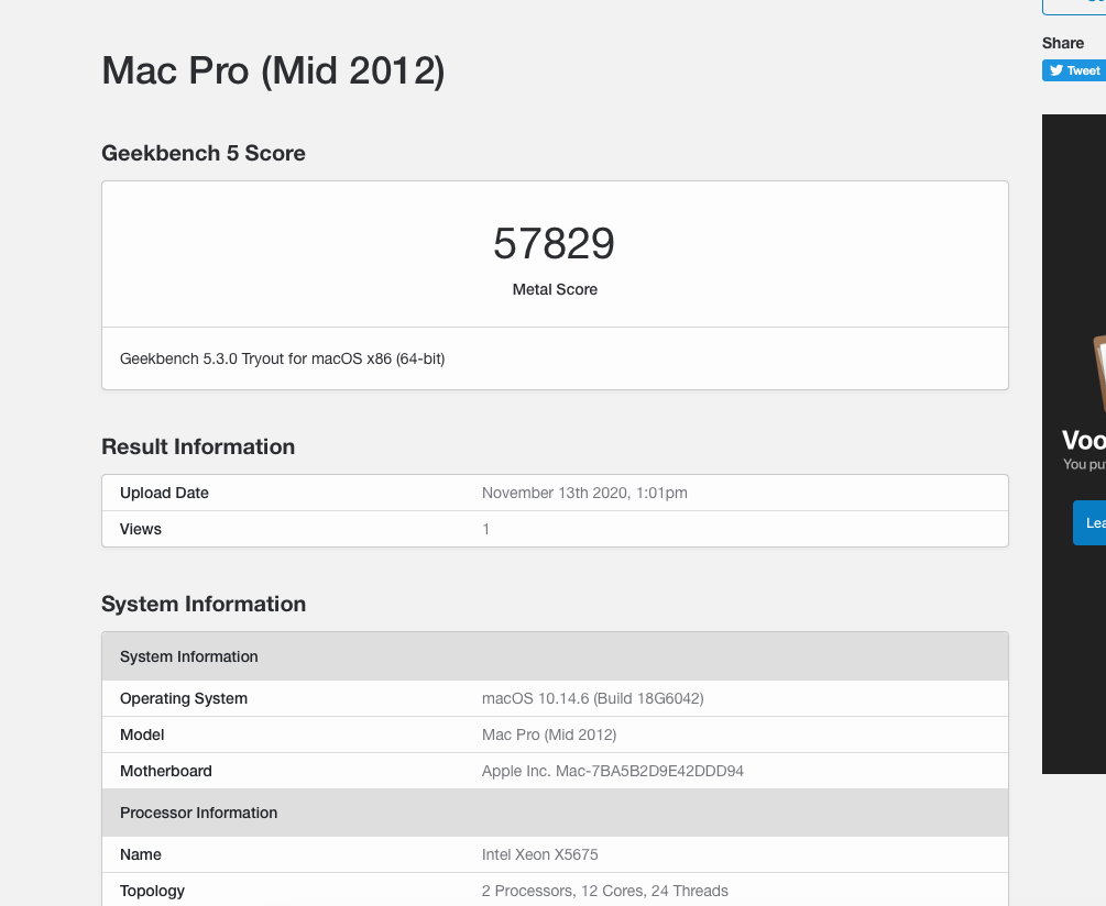

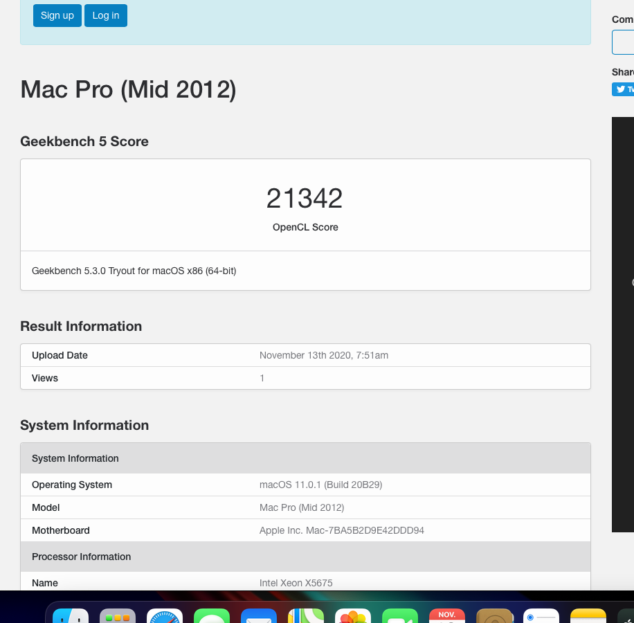

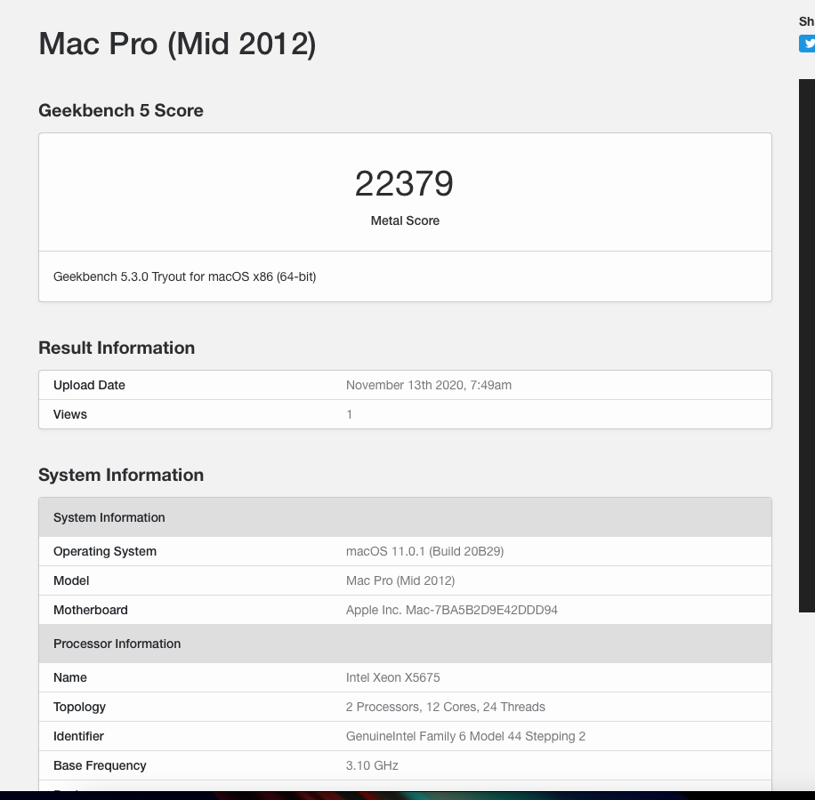

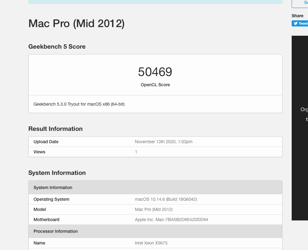

Hello again. It's all right 🙂. I did the clean install via Mojave on a second HD that I have. In the first tests I did here, Metal's performance dropped a lot. At least on Geekbench. I will do real tests of use.
Single core performance is poor on both systems. Is yours also that low ?? It's smaller than an i3 :-(

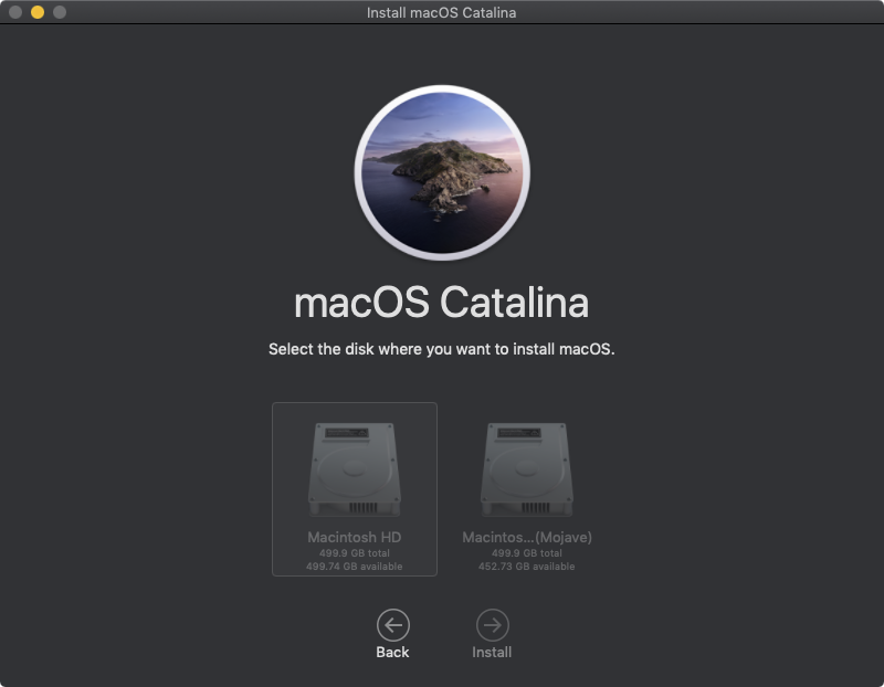

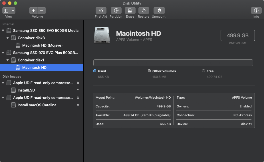

Hello!
Been an open core user for a bit, but I'm still learning a lot. I'm on version 0.6.3 and running a stock configuration except I made the firmware changes mentioned in #4399. So I ran the update to Big Sur everything went smooth until I booted up and I no longer can run my second display off of the display port from my Rx 580. Is there anyway to fix this? The only other thing that's not working for me is my USB Wifi adapter, but I'm assuming that's not Big Sur's fault right? If there isn't a fix, what's the easiest way to downgrade back to catalina? Will it require a clean install? Thanks so much for the help, I've learned a lot from the people on here.
I use @Dayo myOC.tool

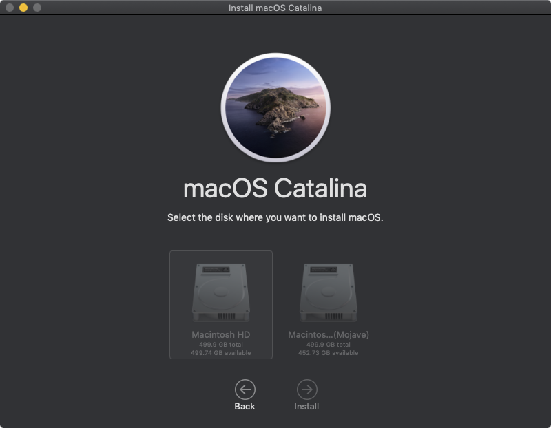

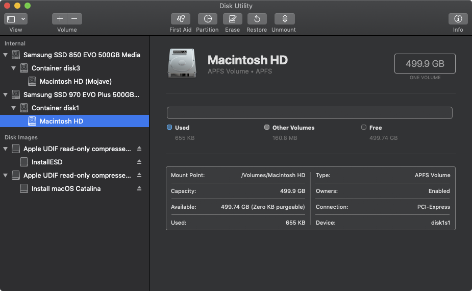

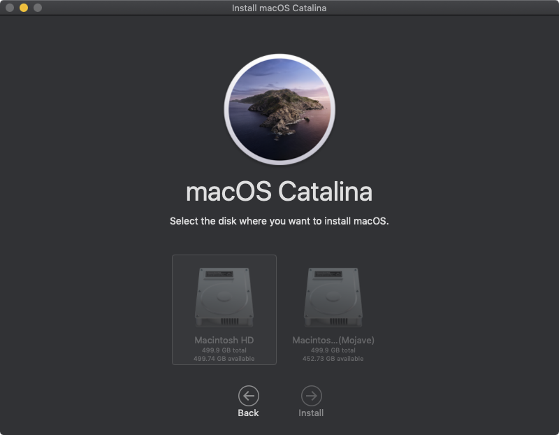

I’m going to reinstall Catalina and upgrade within, for now. I’ll wait for 0.6.4 release which should not be too far.
Edit: I cannot install Catalina, the disk is greyed out? VMM is Off.
Code:
$ diskutil list disk0
/dev/disk0 (internal):
   #:                       TYPE NAME                    SIZE       IDENTIFIER
   0:      GUID_partition_scheme                         500.1 GB   disk0
   1:                        EFI EFI                     209.7 MB   disk0s1
   2:                 Apple_APFS Container disk1         499.9 GB   disk0s2
Code:
I've been through this problem. I solved it when I removed the board-id from Imac Pro. And VMM on.

Change this code in your config.plist from
Code:
<key>Cpuid1Mask</key>
<data>AAAAAAAAAAAAAAAAAAAAAA==</data>
to
Code:
<data>AAAAAAAAAAAAAACAAAAAAA==</data>
Reboot and I believe the installer will work.
