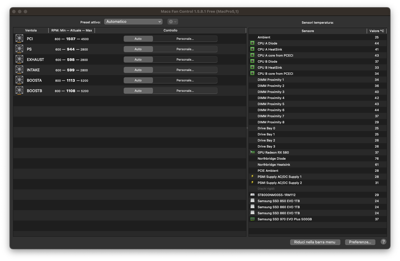

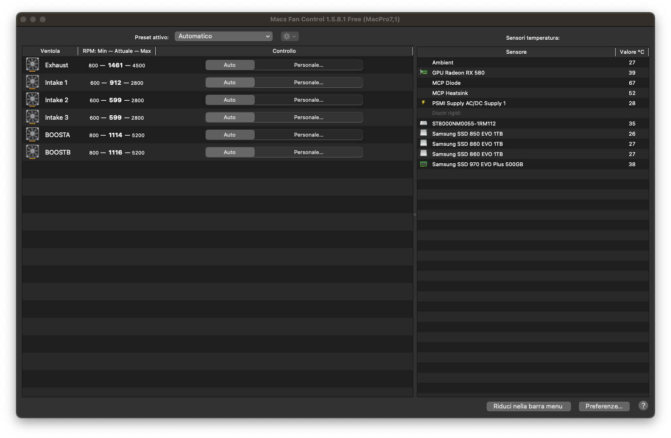

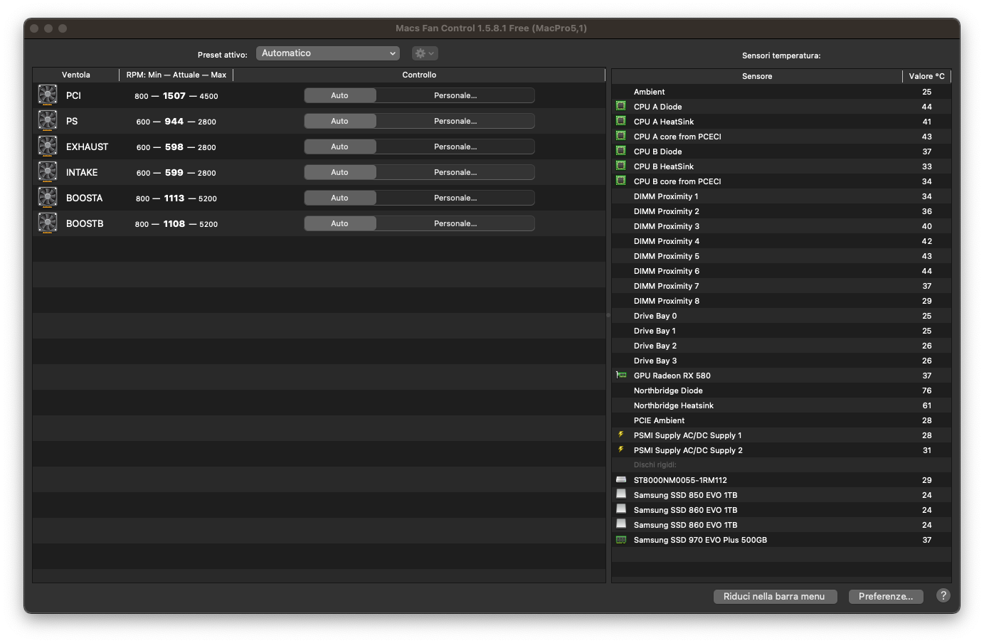

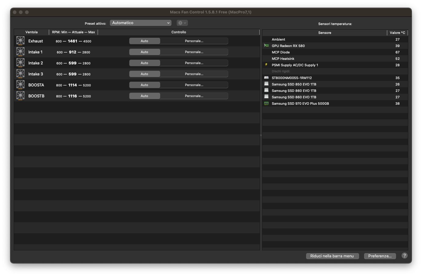

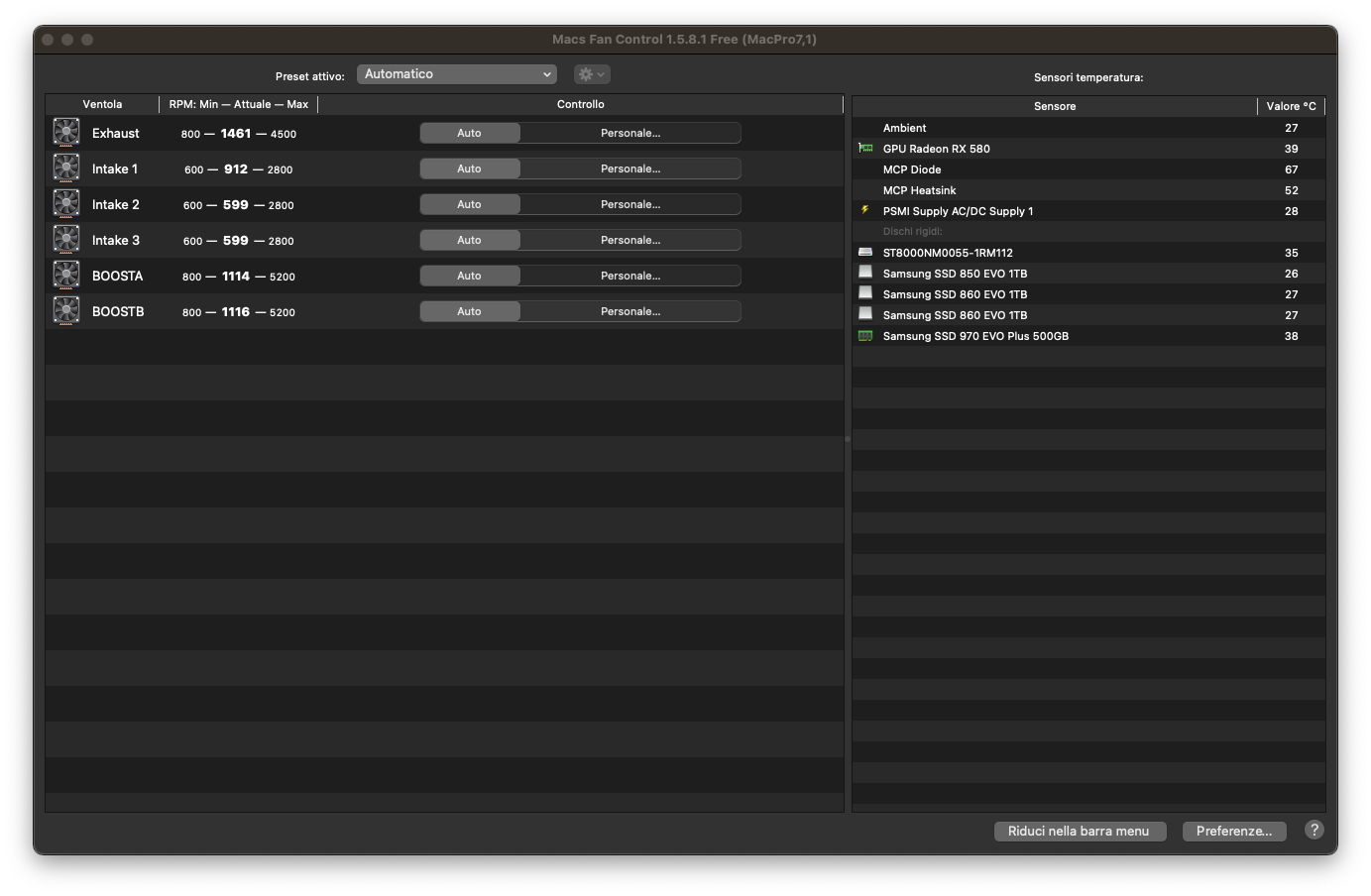

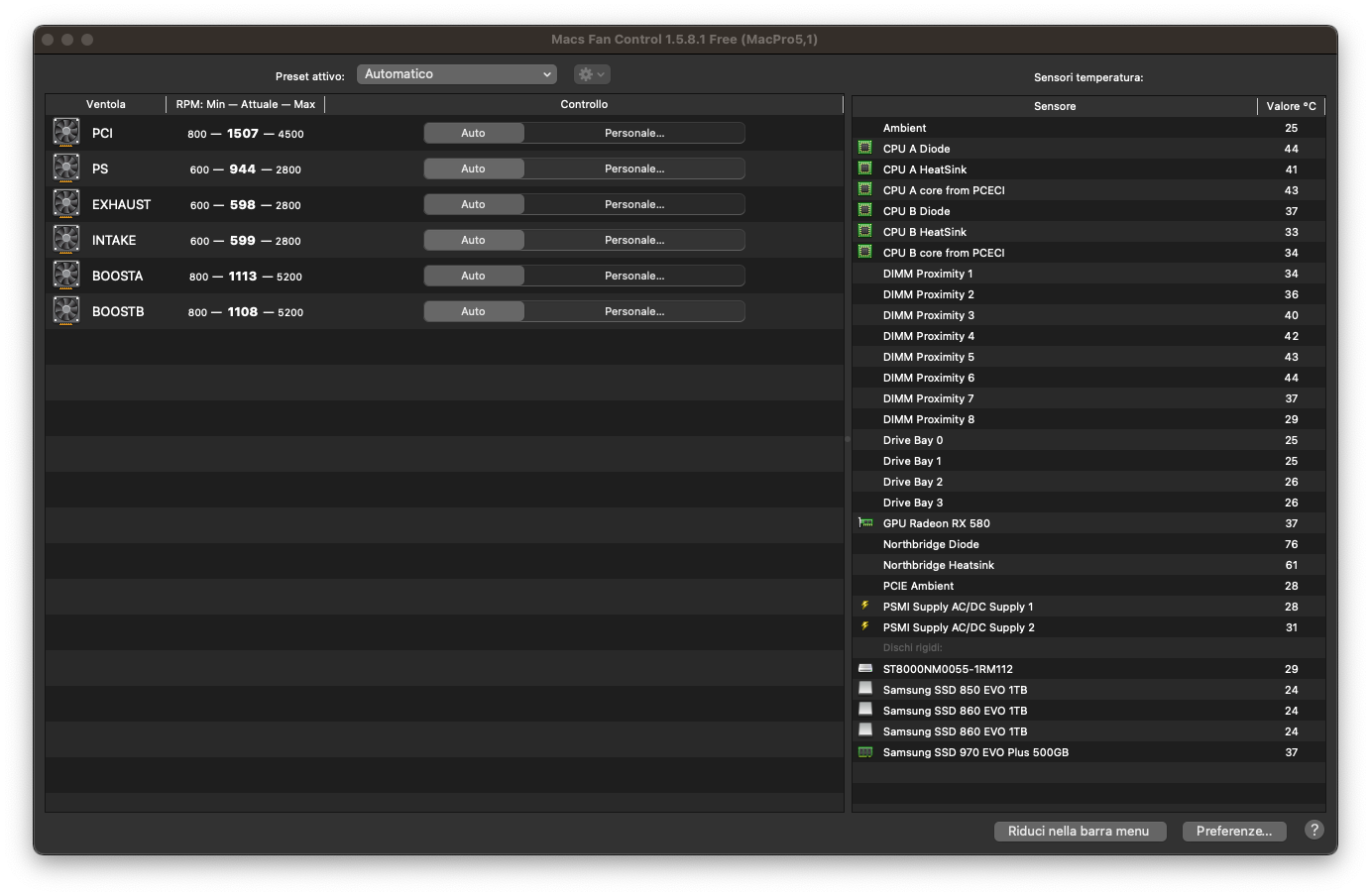

This method had been known for some time, even I had talked about it. The only problem is that all the internal temperature sensors are not correctly detected with this string. Can you please check ? Thanks
P.S. I use Macs Fan Control program

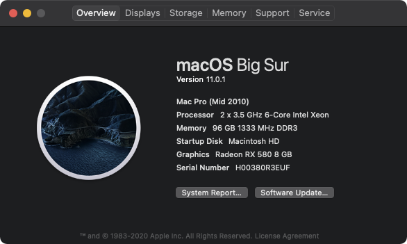

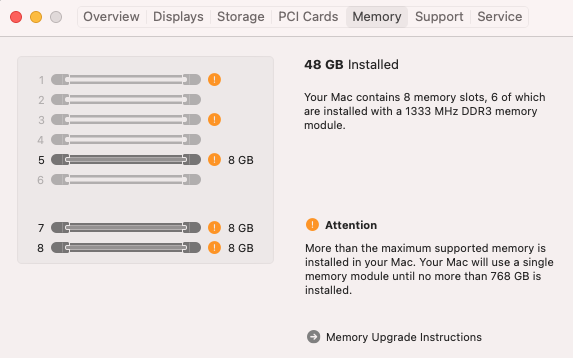

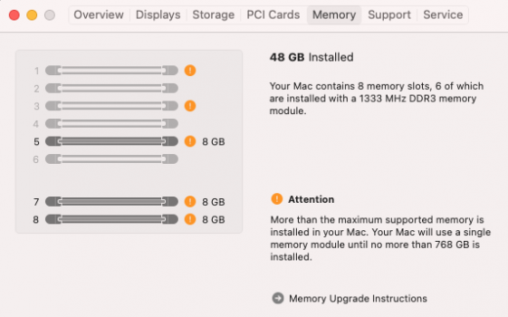

I do not use temp sensors, but you are correct, by changing to MacPro7,1 the RAM modules are wonky, (all cosmetic)
-EDIT here's the fix: https://github.com/IOIIIO/MacProMemoryNotificationDisabler/releases/

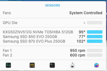

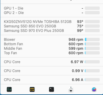

and I just downloaded istat and it doesn't show temps for CPU or GPU but I haven't found that to be a problem in anyway yet.

If you want to avoid the error report for RAM modules, put SystemProductName = iMacPro1,1 but, you will always have the problem of temperature sensors

I actually found a kext I'm going to try to see if it works. I'll report back on it after a week or so.

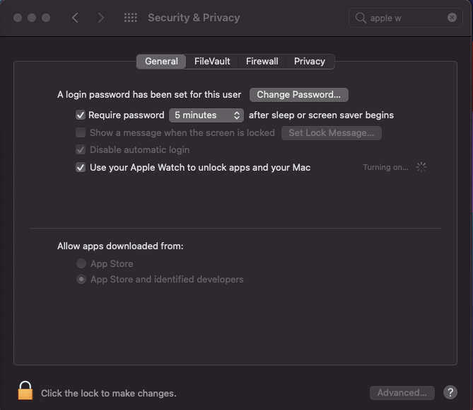

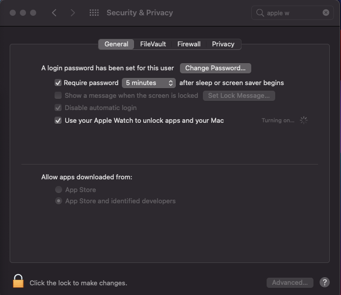

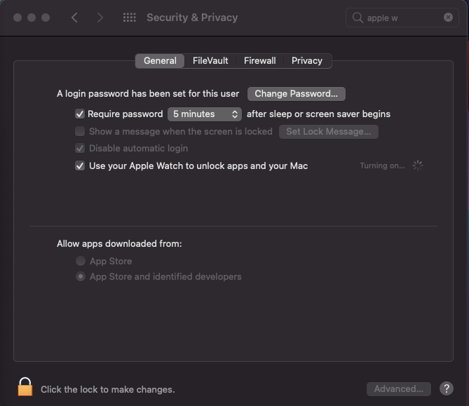

I have AC wife w/ BT 4.2 on my cMP and Opencore 0.6.3 running Big Sur.
I can't get handoff or Apple Watch unlock working. Allow handoff is enabled and I get the following for Apple Watch unlock but it never enables;
Anyone know if I can get them both working with Opencore? Is there something I need to change in the config.plist?
No. Natively.
Did you try this ?
works on my cMP with Opencore 0.6.3 running Catalina
Did you try this ?
I did the sudo mount -uw /
and got this
mount_apfs: volume could not be mounted: Permission denied
mount: / failed with 66
For the next part I got
Can't open /System/Library/Extensions/IO80211Family.kext/Contents/PlugIns/AirPortBrcm4360.kext/Contents/MacOS/AirPortBrcm4360: No such file or directory.
Is there something I'm missing?
