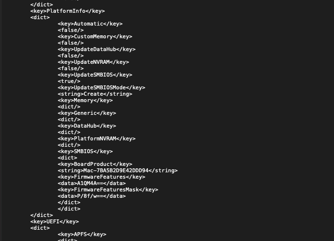

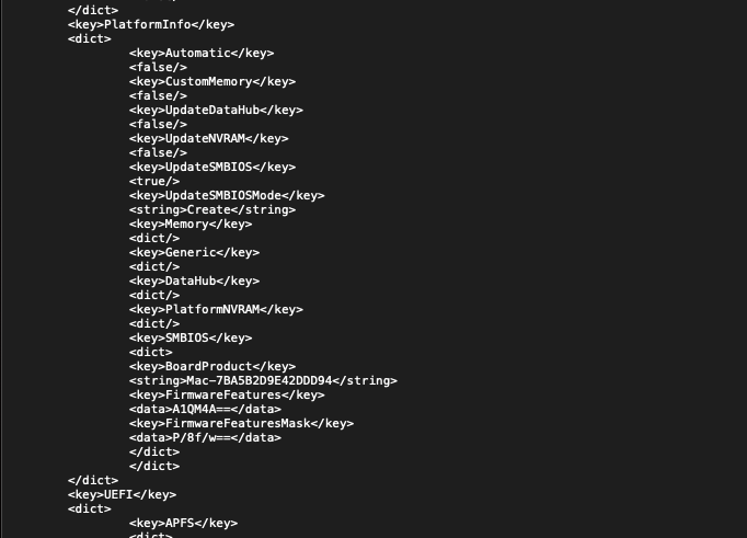

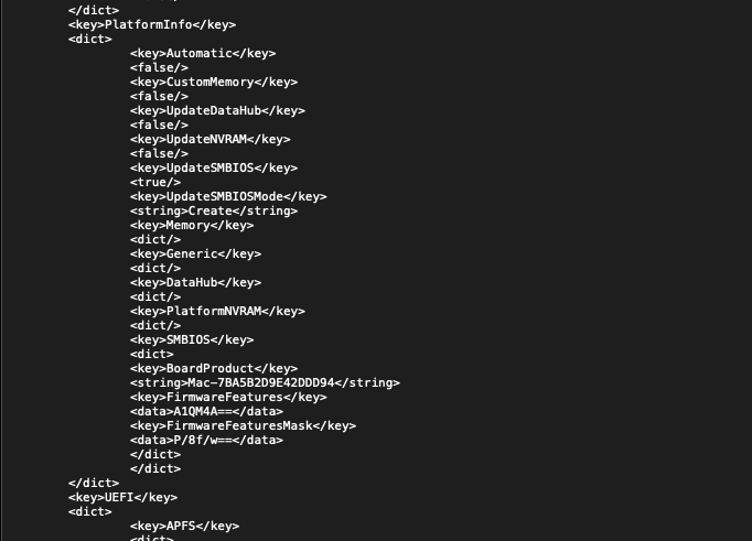

Like this?
Thanks. sadly didn't work. wifi doesn't get enabled. I'm in Big Sur.
Another question, is Lilu and Whatevergreen not working with Big Sur? I get crash reports upon reboot.
also nightshift enable doesn't seem to work.
Did you copied the mojave.kext file into the OC kext folder (where Lilu and WEG are)?
I think you have an extra </dict>. But otherwise, yes.
okay tried without the extra </dict> but I just ended up in an endless restart loop
