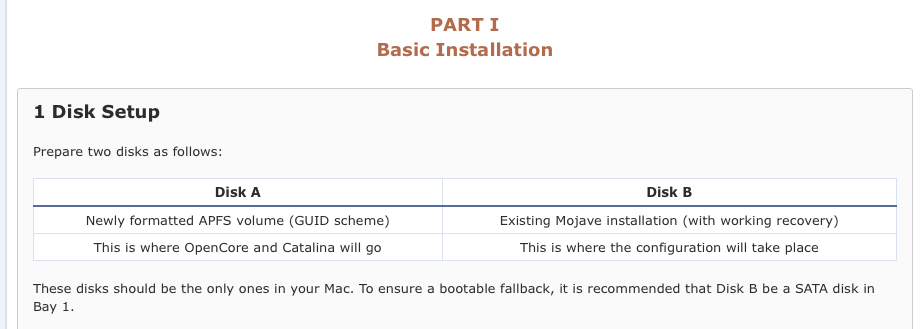

I am still in Mojave. My plan was simply to install OpenCore and upgrade from Mojave to Catalina via Software Upgrade. I made a CCC copy to a disk that I put out of the machine before I started, just to be safe...
You have Mojave installed on two disks? I see what you mean, you edited the previous post. You cannot upgrade to Catalina, it will ask you to upgrade to Big Sur. If you need Catalina, you can download the installer, but it will erase the target disk.
Ok but why? Are you sure?
First, you don't have the suggested initial setup:
You did not followed OP setup, as described. Second, if you follow the setup, your (OC Mojave) Software Update will offer you an upgrade to Big Sur, not Catalina.
You have a valid point, the guide is there for a reason, if people would follow it to the letter, there should be less confusion and easier troubleshooting...
Now, in this particular pagraph, the real reason to have two disks in a real mac, is to be able to actually allow OC to run. The EFI on the orginal disk is the Apple one and I very much doubt you can replace that folder and have the system running on one disk. (well, you might be able to replace the folder, but I doubt you will be able to boot into recovery. And if you managed to do so, the good old Apple EFI will be back in charge)
The B to A disk trick keeps Apple at bay ;)

The guide tells you to have 2 disks present in your Mac, one for Mojave (default) and one for OC Catalina/Big Sur.
Yes but does that really explain my problem? 😬 I am confused now - why does it make a difference? Right n

thx a lot everybody. I ended up doing it as mentioned, installed Catalina on the empty disk and using migration manager, everything works now 😍

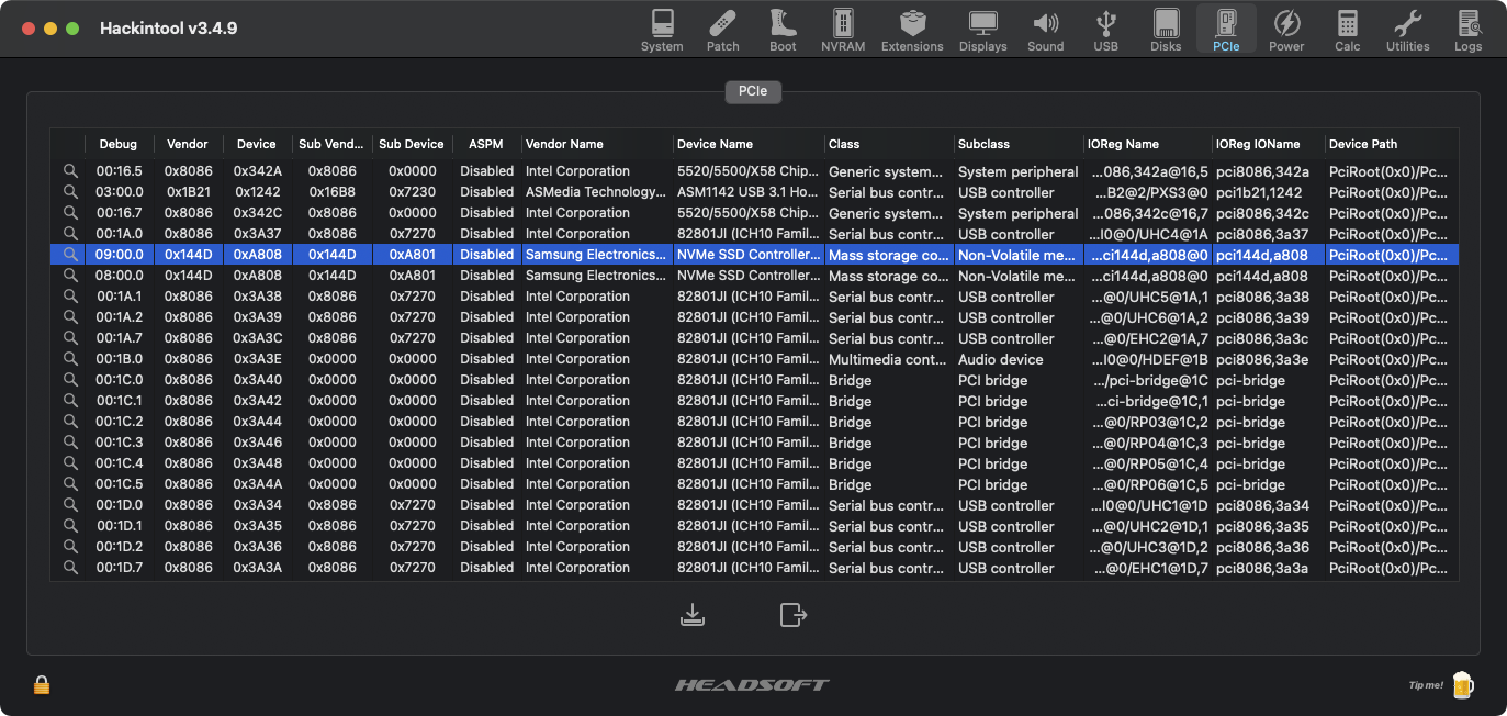

I have tested OC on MBP15,1 and to make my Thunderbolt PCIE external drive appear as internal only this helped:
none of the kexts or built-in property worked.
