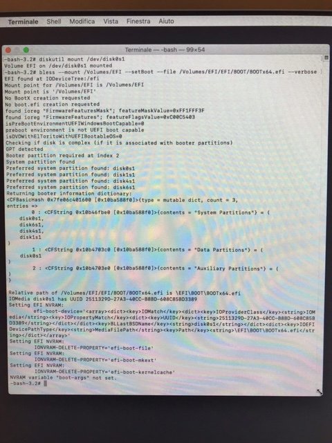

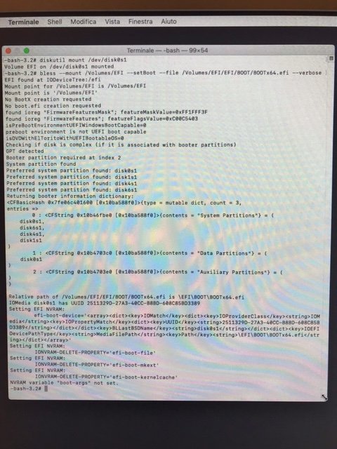

I never disable SIP, when I bless the EFI partition and I never use the long bless command. I do however shutdown the Mac for 15s, instead restarting it directly. I did tried before a simple reboot and it worked but I rather use the @cdf purist approach for your hardware.
yeah for some reason the short command has never worked for me. and as I said, you need to disable SIP if you're trying to bless form the OS because the bless command has been blocked since the introduction of SIP.
but you don't need to disable it if you're doing it from an USB installer or recovery partition.
personally I always leave it disabled. it's a pointless niche feature.
I thought a reboot will enable it automatically? At least this is the behaviour I get on my Mac.
not for me. only reseting the SMC (or PRAM?) should re enable it. I think this also breaks OC, as in you would need to re-bless it. but I'm not sure.
Yes. Following the instructions on first page. When you boot into recovery SIP is temporarily disabled. But not set to disabled. So when you boot normally again SIP is enabled. This is how SIP behaves with or without OpenCore.
Check it with this command csrutil status
This is one of the reasons OpenCore is superior to other solutions. You keep a high security OS.
yeah you have to run in the terminal of an usb installer or the recovery partition "csrutil disable" to disable it permanently.
but if you don't need to there's no need. I just like having it disabled cause I do all kinds of things apple doesn't want you to do that SIP blocks. including blessing a volume.

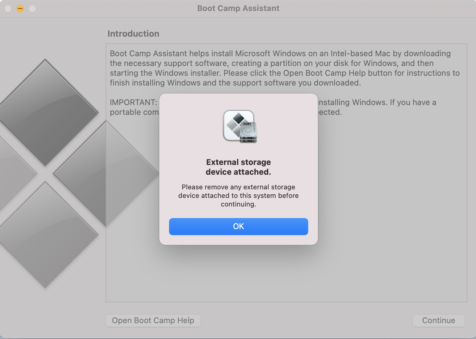

Not yet. I am working on another project. I am trying to create a bootcamp partition on my external drive on the MacBookPro15,1. The Bootcamp assistant works on the cMP in BigSur (it stopped working in Mojave and Catalina). The problem is it creates hybrid (MBR) partition on the same drive where the Big Sur APFS volume is. I would like it to create an UEFI aware partition, but the Bootcamp Assistant complains in the MacBookPro15,1:
although all devices appear as internal (set by OC) as seen in the Bootcamp Log file:

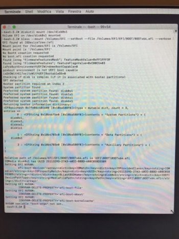

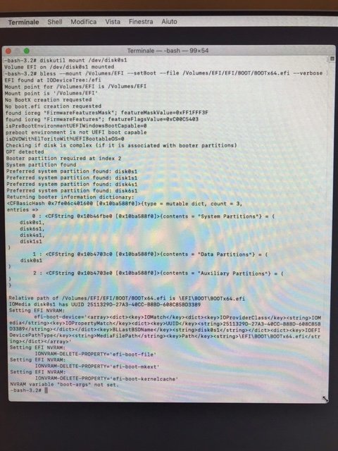

Today I replaced the Sapphire RX 580 card with the Radeon VII (with Pixlas Mod) and with native Mojave it works great but when I reinstall OC 0.5.9 it doesn't work.
I tried to install 0.6.3 too but I can't install it because the bless fails and keeps giving me an error!
Should I do anything other than OC guide?
Until now with the RX 580, OC 0.5.9 and Catalina I have never had any problems with my 5.1 cMP!
Help me pls!!! Thanks!
Should makes no difference. At least, GPU won't cause bless fail (this usually because the user forgot to disable SIP).
Disabling SIP is the first thing I do!
Unfortunately as you can see from the picture of the Terminal the bless is not successful (it doesn't happen correctly) and when I restart the choice is locked on "Catalina" (on monitor #1) and I can only press enter... strangely then (very slowly) monitor #1 turns black and the login screen of "Mojave" appears on monitor #2.
Even while logging in monitor #1 remains black!
It's really a mystery!
The only thing I've changed is the graphics card and when I boot from native Mojave (without OC), everything works fine!
Please help me! Thanks in advance!
