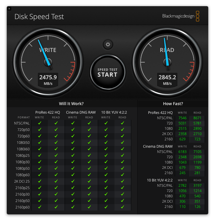

I think your speeds represent the maximum available on the cMPs without a bifurcation card. I get your speeds or somewhat less with a 960EVO on my 6-core.
On my 12-core, I have the popular Syba /IO Crest PCI card which, in slot 2 (16x) allows for 2 blades (1 970EVO, and 1 970 EVO+ in my case) and PCI3 speeds, or almost. They both get 2.4GB/s writes and 2.8GB/s reads. The cards have a fan and are are heat sync, and cost around $200. My only complaint is copying between them is way too slow.

Sorry but there is a bit of confusion and in particular there must be a misunderstanding!
I have a cMP 5.1 12 core 2x3.46 GHz, 128 GB RAM with a Syba / IO Crest PCI card in slot 2 (16x) with 2 970 EVOPlus 1 Tb but which absolutely fail to reach your speeds (2.4 GB/s writes and 2.8 GB/s reads)!
They max out at 1.4 GB/s writes and 1.5 GB/s reads!
Could you tell me how did you manage to reach certain speeds on your MVMe discs?
Did you update the firmware at the 970 EVO! And how?
Thanks!
I don't know why you have a problem. I don't think it's the firmware, because I got one of the early PLUS blades before the new firmware, and it wouldn't work after a reboot with multiple kernel panics. I wasted two weeks until I found out the situation with the "Upgrade guide to the cMP" or something like that. Get it, it has everything about our cMPs.
I have heard that some of the newer bifurcation cards didn't work on the OC forum.
First of all, since you had it in the correct slot (my first thought before rereading your post), I can only think of two things. First I'd inspect it carefully for any anomalies as I took the card out. Then I would open up the card and take a look inside. Do you have the thermal material installed properly? I take it the fan was working. If all is well, I'd be contacting your supplier.
Check the upgrade guide, there may be something there I missed as to solutions. You might try to take out one drive at a time to test single speed numbers. That might indicate a hardware malfunction. Carefully reinstalling everything may even help. The fact that it works but not properly indicates a bad card or connection to me, but I only know enough to guess. Good Luck
