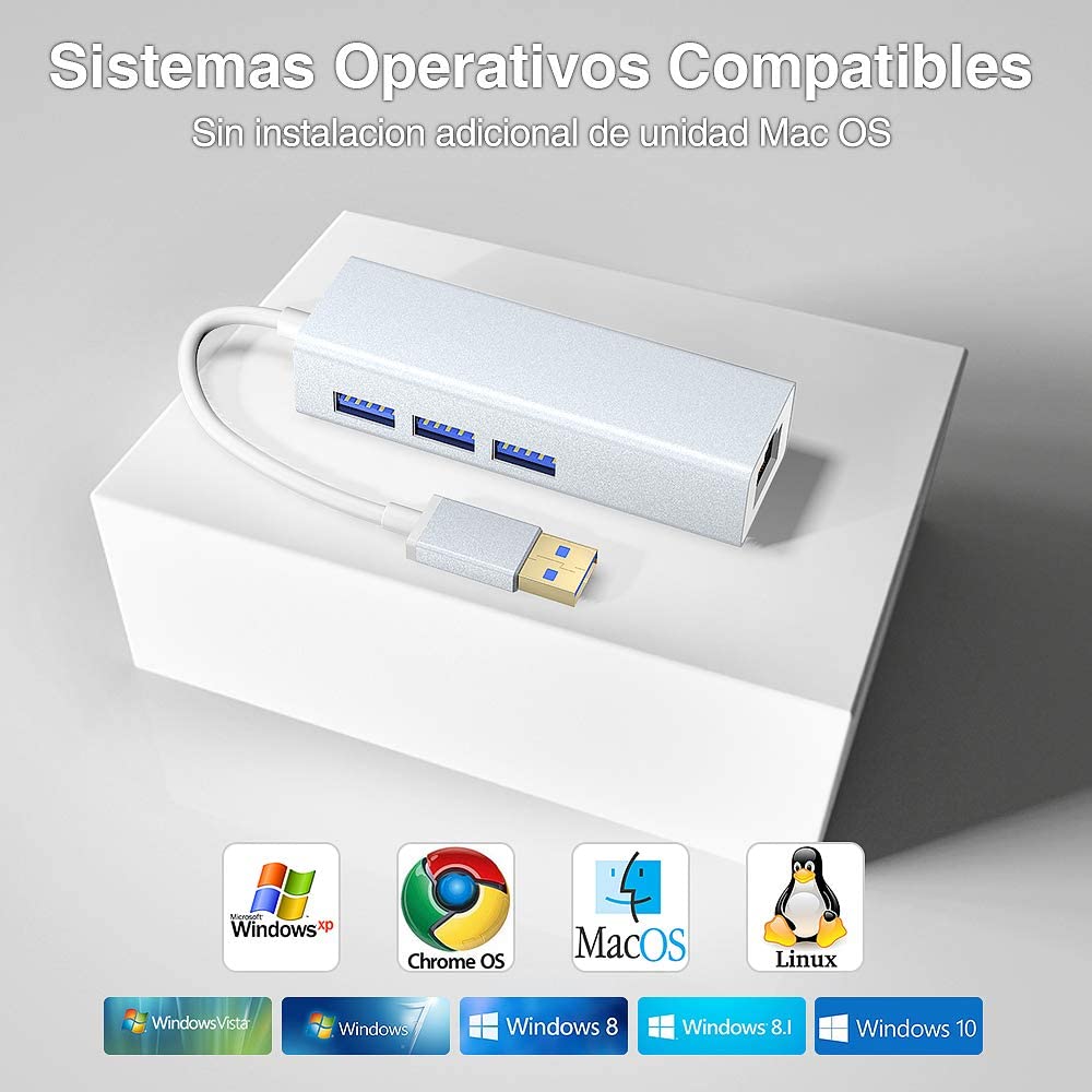

Can you disconnect/reconnect the USB keyboard or mouse in the back/front USB ports without loosing functionality? Are you using any SMBIOS spoofing?
I have an aluminum apple USB keyboard (connected to rear ports) + Magic Trackpad. Everything works as it should.
I just followed the steps in part 1 of the guide, my cMP doesn't need more than that. I had problems with a controller midi keyboard (USB), but I solved it by installing a usb3 Hub.
PS: with GTX 280 4gb Flash Mac Edition, and BCM94360CD
