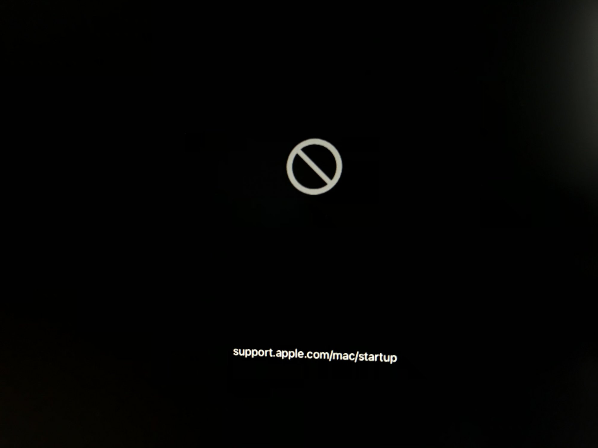

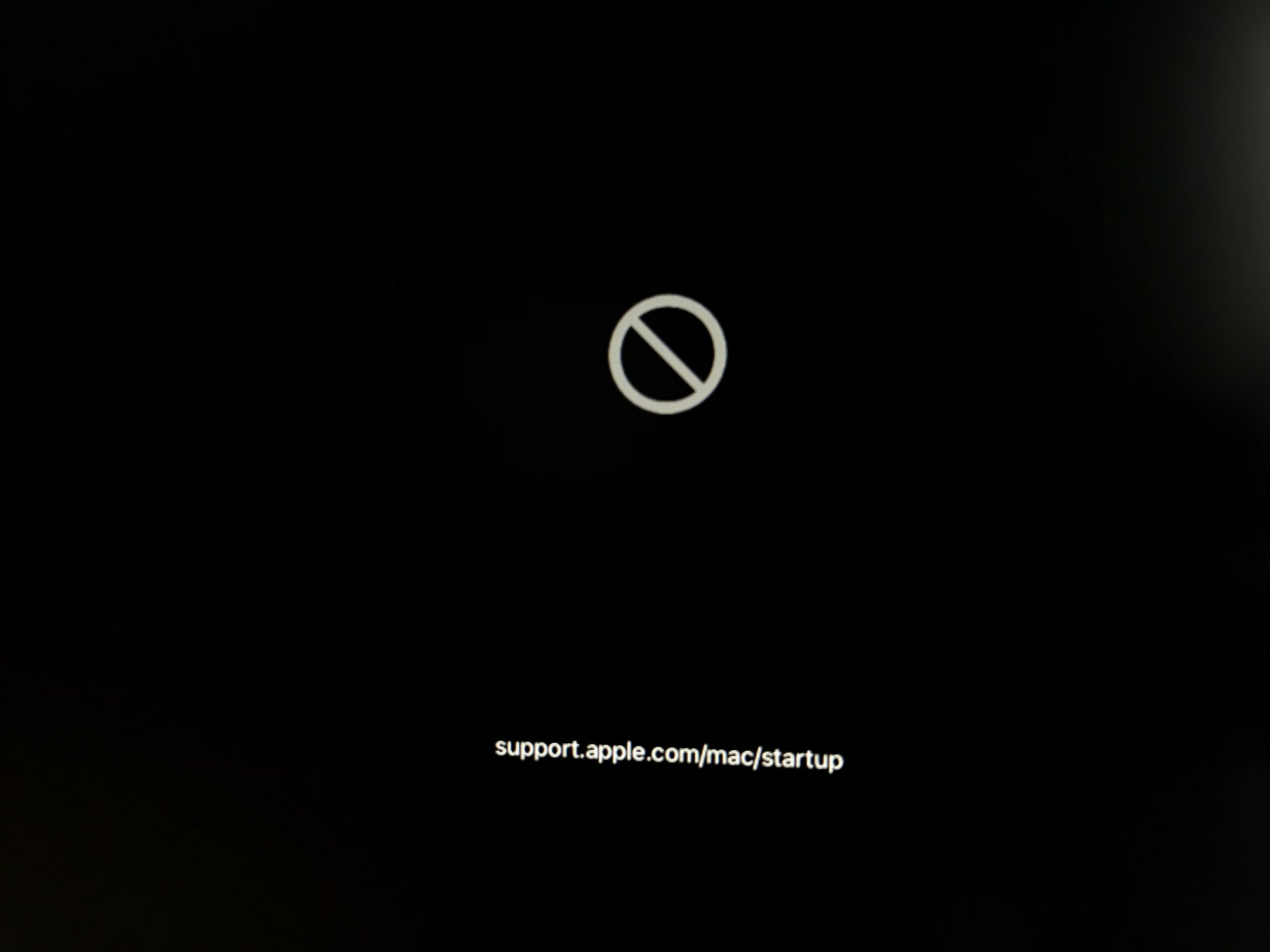

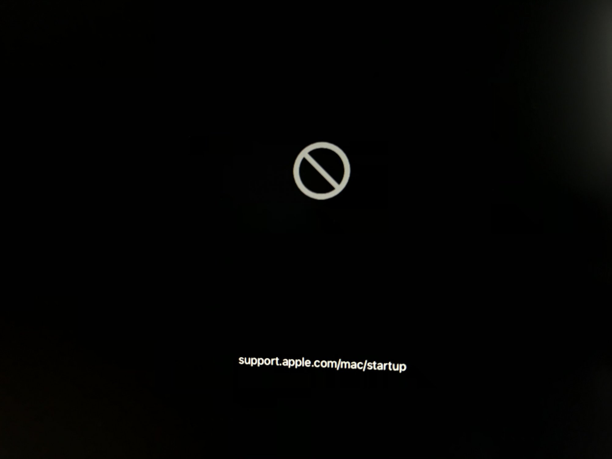

okay so I spoofed my Mac Board ID from the iMac Pro Board ID to the Mac Pro 7,1 Board ID and removed lilu and WEG again but now when I boot I get this error sign. How can I fix it without spoofing back to the iMac Pro Board ID and what did I wrong?
Thanks in advance! 🙂
It looks like that you haven’t mod the config plist correctly (e.g. some typo). You should revert to the default config, or last known good config, then mod it again carefully.

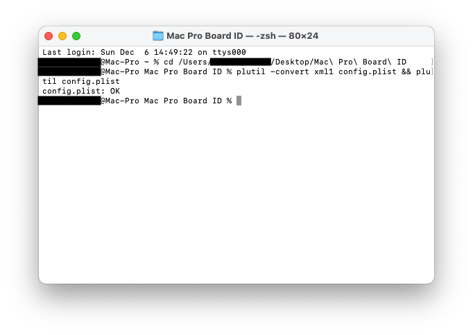

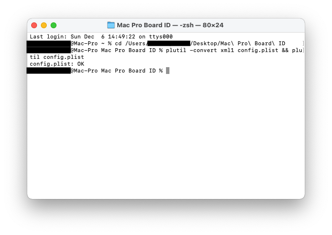

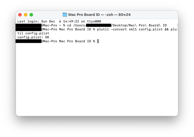

I couldn't find any mistake in my config ...
The output I get in Terminal is also okay:

Please just revert to the last known good config.
Then only change the board ID but nothing else.
Okay so I tried this on my last known good config with only HWAccel, the AppleMCEReporterDisabler and the iMac Pro Board ID enabled. I changed the Board ID again to the Mac Pro 7,1 Board ID and what should I say I doesn’t work for me again. Should I try this again with your configuration?
Thank you for your suggestion and fast replies! I really appreciate it!

Yes please, for diagnostic purposes, please use my default config, but just change the board ID.
That works on many cMP, no reason not work on your.

Works here without any hassle... your (h9826790) config and only changed the board ID.

Thank you so much, Martin!
My Mac Pro boot up now just fine with the Mac Pro 7,1 Board ID without Lilu and WEG with your config!
Now I still have to edit your config for my needs, but at least everything works now.
Thank you!

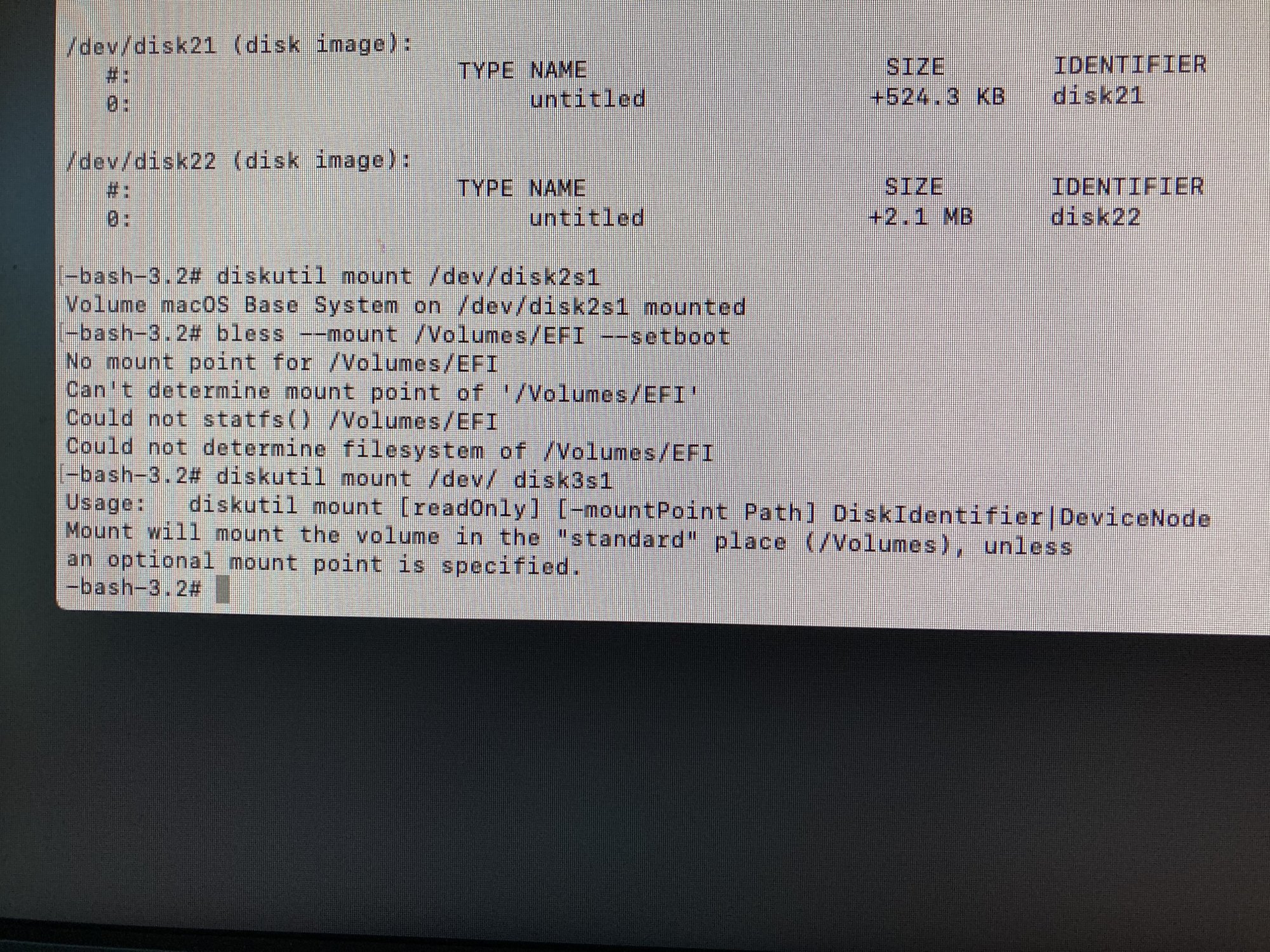

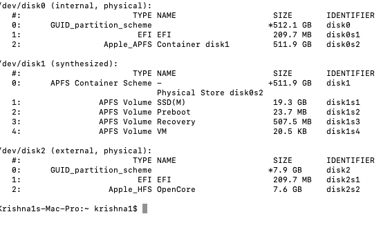

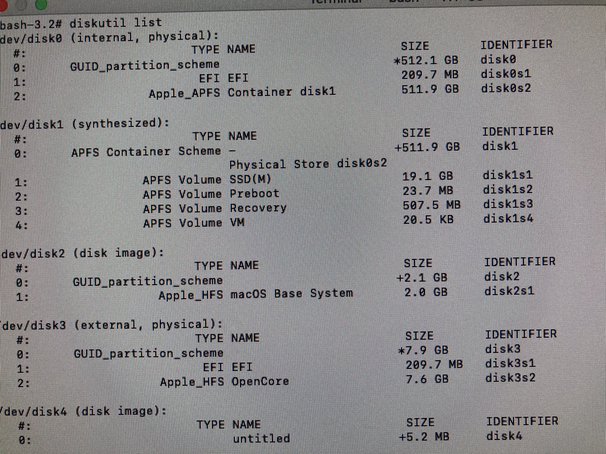

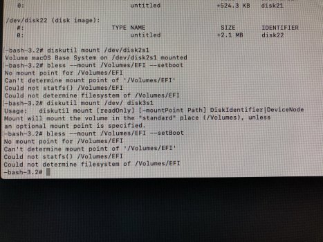

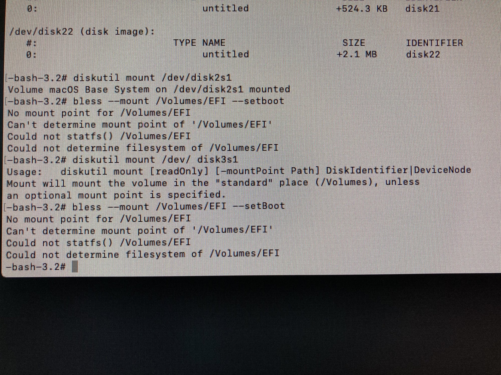

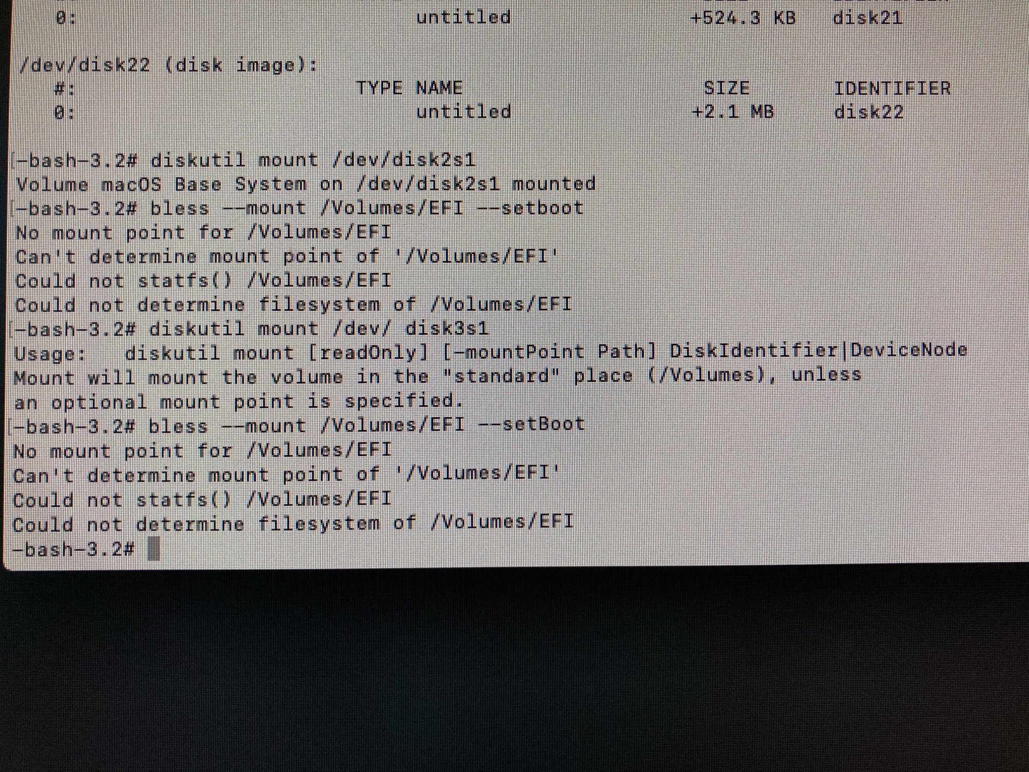

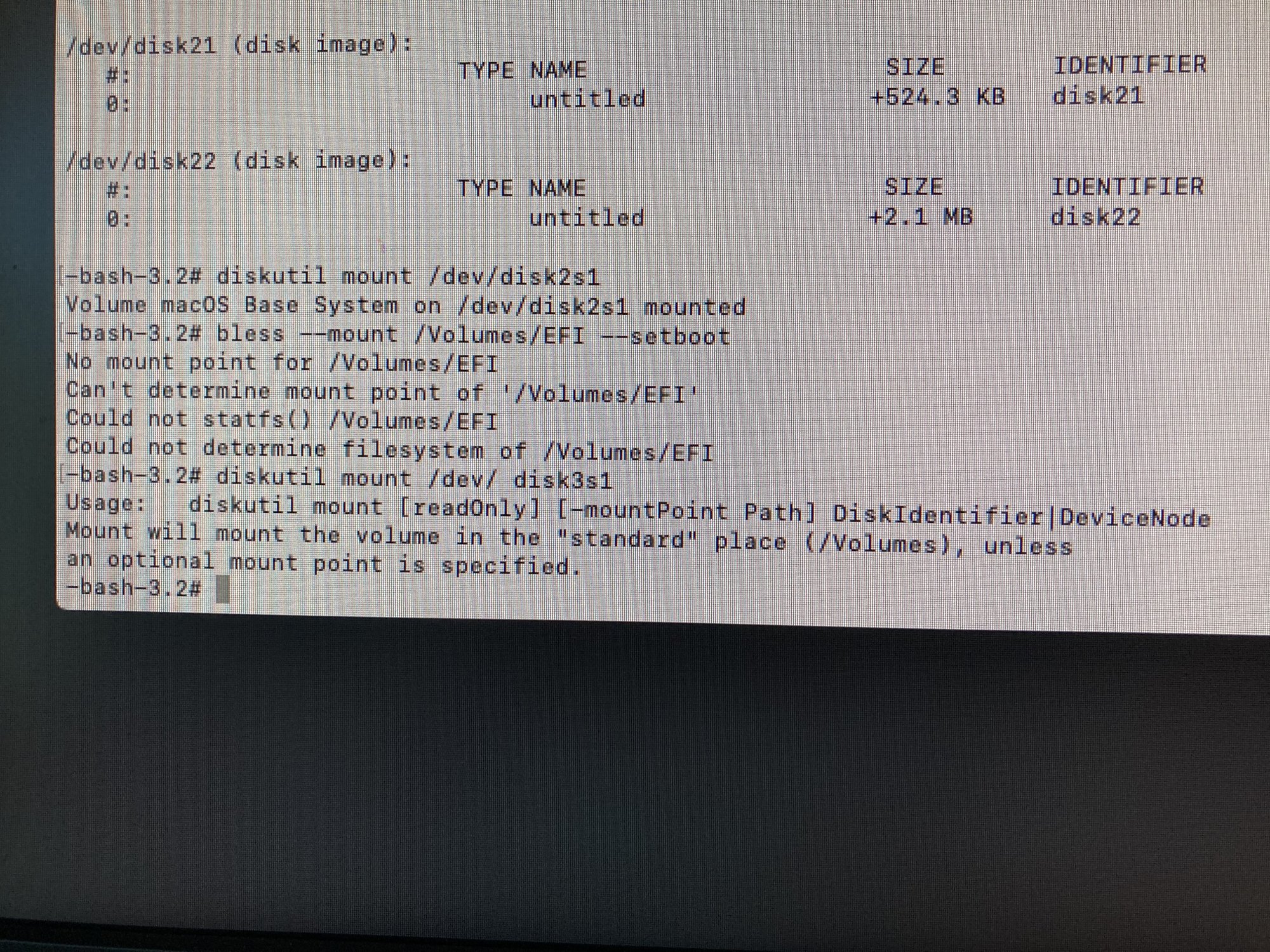

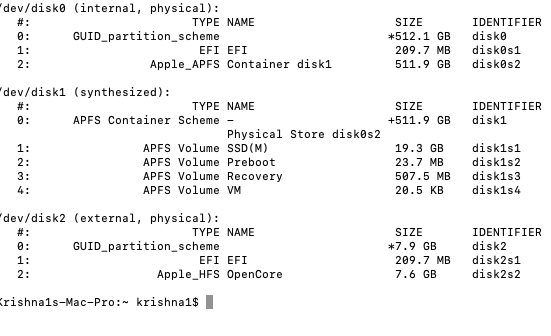

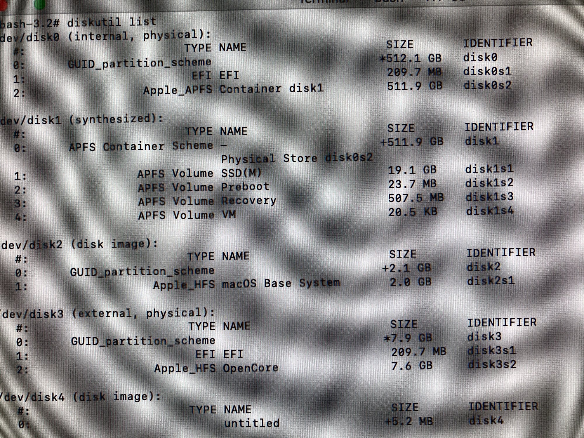

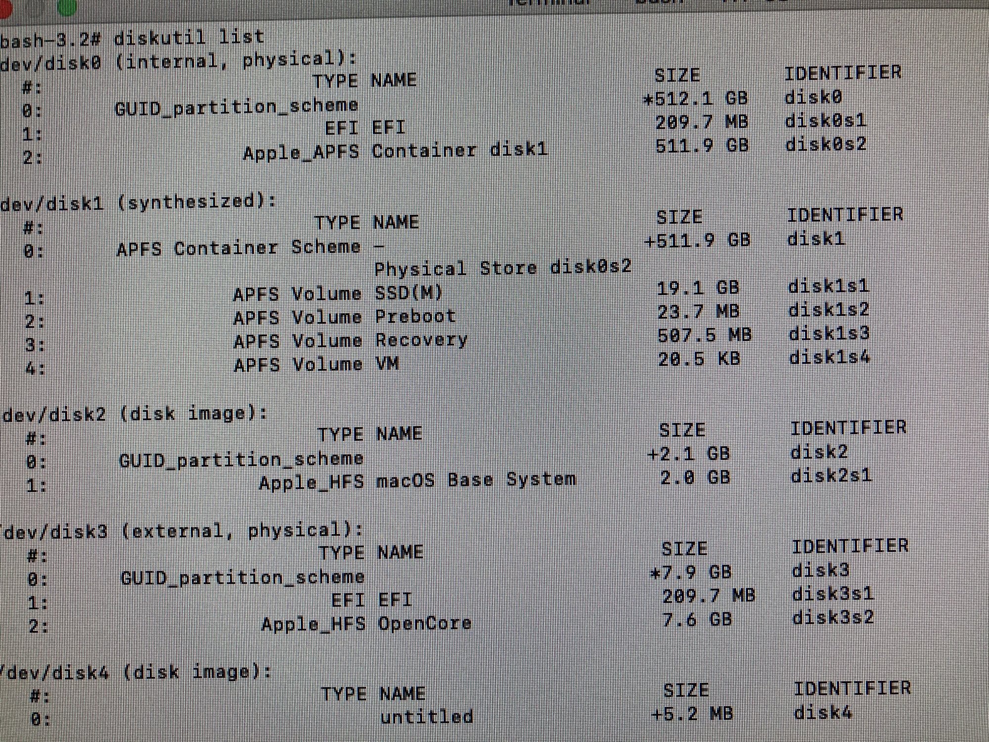

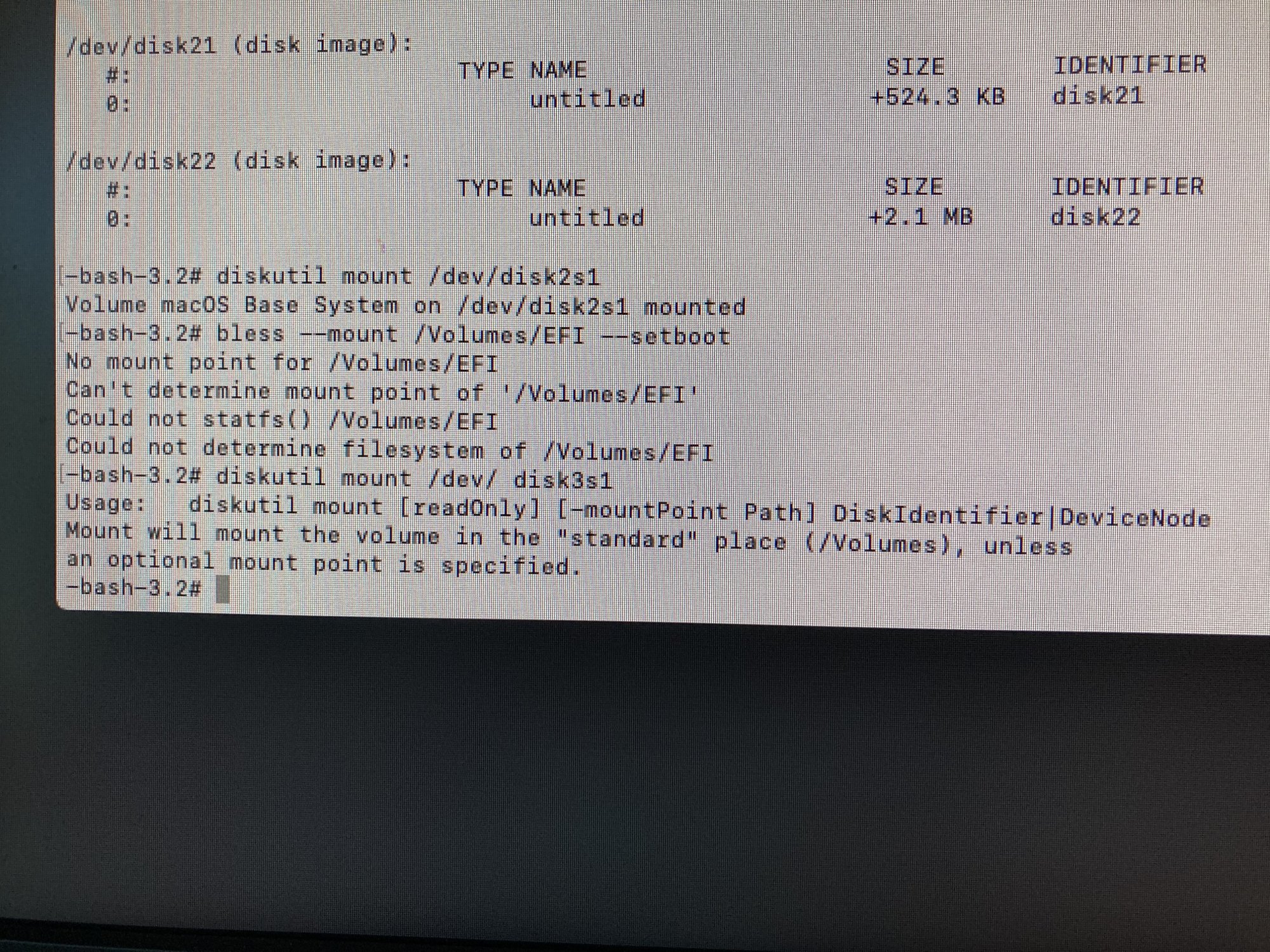

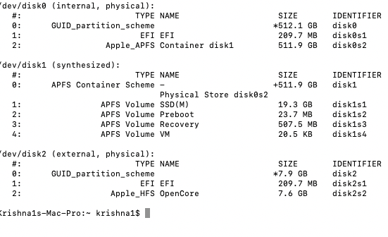

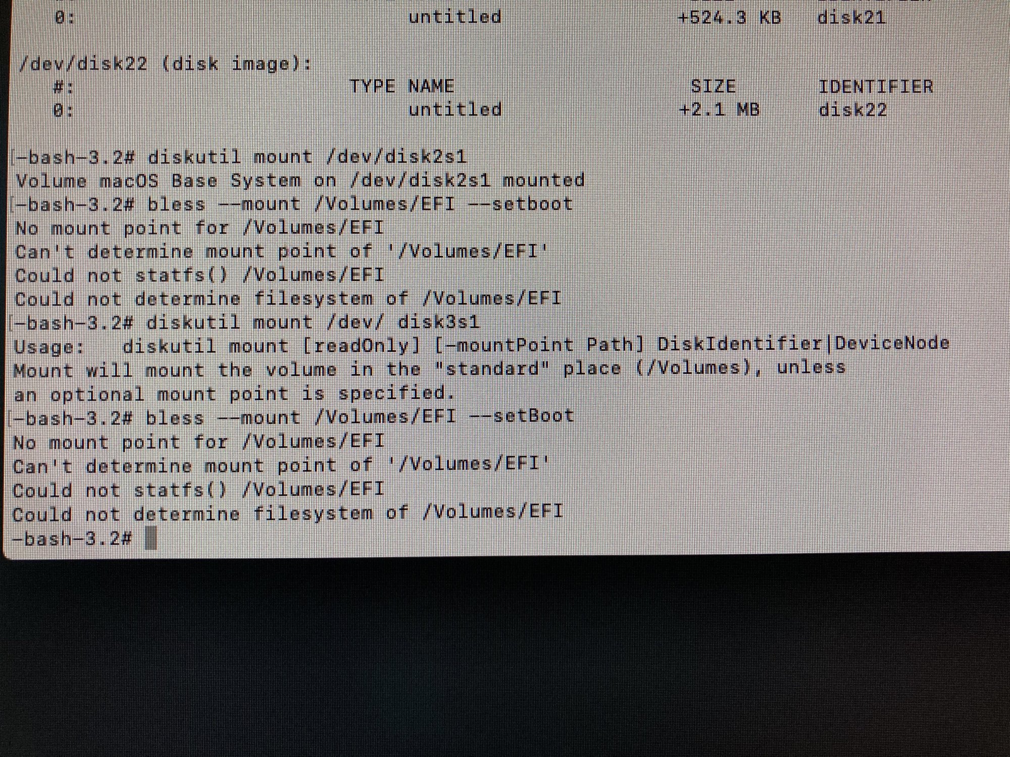

Guys I need help installing the basic open core, I am following the Post1 method (installing on EFI partition of external usb stick, for disk B, I am using a sata ssd with Mojave), in Step3 I was able to reboot to recovery but I am not able to mount the EFI for blessing. I tried to mount disk2s1 first as that was the identifier for EFI partition of usb stick in step 1. Then tried disk3s1 but no good.
I'll appreciate if you can guide me here. Thanks
