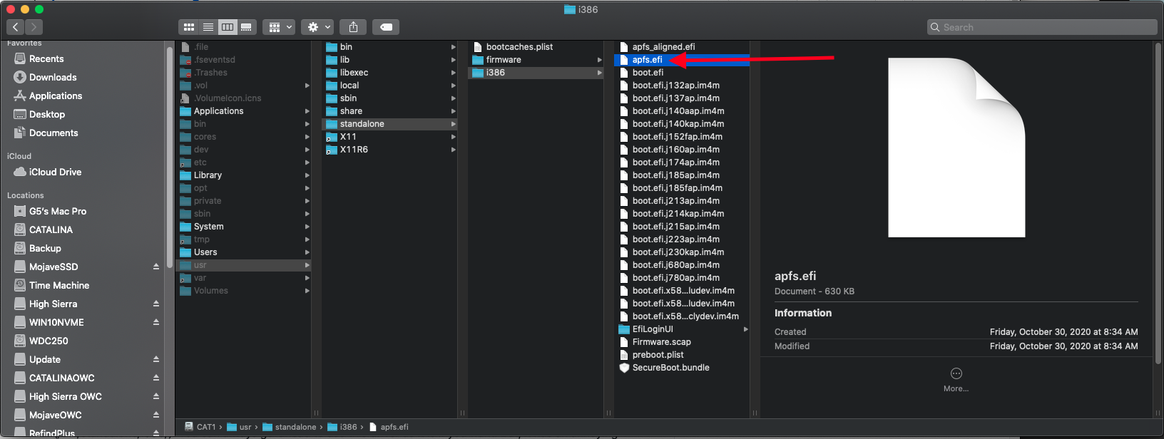

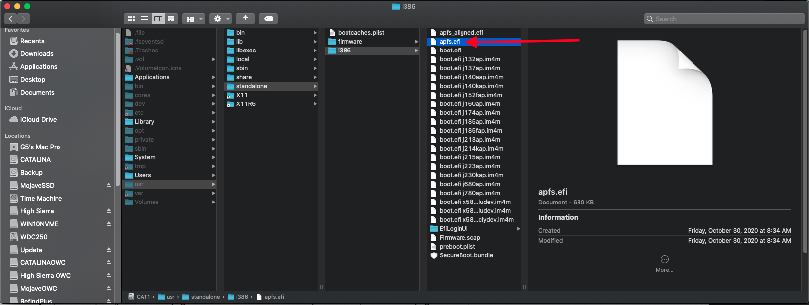

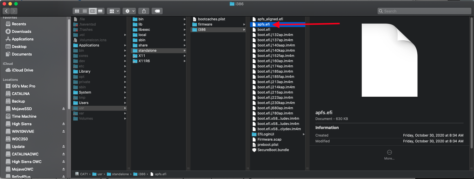

Installation of what exactly the APFS.efi driver? You just put it inside the drivers folder and select it in the OC configuration file. You can generate it following this instructions:
RefindPlus/BUILDING.md at GOPFix · dakanji/RefindPlus (github.com)
After you compile RefindPlus you will find the driver in the same folder as the generated refind.efi file.
You mentioned an AFFS.efi - no typo. Was that a mistake? I built and installed RefindPlus.efi including config and it did not change the issue.
I said it was a typo on my side. Also APFS.efi is not in the RefindPlus package. Clickhere for the actual driver.
Just some background info: are drivers loaded by OpenCore replaced by the running system? I am thinking about preloaded drivers like APFS.efi.
You can use Catalina's own apfs.efi:
