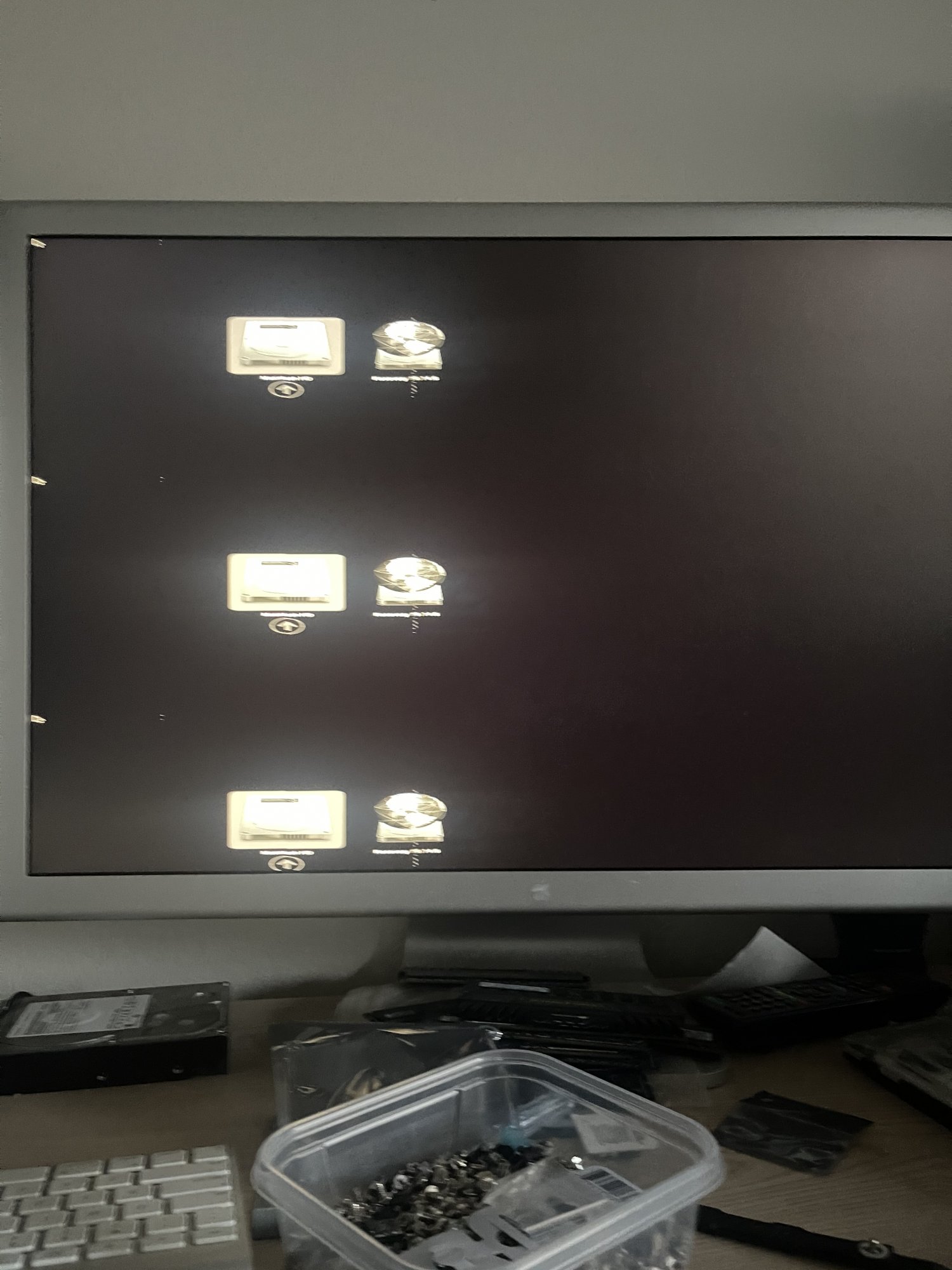

My OpenCore 0.63 is working nicely now on my cMP 5,1. But one puzzling thing is that in the Boot Menu I see an extra bootable drive with a name that I had used for one of the bootable partitions some weeks ago.
I have had several NVAM resets since then, not sure what that is from. Selecting it nothing happens.
Is there any way to clean that up?

What is the extra drive's name?

Neptune - which was the name of the boot. It's the system name and I used to name the main boot drive the same as the system before changing to the macOS version like Mojave, Catalina, and BigSur.
If the drive is bootable it will show up in bootpicker. You might want to repartition the drive for data only.

There is no longer a real drive of that name. It was renamed Catalina - both Catalina (system) and Catalina - Data. This was a couple of weeks before OpenCore.
It does not show in the EFI Option Picker.
What is causing this problem at boot up with open core on a 30 inch apple Cinema Display

That was my first step - both with GUI Disk Utility and diskutil list. Nothing.
I identified the issue. It was a drive actually named Archive, which had an older Mojave installed on it. Why it is called Neptune is not clear. The older Recovery rev gave it away.
Yes, there are a lot of drives on this box.

Do you have filevault enabled? Try repairing the caches.
