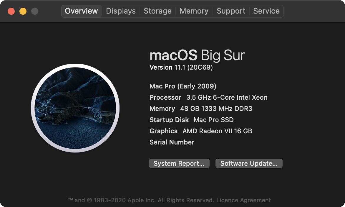

How did you update? I checked on mine and it said no update was available and 11.0.1 was the latest
As per cdf's finding, I keep the following code in the config plist to get Big Sur support.
Code:
<key>SMBIOS</key>
        <dict>
            <key>FirmwareFeatures</key>
            <data>A1QM4A==</data>
            <key>FirmwareFeaturesMask</key>
            <data>P/8f/w==</data>
        </dict>
I was able to update to Big Sur 11.1 with OC 0.6.4 with the correct VMM flag, but the Catalina Security Update did not show on System Update. The downloaded version refused to install. Has anybody had better luck?
