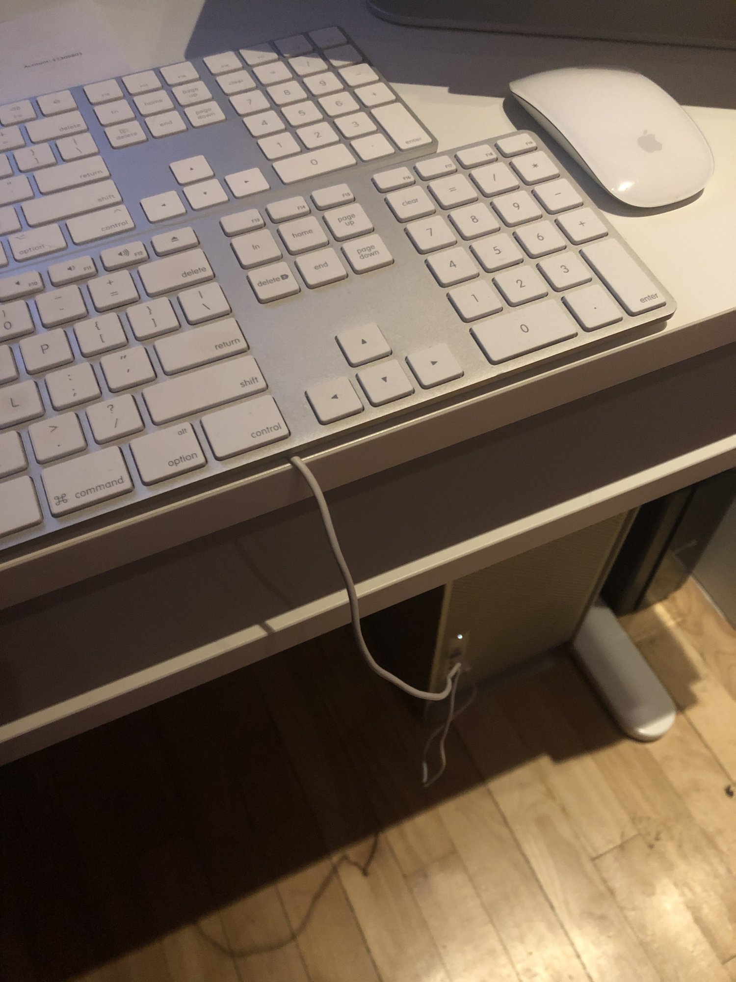

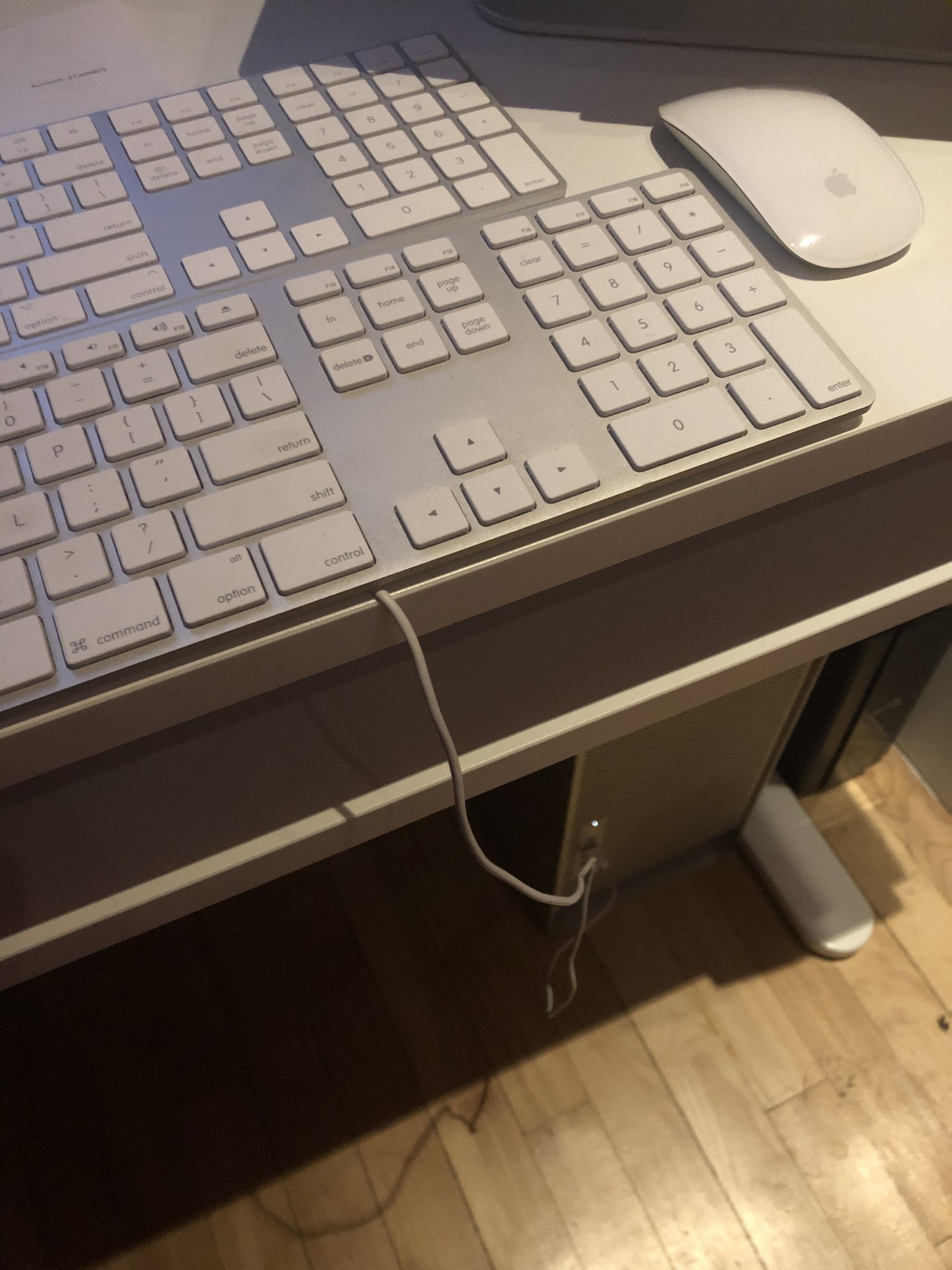

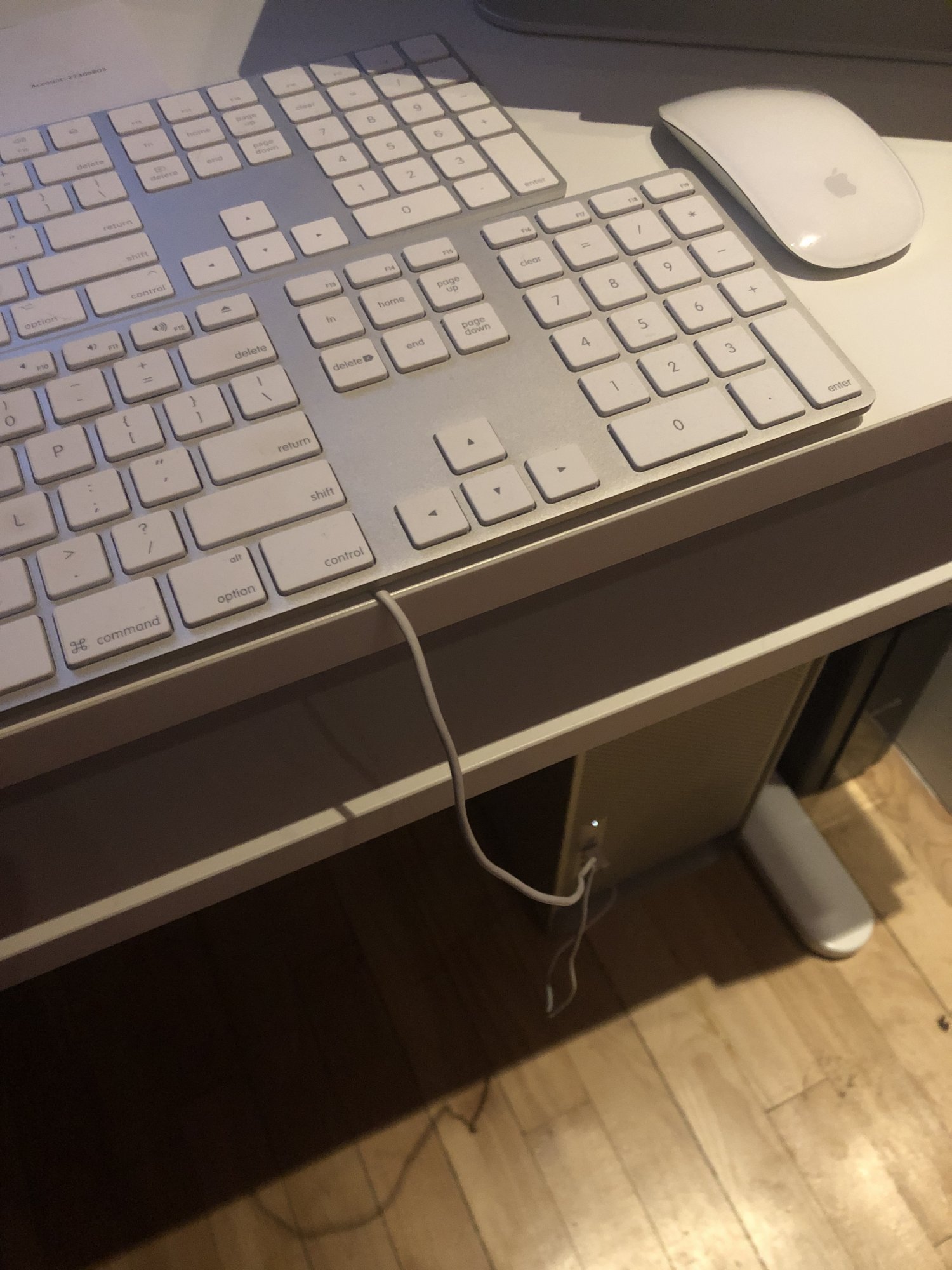

One of the issues is that if you have a keyboard and mouse connected directly to the USB ports (front or back) and unplug/reconnect the cable it will not reinitialize.

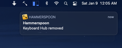

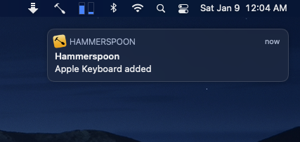

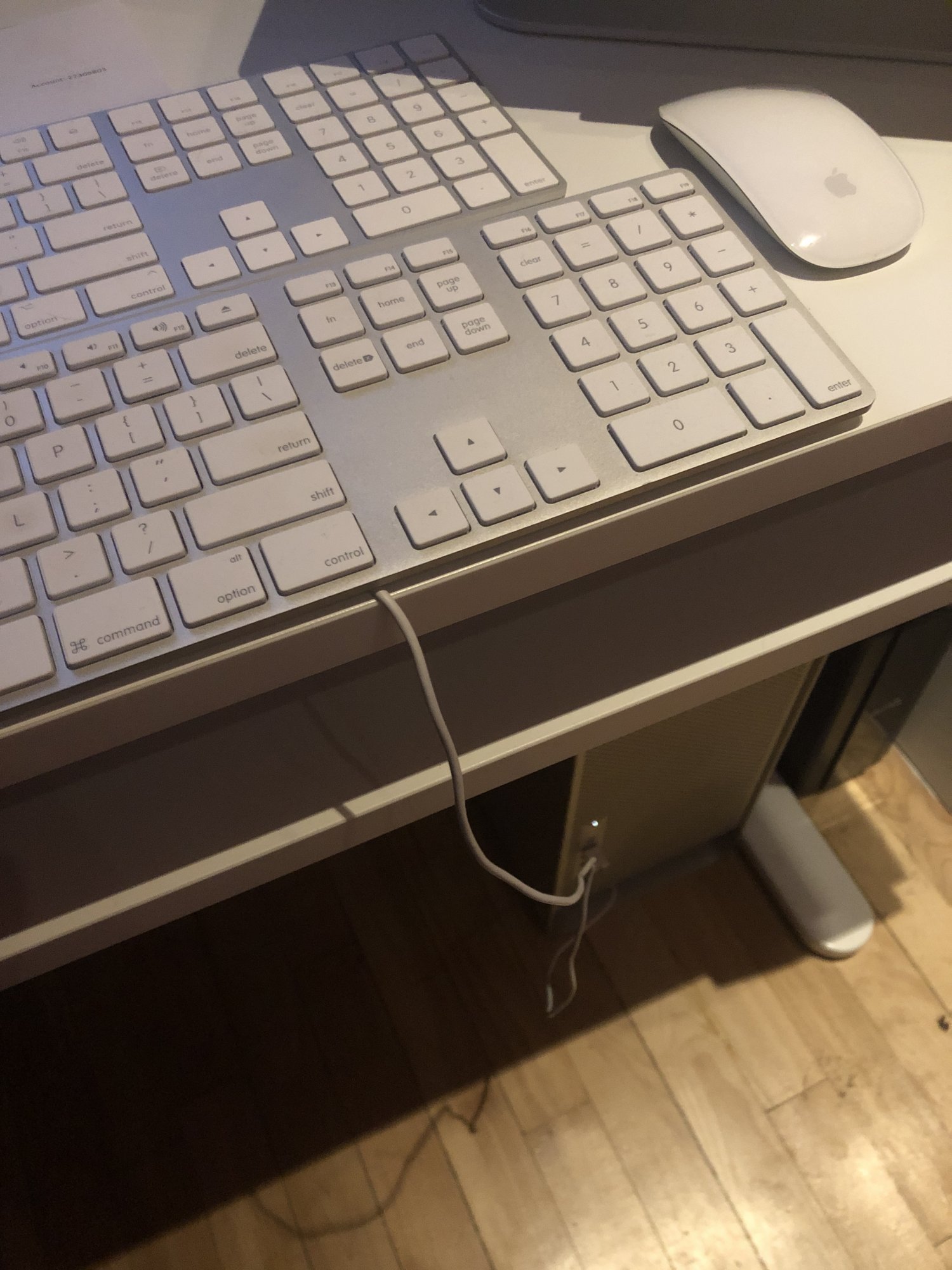

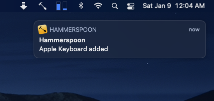

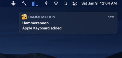

I'm using a wired Apple keyboard plugged in front USB, it is properly detected and everything works properly for me after an unplug/plug. I'm actually typing this with the wired USB keyboard and use Hammerspoon to get notifications what is going on with anything in my Mac.

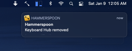

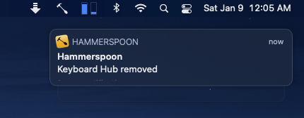

When removed, my Mac sees the wired Apple keyboard as Hub:

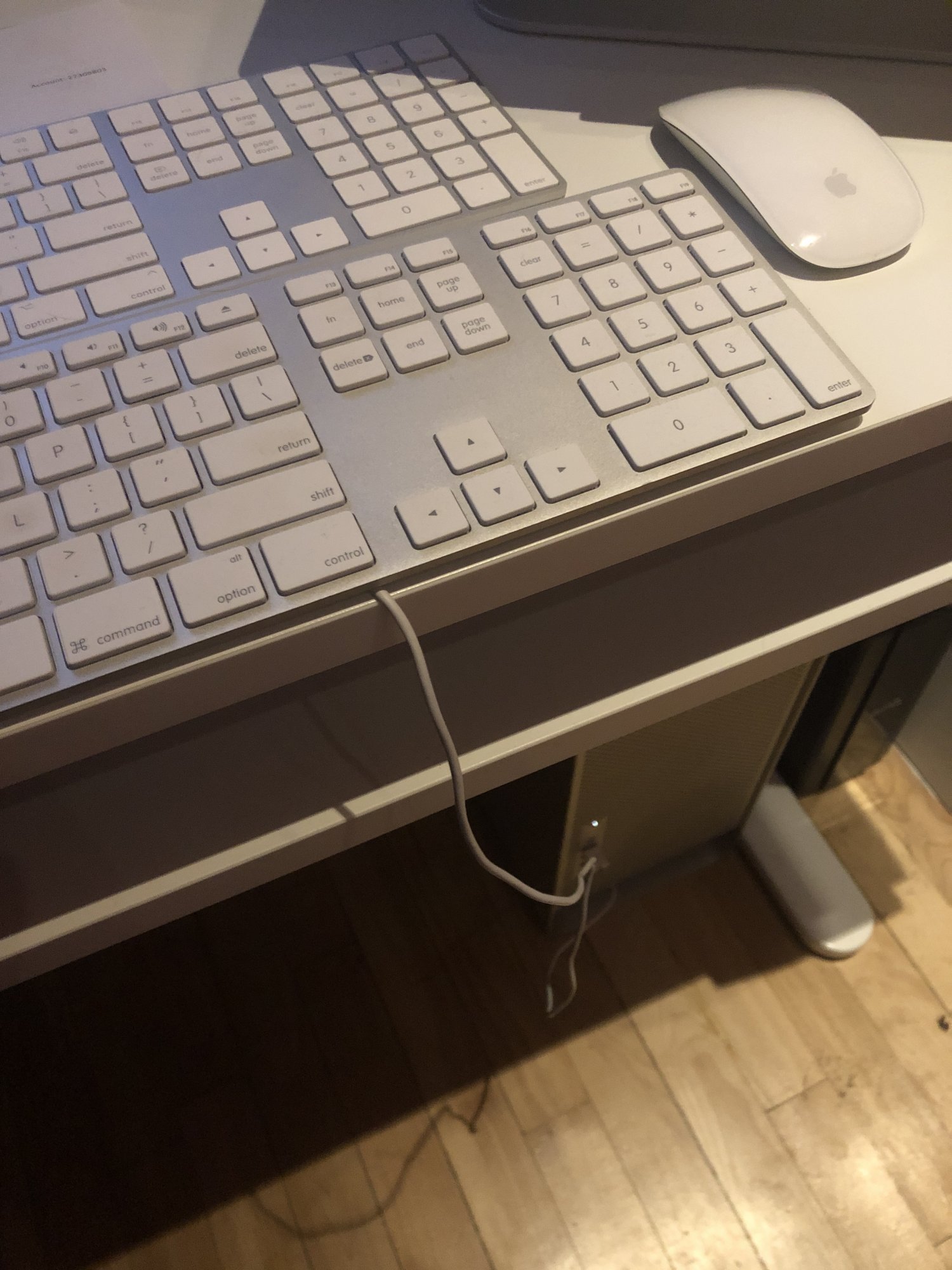

When I plug it back, I can write fine with the wired keyboard. I use an original wired Apple keyboard plugged directly into front USB:
I am using the older plastic keyboard.

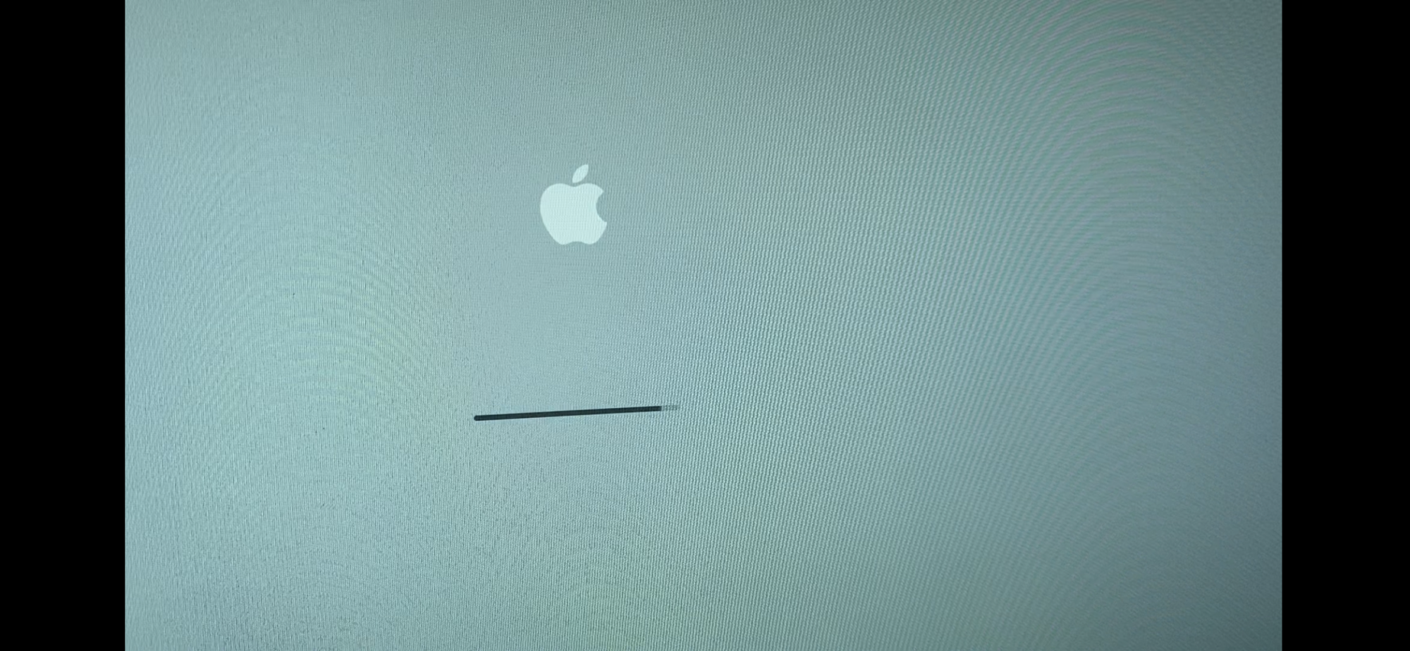

Now I show you what happens
1) Start with config1, use BoardProduct = Mac-7BA5B2D9E42DDD94 (iMac Pro) and load video card and all necessary kext including Lilu 1.5.0 and NightShiftEnabler 1.0
- OC boot menu then black apple and black line
- At a certain point black screen then reappears apple but white with black line and at the end user login Big Sur
- Obviously NightShift is not working
2) Start with config2, use BoardProduct = Mac-27AD2F918AE68F61 (Mac Pro 7.1) does not load video card and I only use AppleMCEReporterDisabler
3) Start with config3, use BoardProduct = Mac-27AD2F918AE68F61 and SystemProductName = MacPro7,1 (full Mac Pro 7.1), does not load video card and I only use AppleMCEReporterDisabler
- At a certain point black screen then reappears black apple with black line and at the end user login Big Sur
- NightShift works
4) If I start with config1, I use BoardProduct = Mac-7BA5B2D9E42DDD94 (iMac Pro) and load video card and all necessary kext including Lilu 1.5.1 and NightShiftEnabler 1.1
- NightShift works but and obviously also the fans and temperature sensors OK but, the fact of the white apple does not convince me, surely something is not yet working in the DRM

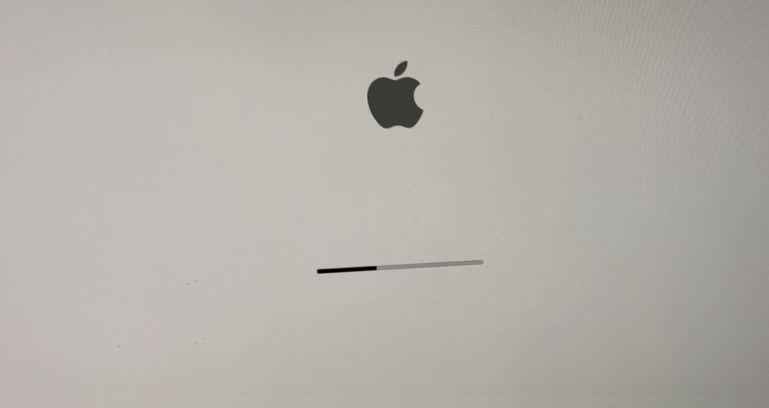

This is probably a Big Sur thing because it happens late in the boot process. Enabling the black bootscreen (which supported Macs have) would fix this annoyance.
That's because DRM on Big Sur only works by enabling "unfairgva" on a prerelease of WhateverGreen. On the next official release, I will update the wiki with the details.

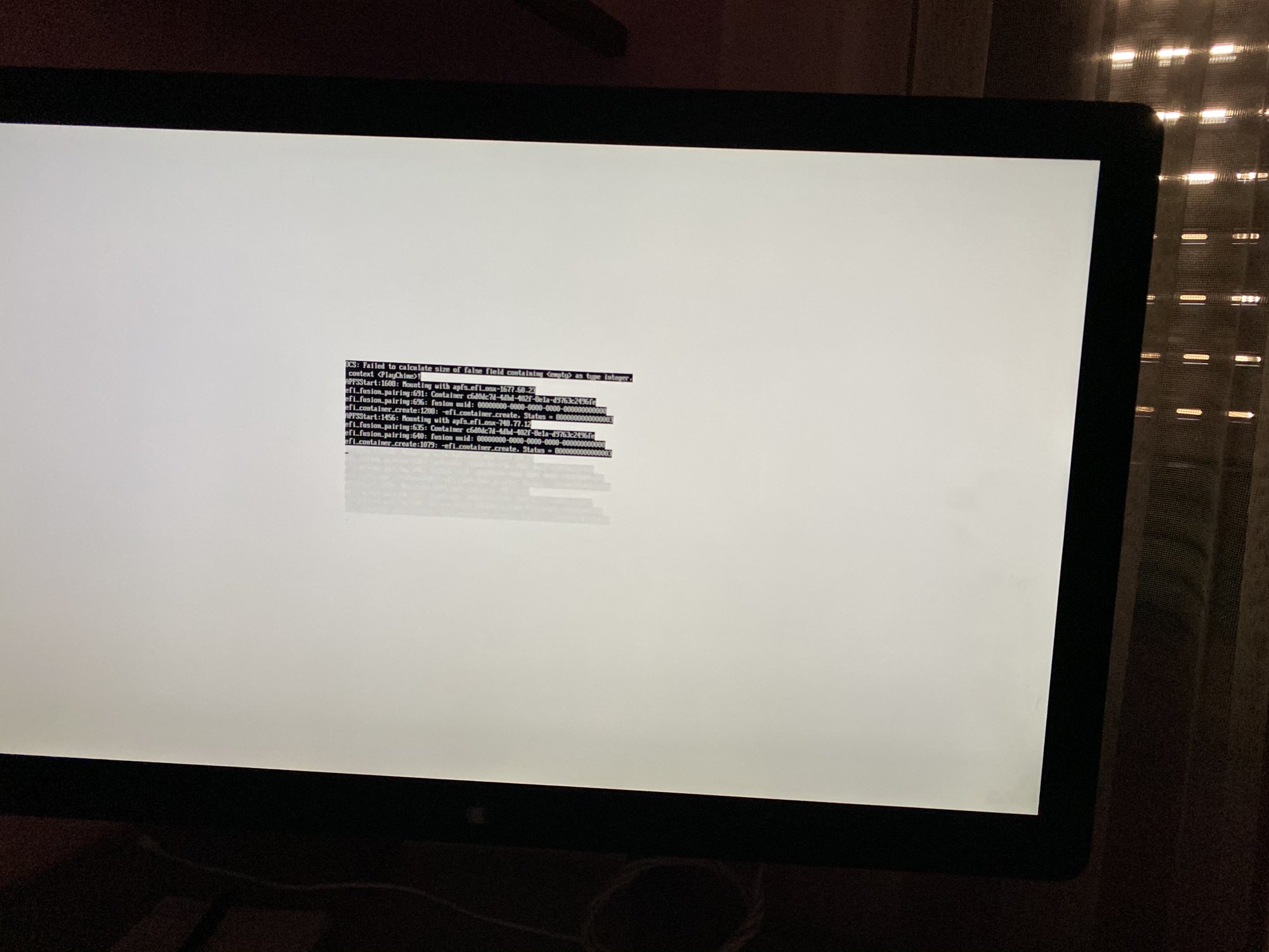

When I start up my Mac Pro 5.1, a screen as indicated below appears briefly with Opn Core, then load the OC one as in the first photo of my previous message. Depends on what? Can I not make it appear?
There are two issues here. First, "PlayChime" should be configured as
Code:
<key>PlayChime</key>
<string>Disabled</string>
rather than
Code:
<false/>
Second, the message about APFS is a well-known issue dating back to High Sierra. This annoyance happens when using a flashed graphics card.
