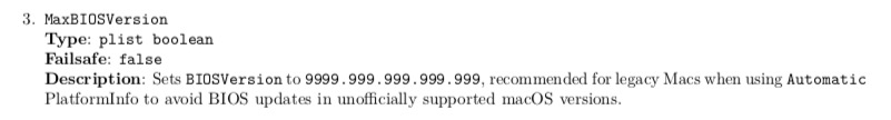

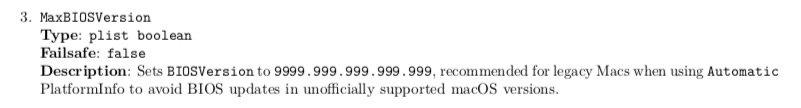

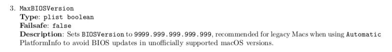

Do you think this will not work then ... or only on non-cMP:
Note that "MaxBIOSVersion" only applies to a generic (automatic, full-spoofing) platform information configuration, which we don't tend to use here.
As a precaution, I've set BIOSVersion to 9999.0.0.0.0 for use with a manual (iMac Pro board-ID hybridization) configuration.
Yes about the auto. Was just curious in general whether it would work given the observation. Presumably you think it would from your setting.
Correct.
I believe this idea is due to h9826790 and it makes sense that it should work. Right now, it's the best thing we have to prevent unwanted firmware updates in Big Sur.
Reactions: Dayo
I think it depends what you are spoofing. The bios version will match the board ID's ROM settings. So for cMP it will adjust to a 3 digit (first) and for the iMacPro1,1 and the MacPro7,1 will be different.
Don't use Generic section even with only MaxBIOSVersion set to yes, because this is the result:

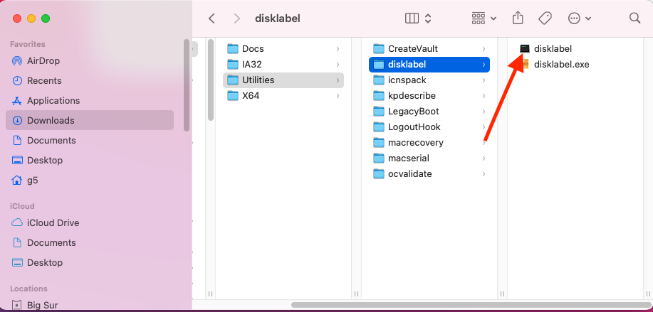

Download the OpenCore package:
1. Open terminal and type:
Code:
disklabel
disklabel: usage: One of
    -status <diskname>
    -create <diskname> [-msize=<size>] [owner-uid=<uid>] [owner-gid=<gid>] [dev-name=<name>] [owner-mode=<mode>] [other-property=<value>]
    -destroy <diskname>
    [-properties] <diskname> [owner-uid[=<uid>]] [owner-gid[=<gid>]] [dev-name[=<name>]] [owner-mode[=<mode>]] [other-property[=<value>]]
Hit Enter. You should get the result as above. That is the default Mac disk label.
2. Back in terminal type cp and drag the OpenCore disklabel, which you just downloaded inside the terminal:
after that type /usr/local/bin :
Code:
cp /Volumes/EFI/Utilities/disklabel/disklabel  /usr/local/bin
and hit Enter.
3. Open new terminal and type disklabel
you should get:
Code:
disklabel
Usage:
disklabel -d .disk_label image.ppm!
disklabel -e "Label" .disk_label .disk_label_2x
disklabel -bgra "Label" .disk_label .disk_label_2x
That is the OpenCore disklabel. Usage: disklabel -e "Label" .disk_label .disk_label_2x
Where "Label" is the desired new Volume name.
4. Run disklabel -e "Label" .disk_label .disk_label_2x after you navigated to /System/Library/CoreServices or wherever the boot files reside (if it is BOOTx64.efi or something else) inside terminal.

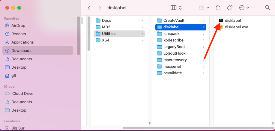

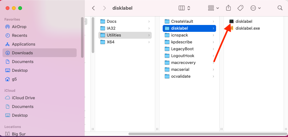

Code:
disklabel
    -status <diskname>
    -destroy <diskname>
Code:
and hit Enter.
you should get:
Code:
disklabel
Usage:

It is normal that your old name is what shows. Look here

about disklabel...
i saw it, but how the heck does the boot picker get the old volume name?
if i rename the disk on the desktop, even diskutil info /dev/diskXsX gives me the new name
