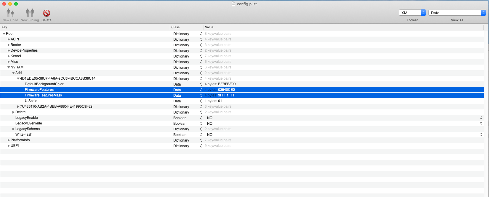

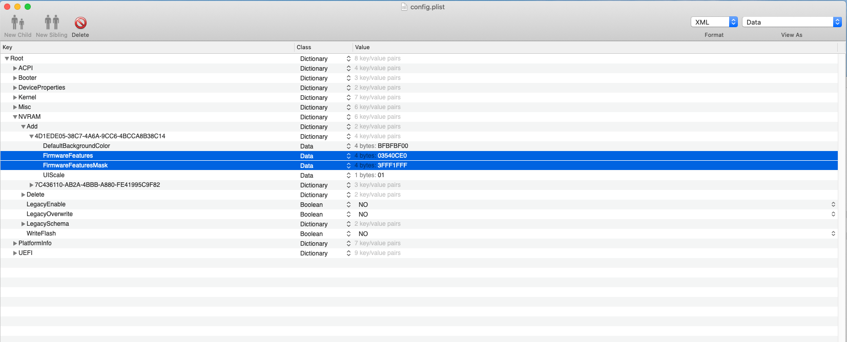

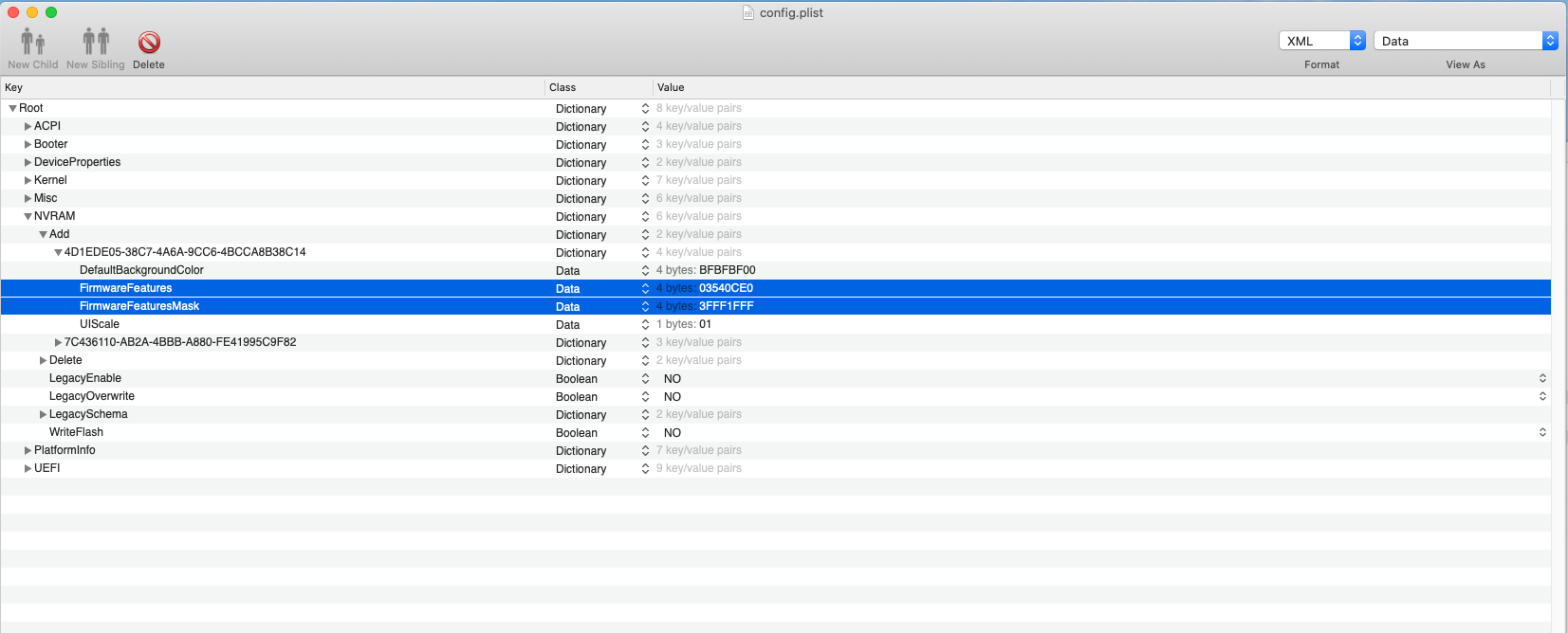

You mean no FirmwareFeatures and FirmwareFeaturesMask injection. But just board ID spoofing without VMM?
No those are still injected:
But also there is a problem with the bluetooth. It is not working. Back in Catalina it works.
It's the FirmwareFeatures and FirmwareFeaturesMask injection alleviate the requirement of VMM, not the board ID injection.
