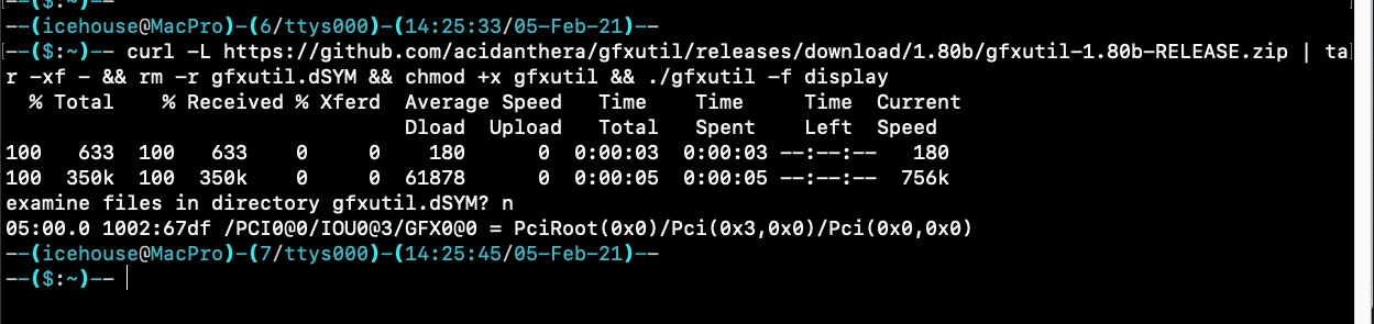

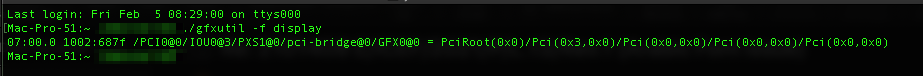

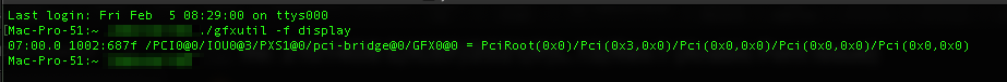

Is that I get a very long list of items and I'm unsure as to which is the Vega card.
The correct spelling is: gfxutil -f display and NOT only gfxutil
If I put in gfxutil without the "-f display" I get the same useless output.

Use gfxutil -f display
Thanks. This is the output now received:

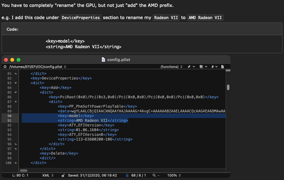

@h9826790 - going back to your previous post about changing the GPU name in OC, you said the following:
Now that I have my GPU ident of PciRoot(0x0)/Pci(0x3,0x0)/Pci(0x0,0x0)/Pci(0x0,0x0)/Pci(0x0,0x0), I'm not quite sure how to go about changing the GPU's name in config.plist especially since I'm not using the SoftPowerPlayTable kext. Can you validate if my code below would work?
Code:
</dict>
    <key>DeviceProperties</key>
    <dict>
        <key>Add</key>
        <dict>
              <key>PciRoot(0x0)/Pci(0x3,0x0)/Pci(0x0,0x0)/Pci(0x0,0x0)/Pci(0x0,0x0)</key>
              <dict>
                     <key>model</key>
                     <string>AMD Vega 64</string>
        <dict/>
        <key>Delete</key>
        <dict/>
    </dict>
I did the opencore and Im getting no boot screen. Its just a black screen as it was before. The only difference I see is that when my display finally shows something, I can see a apple logo and progress bar at 100% before it brings me to my login.

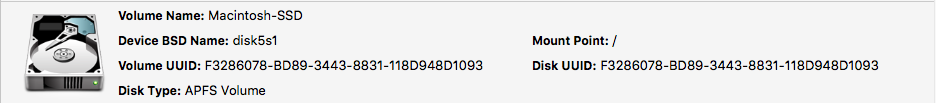

This is my drive below. I ran the Bless Drive thing and added the "Boot" and "OC" to that drive, Whats going on?

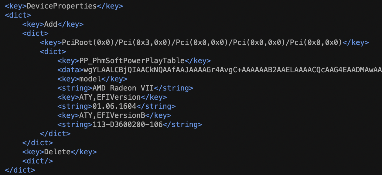

Be careful about syntax error
PowerPlay table is irrelevant.
All you need is just inject the GPU name to the correct PCIe path.

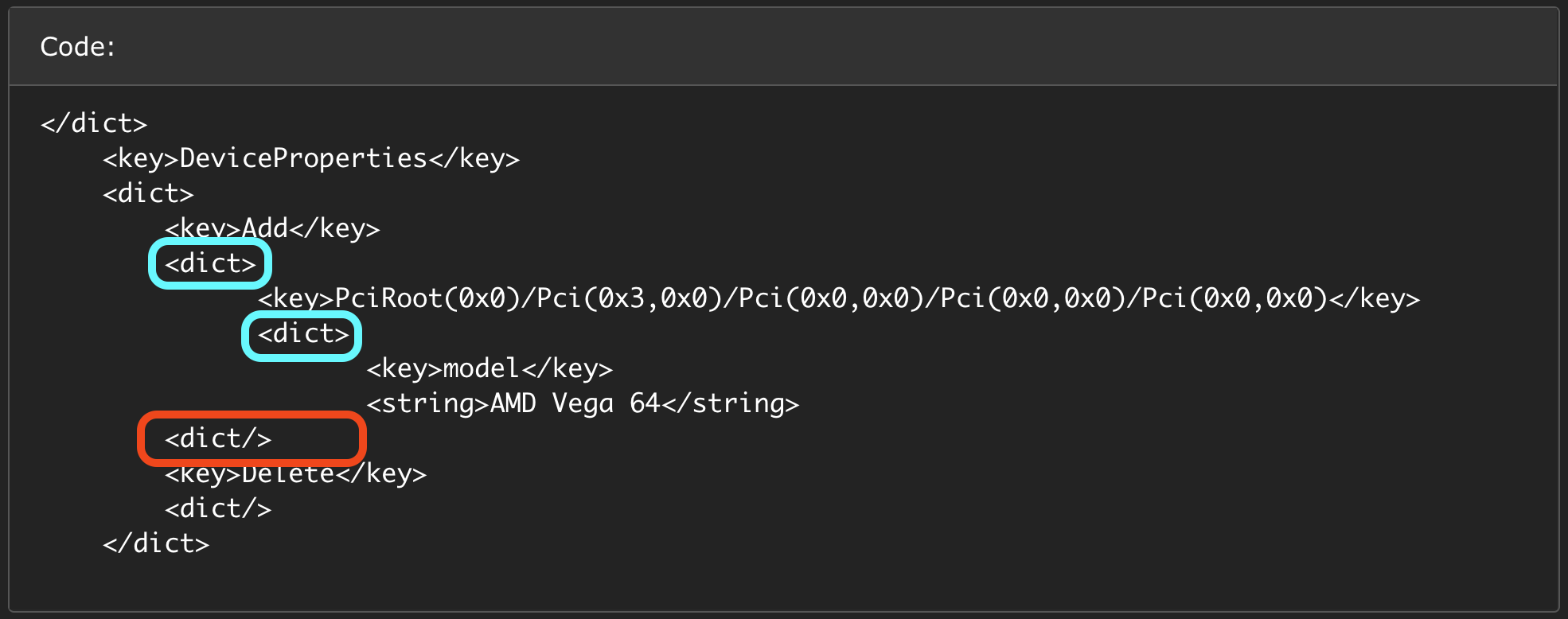

Thank you for your help and guidance. I do apologize as I am completely unfamiliar with the syntax requirements. I'd hate to bork something up, so I'd be most grateful if you could kindly review the following again just to make sure it's correct. If not, how does it have to be written?

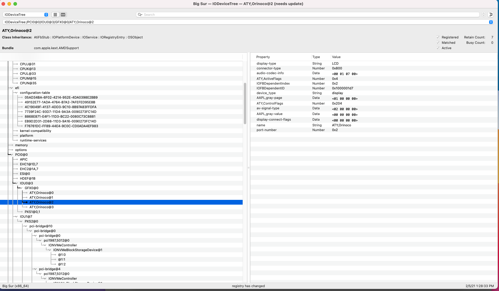

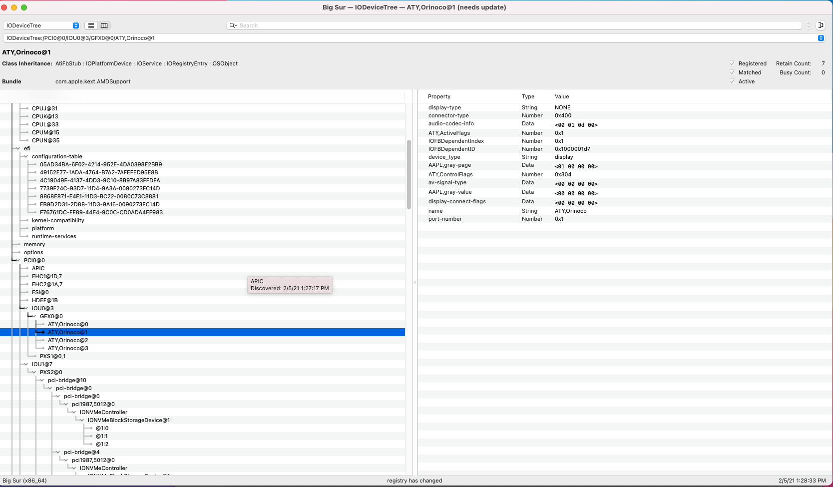

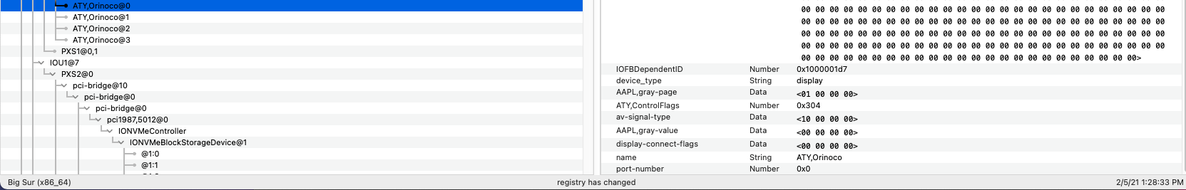

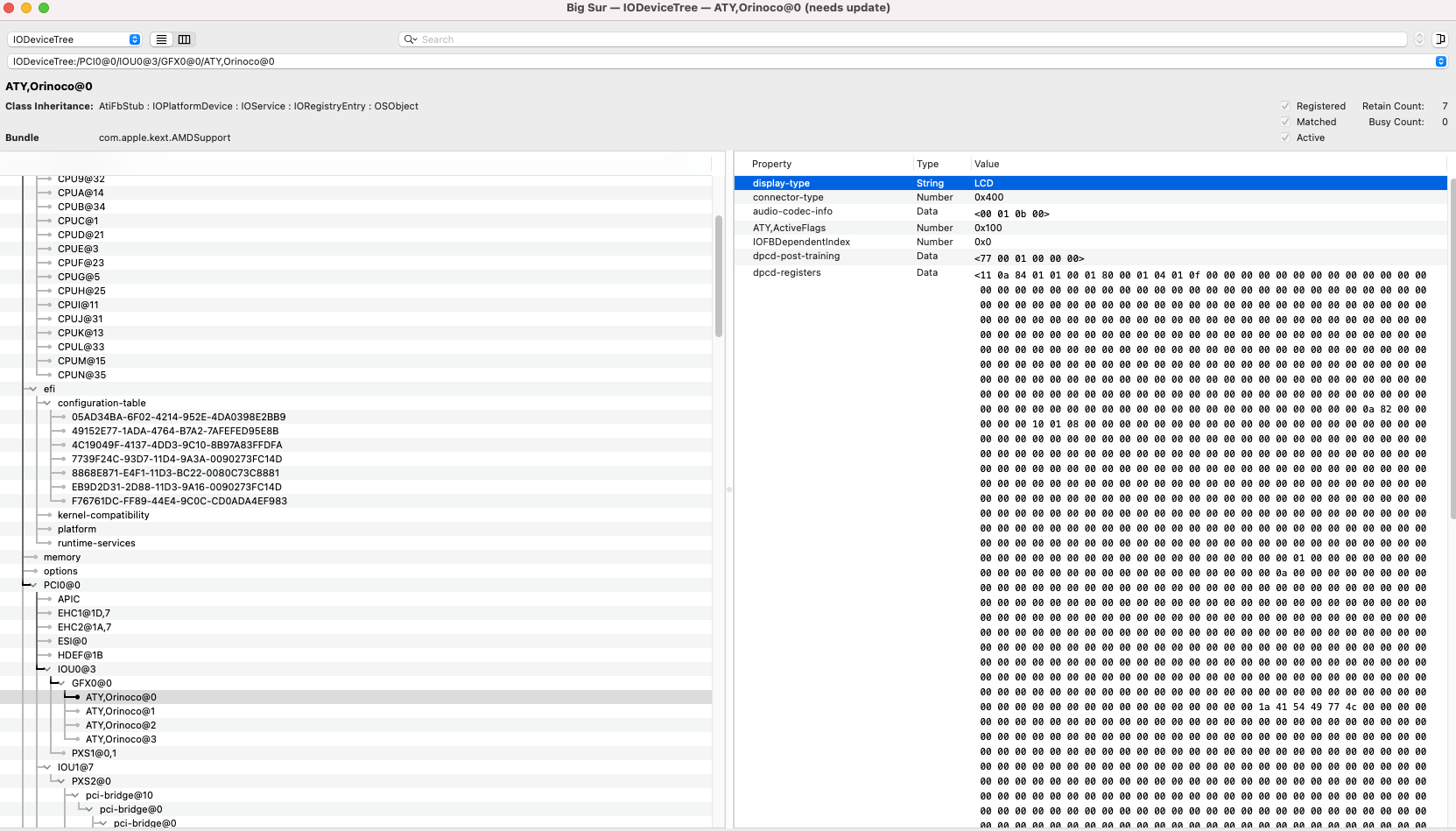

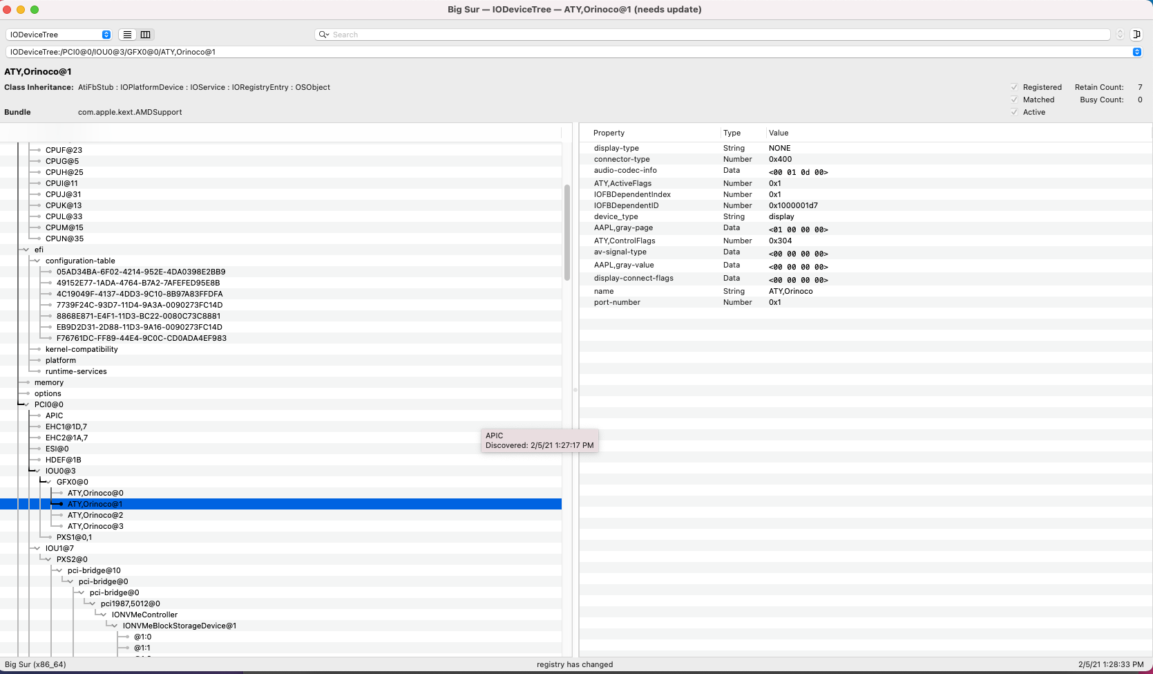

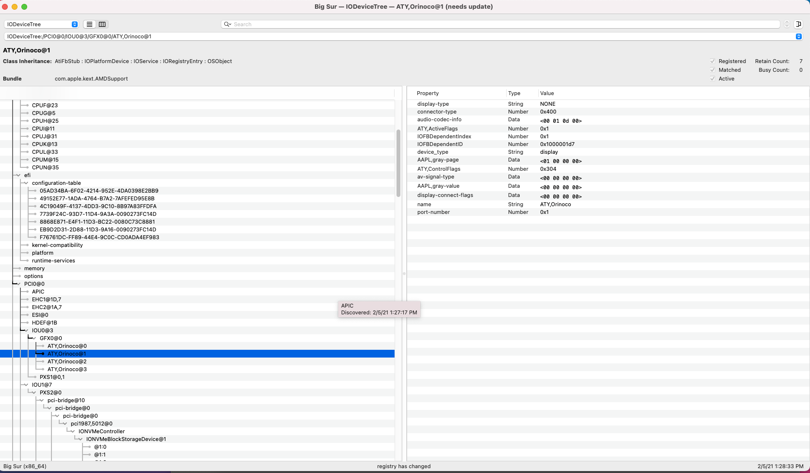

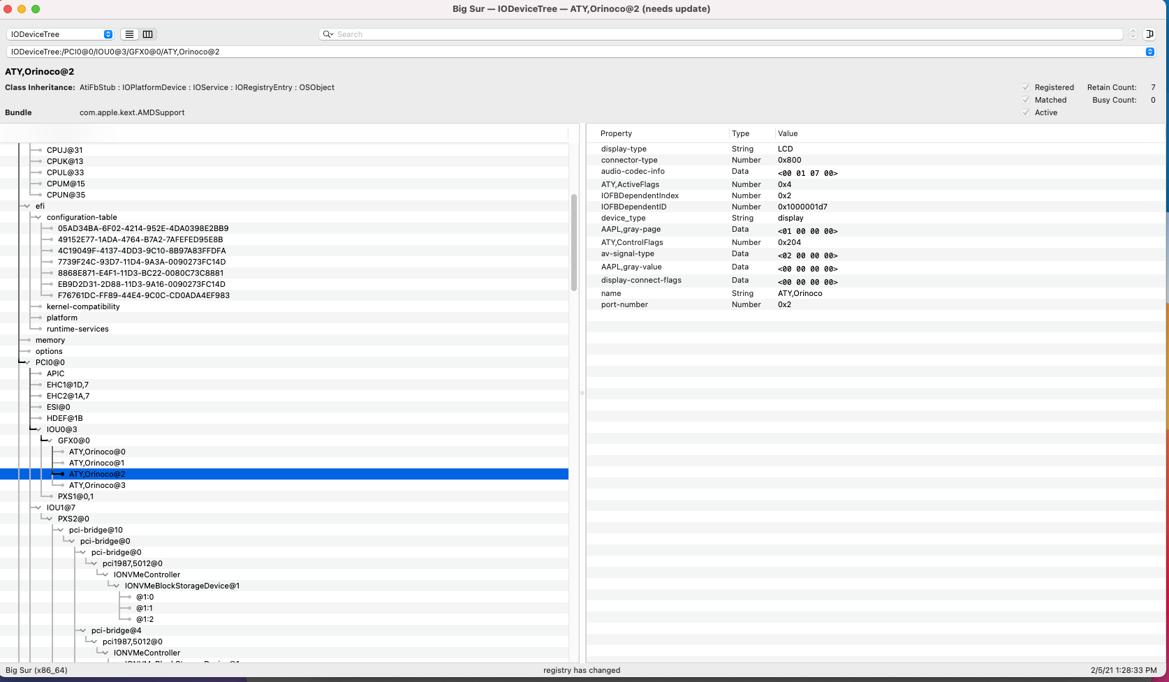

It looks like you are also affected. But just because you only need one DP, and you are using the “correct” port. Therefore, it looks like you are not affected.
If setup correctly, both DP ports should work.

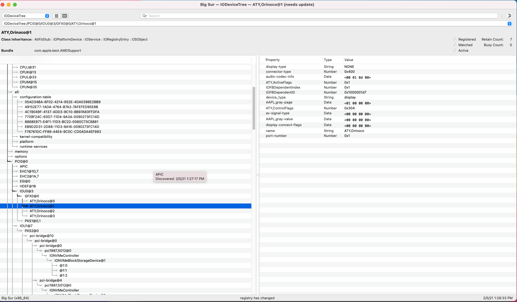

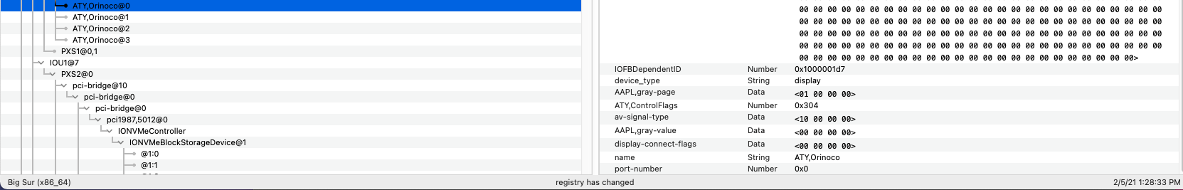

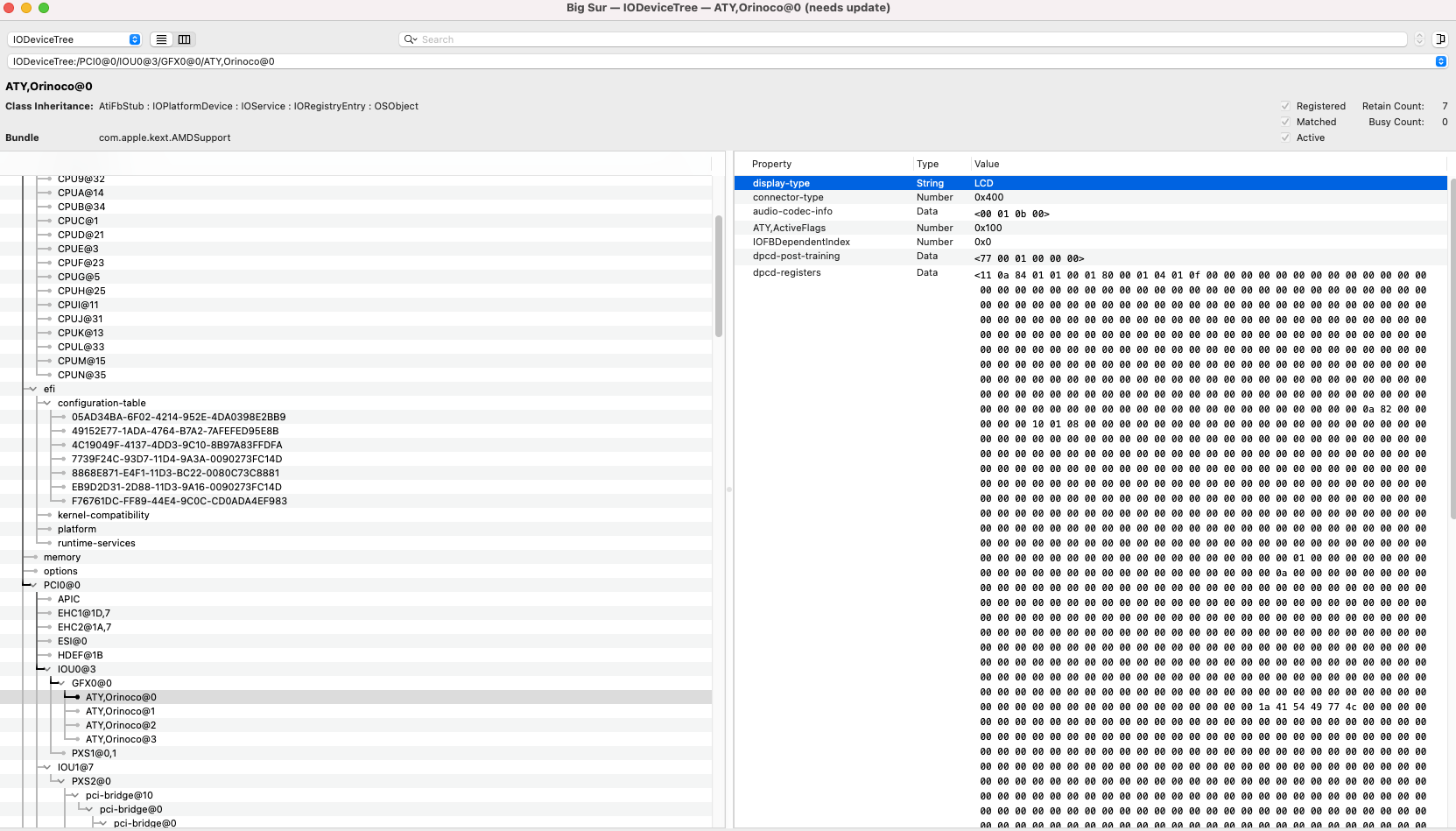

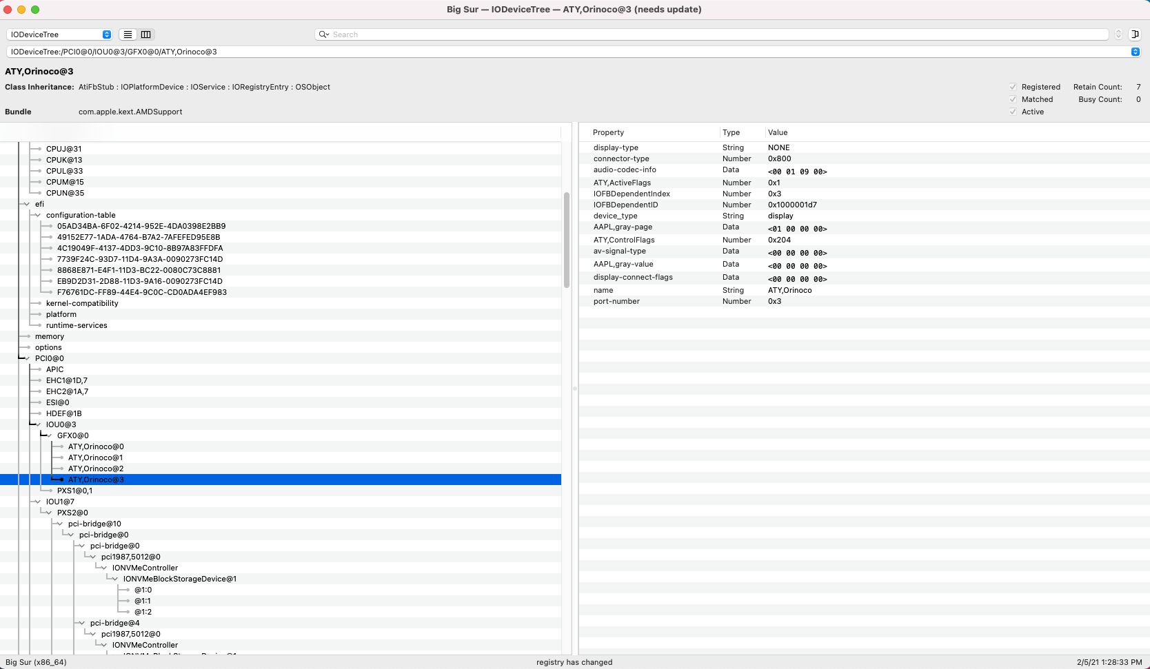

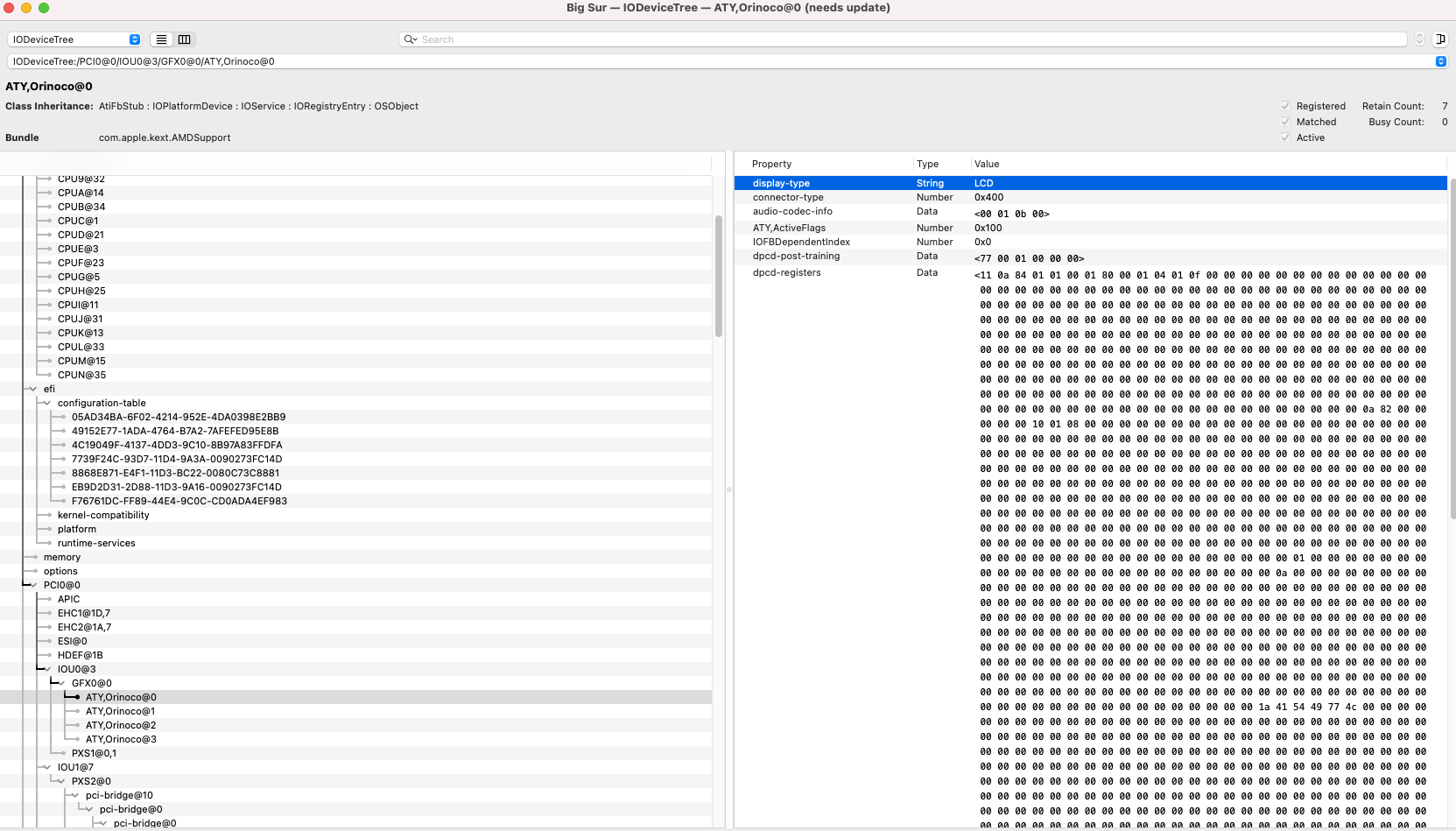

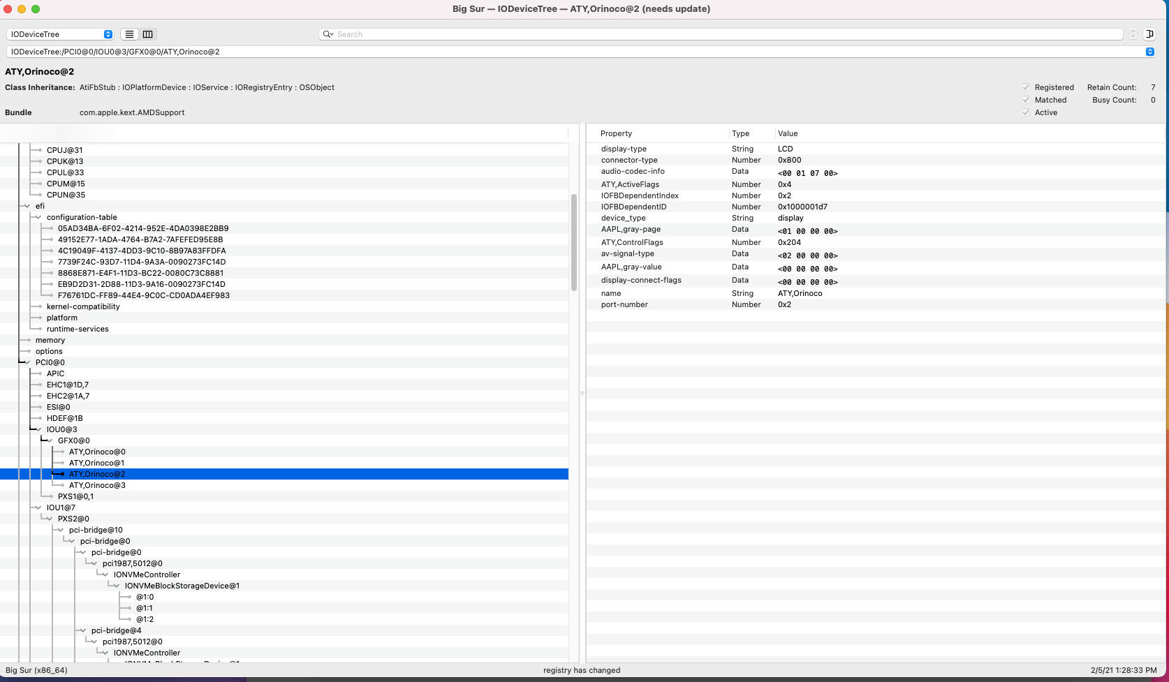

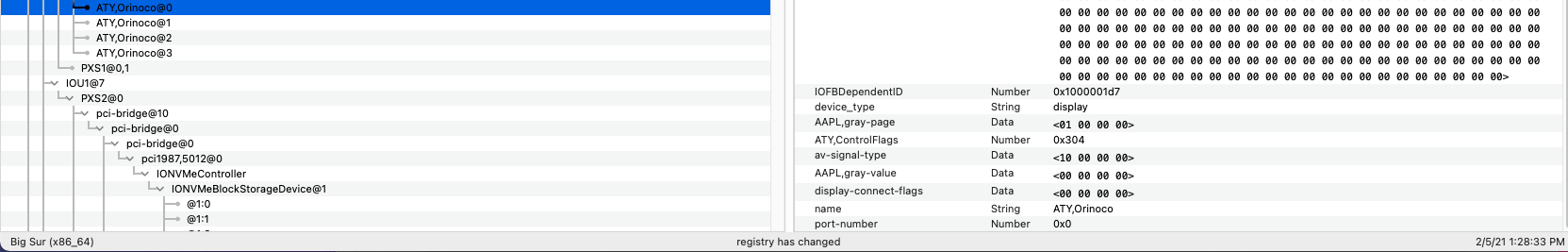

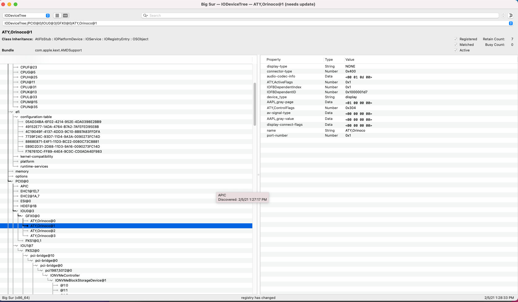

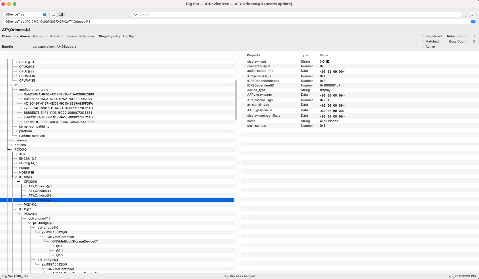

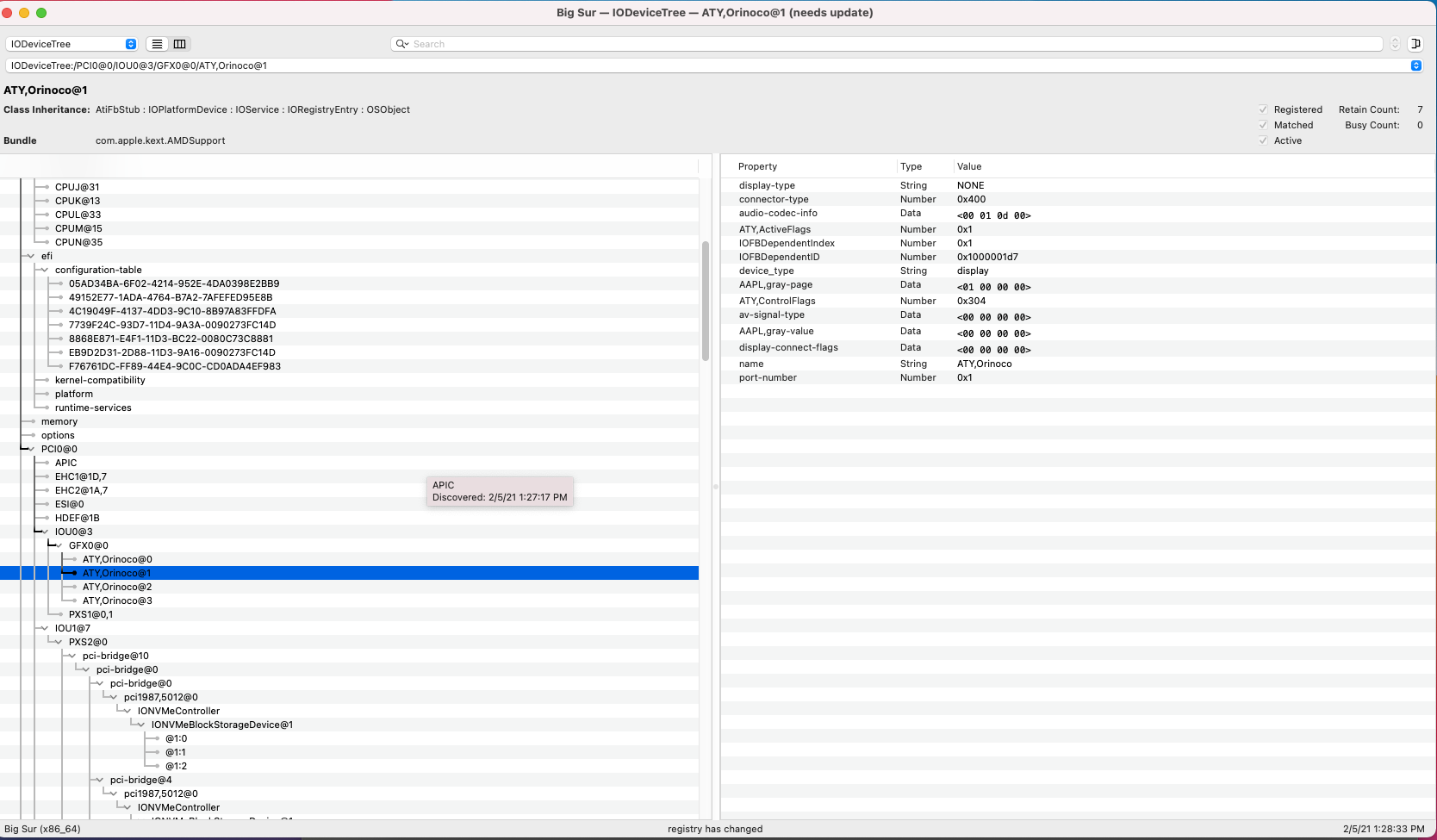

It is really strange, but all 3 ports work. Let me explain why it is strange:
As you can see:
ATY, Orinoco@0 and ATY, Orinoco@1 have connector-type 0x400 (DP)
ATY, Orinoco@2 and ATY, Orinoco@3 have connector-type 0x800 (HDMI)
Second and 3rd port always connect my second display to ATY, Orinoco@2 while switching, which is set to be an HDMI, but in reality it is a DP. So the screens work with all 3 DP (and the HDMI). At boot time they also work, but I have to mention I am chain loading OC from RP.
Code:
    <dict>
        <key>Add</key>
        <dict>
              <key>model</key>
        <dict/>
        <key>Delete</key>
        <dict/>
    </dict>

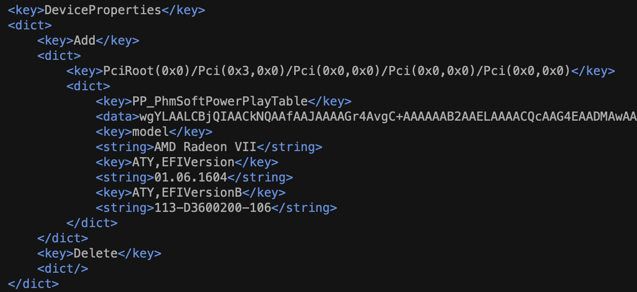

I wish you can learn this. So, please try again.

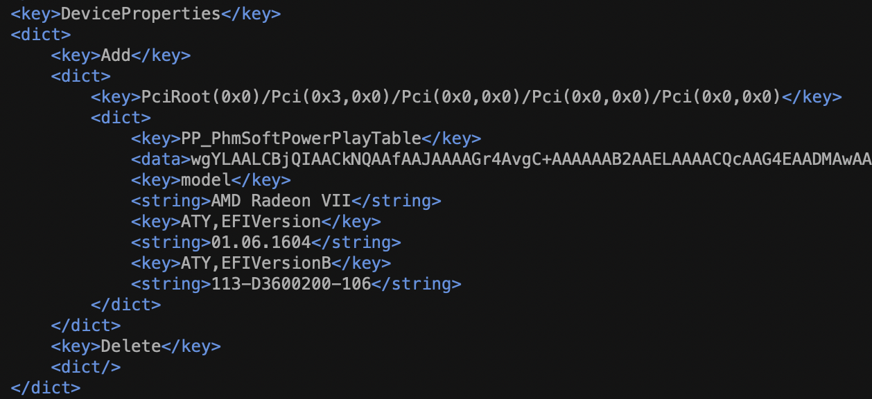

My code looks like this.
Hint 1: There are three dict in my code, but only two in yours.
Hint 2: <dict/> isn't the proper way to close a dict
As you can see:
I see, you force Orinoco framebuffer on a non PULSE RX580 that has different port layout.
In general, that's not a good idea. And often cause trouble more than benefit. But if this works better for you, then it's fine.
Thank you. I do believe I understand it now. I was getting thrown off with the <dict/> tag below <key>Delete</key>.
What does <dict> mean or signify anyway?
You need to open a Dictionary under the PCIe device, put all the required keys and strings inside the Dictionary, and close the Dictionary properly.
Similarly, you have to open a Dictionary under Add, put the PCIe device inside that Dictionary, and close it properly.
Similarly, you and to open a Dictionary under Add, put the PCIe device inside that Dictionary, and close it properly.
