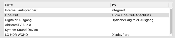

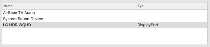

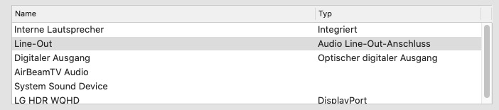

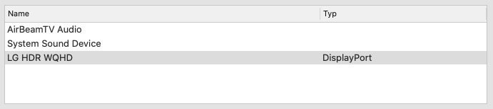

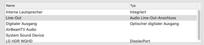

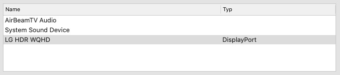

Hi Martin,
I try today your new 0.6.6 OpenCore package with the actual Build of 10.15.7 - all works so far but I lost my audio output and I have no idea what happen.
This is your opencore 0.6.5 package:
This is your opencore 0.6.6 package:
Internal Speaker, Line-Out and Digital-Out are gone.
Any idea? Let me know if I can help with any information.
Hi Martin,
If you downgrade back to 0.6.5, then all audio options come back straight away?
Mea culpa - mea maxima culpa.
I take everything back and claim the opposite. Note: If you read a lot, you can make a lot of mistakes.
I just wanted to reactivate my graphics card name in your package and have modified the corresponding places (DeviceProperties). Unfortunately, when looking through the config.plist, I found the entry <DeviceProperties> true / false in the <ProtocolOverrides> and "thought" it must also be activated. That was my fault. I have now set this value back to <false> and have my graphics card name and my audio ports are active again.
Much smoke about nothing ... sorry.

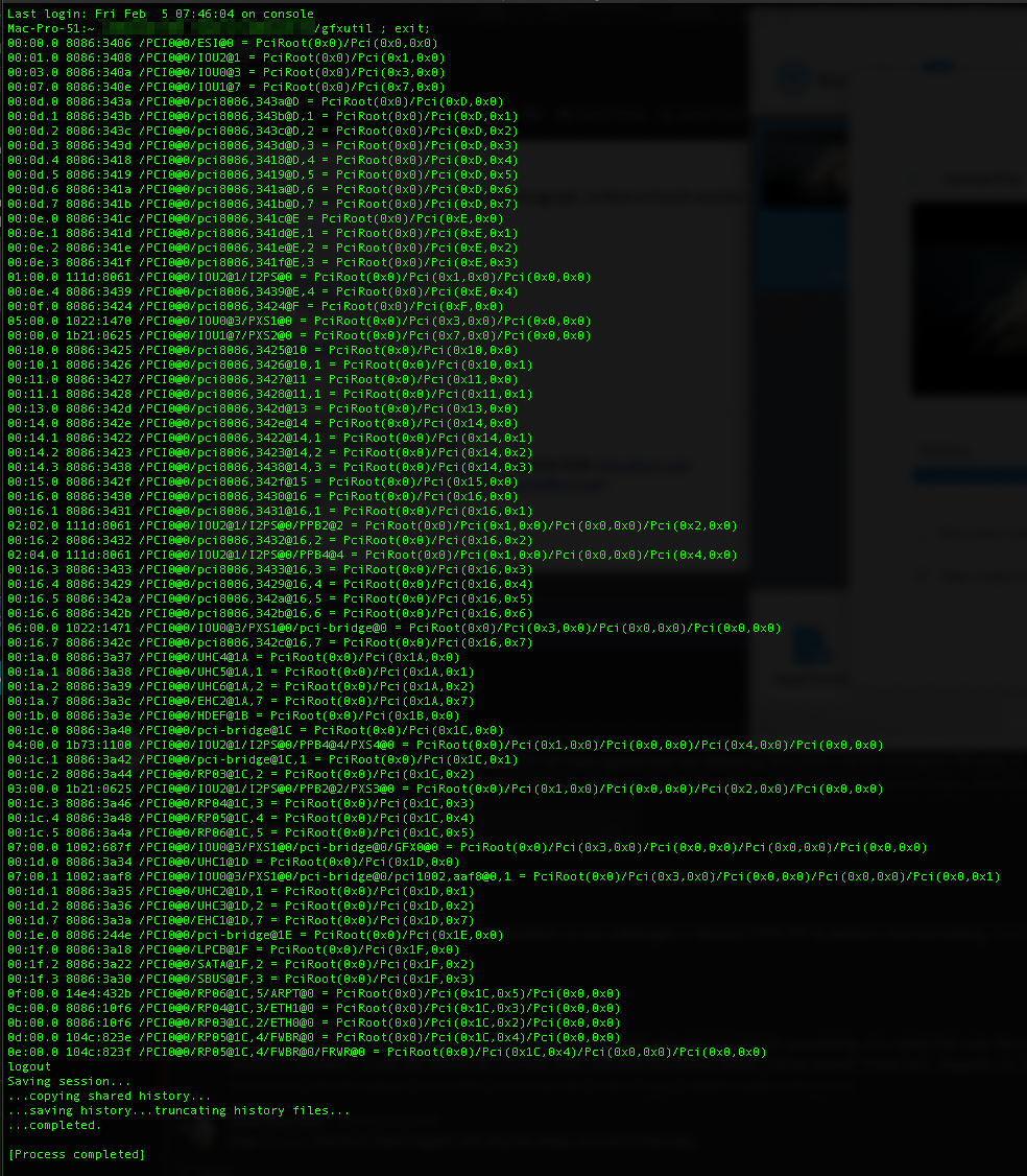

Now the problem I'm running into after following these instructions:
To obtain the path of your graphics card:
An executable, gfxutil, will appear in your home folder and you should see the path in terminal (after taking note of the path, you can delete gfxutil).
Is that I get a very long list of items and I'm unsure as to which is the Vega card.
Use gfxutil -f display
