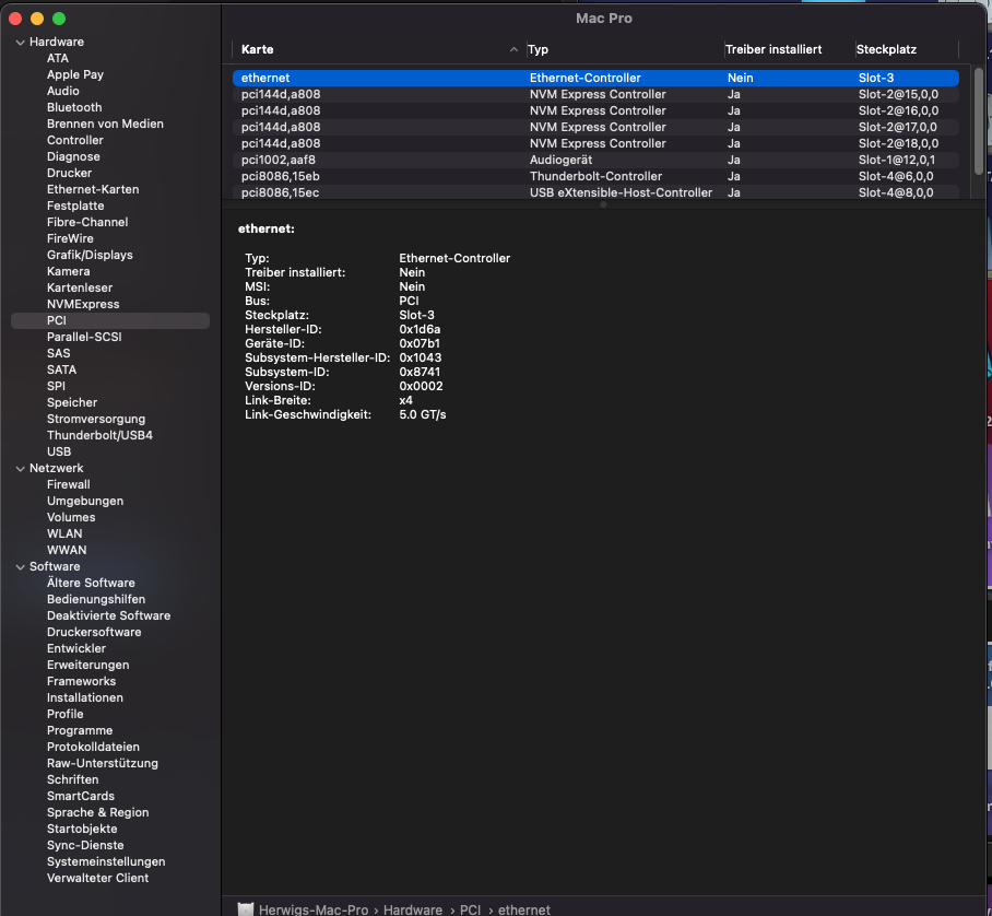

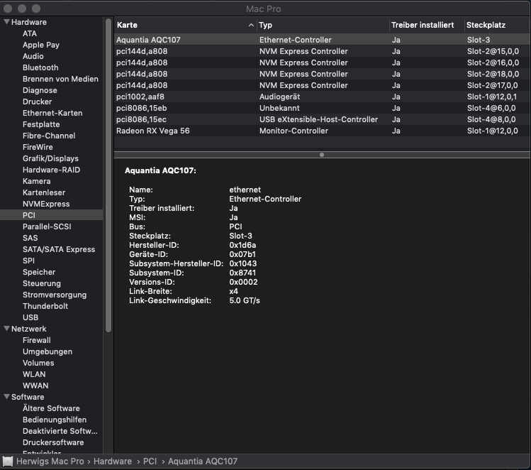

Hi I update on my Mac Pro 4.1 Catalina > Big Sure normally with Cpu Flag OC 0.6.6 all is running fine only my 10 GB Networkcard not functional
can do this with OC ? The Networkcard is a Asus XG-C100C with Mojave and Catalina no Problem on Big Sure now no driver installed.
on Mojave or Catalina the Card works
see
THX for help

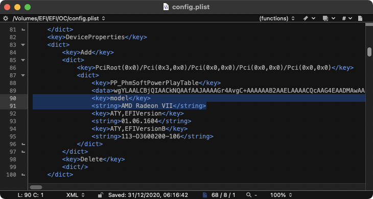

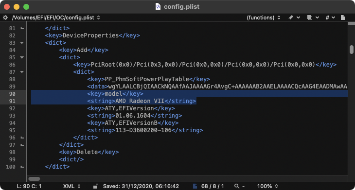

You have to completely "rename" the GPU, but not just "add" the AMD prefix.
e.g. I add this code under DeviceProperties section to rename my Radeon VII to AMD Radeon VII
Code:
                <key>model</key>
                <string>AMD Radeon VII</string>
How can I ident my Vega 64 in OC v0.6.6 without SoftPowerPlayTable being injected? I just need to properly identify my GPU for VideoProc. My config.plist looks like this presently:

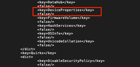

Cleaned up the errors with the exception of the missing keys, changed my spoofing to Mac Pro 7,1 and everything looks good. This should look much better.
Thanks for everyone's help.
