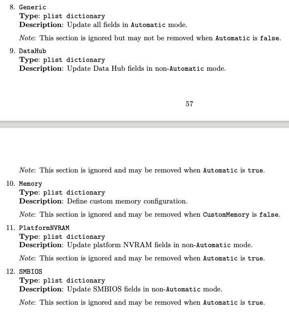

Until a novice adds ONLY one property custom key/value and ocvalidate shoots a ton of errors about the missing properties.
It is currently academic, since like I admitted, I got it completely backwards and you guys (on Automatic=false) are NOT allowed to remove these sections anyway!
For someone on Automatic=true (where the sections optionally, but officially, can be left out) (or, perhaps, for the Memory section, which has a separate rule and can be left out if CustomMemory is false) perhaps the decision is moot - I mean OC thought so, enough to make the sections officially optional in those circumstances, with clarification to confirm it. But I can certainly see the sense in the view you are taking, I must say. There is much greater added convenience for the more experimental user if all the properties are there already! Thank you.
@Bmju With CustomMemory=False, Memory property keys are ignored, regardless you have them present or not. However, there is a different story when you set CustomMemory=True.
Also, from a developer perspective, I would not set Automatic=True on a Mac because I want to use the OEM values, not Generic values.
I agree with the first.
I'd still like to try to point out, again, what seems like it must be a misapprehension behind the second: you can have auto-detected, OEM values with Automatic=true. Read the OC docs, even if you don't believe it just from me! I'm not therefore suggesting that all projects immediately change to Automatic=true, and I *agree* with you about the undesirability of faked serial numbers. "Because it's used for fake values in the Hackintosh community" is not the same was "it can only be used to fake values". Honestly!
Yes, but only since very recently. Please give people the chance to adjust.

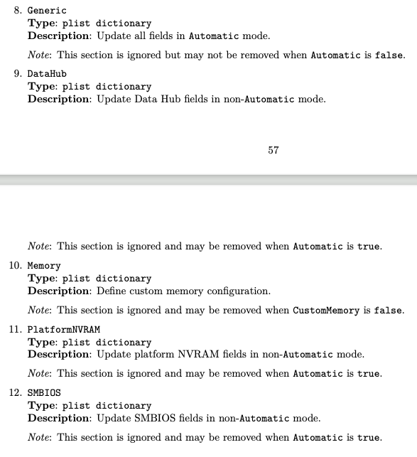

I may be wrong but my understanding is that @TECK design goal is to, more or less, automate the production of the config in Post 1. If that understanding is correct, then unless @cdf changes the config, @TECK is not going to be straying away from that.
The config changes about one a month.
Reactions: Bmju

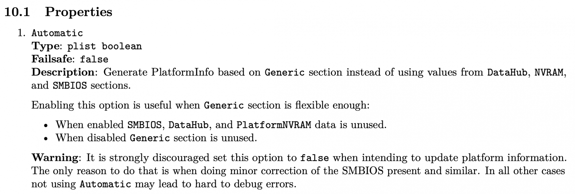

This is from latest master branch:
The Warning is clear, set it to False while doing minor corrections of SMBIOS, like we do, therefore I'm leaving the property set to False.
