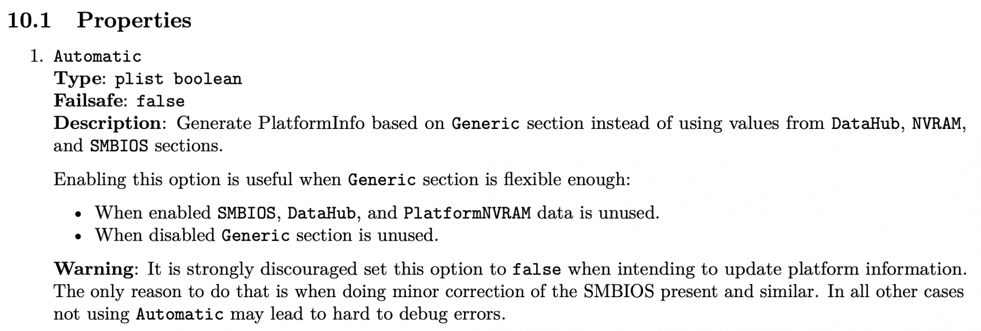

This is from latest master branch:
The Warning is clear, set it to False while doing minor corrections of SMBIOS, like we do, therefore I'm leaving the property set to False.
I'm completely re-editing this reply, as I was in large part mis-reading the OC warning here. Sorry! But I still think the doc is consistent with what I'm suggesting is a valid alternative. Yes, the doc as I understand it warns you NOT to set Automatic to false, unless you are only doing minor updates, in which case you can. But I don't think it says that when you are doing minor updates, you should choose to set it false, just that you can.
I strongly believe that this documentation exactly says that you *can*
Feel free to experiment with a Mac Pro 5,1 and report back the findings, thank you for looking into this and help the community.

... from a developer perspective, I would not set Automatic=True on a Mac because I want to use the OEM values, not Generic values.
As regards 'generic' defaults, @TECK, I've now realised that you were most likely referring to OPENCORE_SN1 and OPENCORE_MLB_SN11.
I totally agree that those values are undesirable.
But there is an important wrinkle here.
These values only ever appeared for specifically missing config values. Really non-obviously and quite bizarrely, present but empty config values for these always gave OEM defaults. This has now, only recently, been made consistent, in favour of OEM defaults.
But, @cdf, this always meant that a Generic section with empty values present for these fields, where it mattered, has *always* been able to do a clean hybrid fake with Automatic=true. I know this, because I've been using (and then slowly experimenting with) a config which did this exactly for at least three or four months.
Also, I'm coming from a background where *this* was the only way that I knew how to do things, so (I agree!) I'm having to catch up, too!
