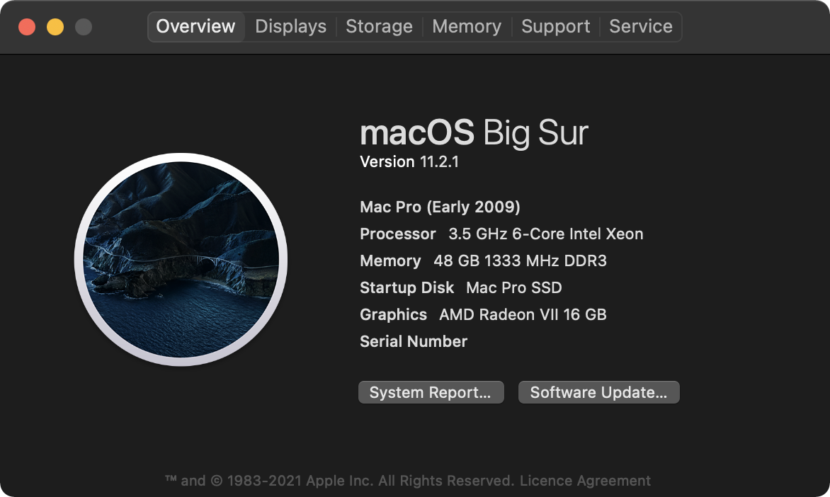

From my own experience, it's actually better to ProcessorType=1281 in the config.
When the OS that can correctly ident the Xeon, which same as no effect.
But for some reasons, without this ProcessorType "spoofing", some Xeon will ident as i3. Then this ProcessorType injection can help to show the correct CPU ident.
