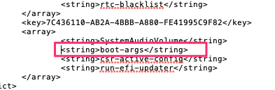

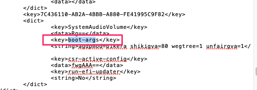

Actually, best to set verbose mode in OC instead of RP since test is for OC.
Add "-v" to the boot-args in OC.
There are two boot-args entries in config.plist. I assume the key should be modified as such: <key>boot-args-v</key>?
Here:

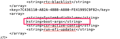

What about <string>boot-args</string> here:

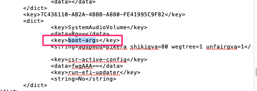

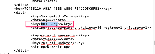

Here:

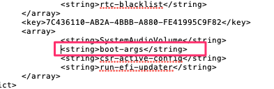

There is only one boot argument injected. The 2nd one is to tell OpenCore to block the original boot argument.
If you want to add the -v, you can add that after unfairgva=1

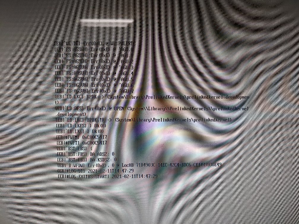

Ok, did that and now I get verbose output during 1st stage of the boot loader.
EDIT: forgot to attach logs.

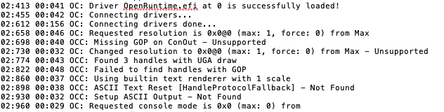

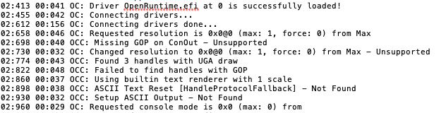

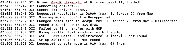

@cdf @h9826790 @startergo
Just having a closer look at my logs, and these entries stand out. Not knowing enough about OC to determine what's happening, could these possibly indicate to you why I'm not getting the 1st stage boot screen on my Mac EFI flashed 7950?

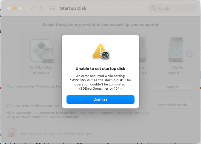

@cdf any changes improvements to the Windows10 install procedure? I did not booted for a while into Windows, this afternoon when I selected the Windows disk, I was presented with the blue Windows logo, frozen. as it happened many times before. There is nothing I can do, except the shut down the Mac.
Also, I cannot set anymore Windows as Startup disk:

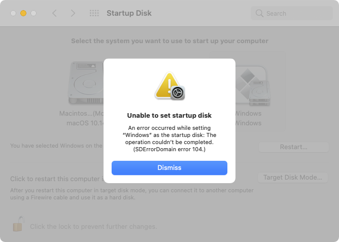

Same situation here. We'll have to look into this...

I boot normally. I must add I chainload from RP if that makes a difference and I am on one of the latest commits.
That was through the boot picker. Startup disk presents an error:
The only one that's perhaps significant is the ASCII Output not being found.
This is the text renderer which only works on GOP Units. Might be that it impacts the Stage 1 screen but not sure as it should have been the same with RP if so as it uses the same protocols.
Might be that UGA units do not show this in OC. Perhaps someone can confirm this.
Ultimately, I think you need to raise an issue on the project.
