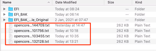

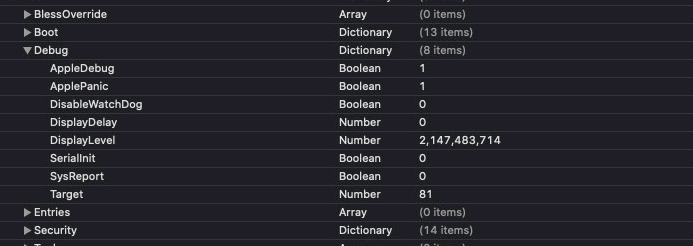

I've turned on debugging but can't seem to find the output log file in any of the EFI directories. I was hoping to generate this before uploading a bug report in GitHub. This is what I have set in OC config.plist:
For target, I used the following:
0x01 - enable logging
0x10 - enable UEFI variable logging
0x40 - enable logging to file
Converting to decimal gives me 81 but can't find the file anywhere. I even went to /var/log to see if perhaps it was placed there, but no luck.
OC boot log shows it's actually logging.
Those are all Apple generated entries, shown in the OC bootlog because /Misc/Debug/AppleDebug=true.

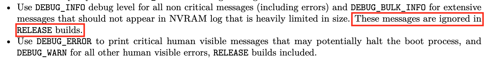

You've probably already set /Misc/Debug/DisplayLevel=2147483714 (= 0x80000042)? (EDIT: Actually, I can see that you have, in your screenshot.) You definitely have set /Misc/Debug/Target to include file output.
The piece of the puzzle I think you might be missing, in order to see more OC log output, is to be using the DEBUG build of OC? :)

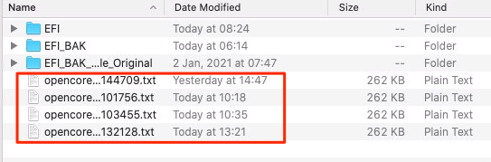

I was thinking that the OC text files located in EFI root can't be the only logs generated when logging is turned on. I was under the assumption that perhaps other logs were being generated somewhere else, but apparently I was mistaken.
So based on what you're saying, perhaps the reason the logs aren't more in-depth is because I'm not running a debug build of OpenCore? Again, I don't know enough about OC's intricacies and nuances to know if what I'm saying is accurate, but I'm slowly learning as I go. And in case I don't say it enough, I am extremely grateful to all who have patiently helped me.
Reactions: Bmju
You might be on to something here.
That's right. You can just download the DEBUG build and copy the entire /X64/EFI directory into wherever your OC /EFI folder is now - without deleting anything first. That won't overwrite your config.plist (as the distributions don't have a file there) and should just work, without you having to redo all steps!

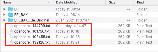

Don't get yourself muddled up at this point.
Those logs, if switched using MyBootMgr, are as indepth as you will get from OC as based on debug builds etc.
The app is designed to set things up as needed. There is no action needed on your part.
You are overthinking the whole thing and more likely to stumble the further you continue.
Just pick them up and run with it for your purpose which I believe is to raise a bug report.
If not indepth enough, the developer will let you know.

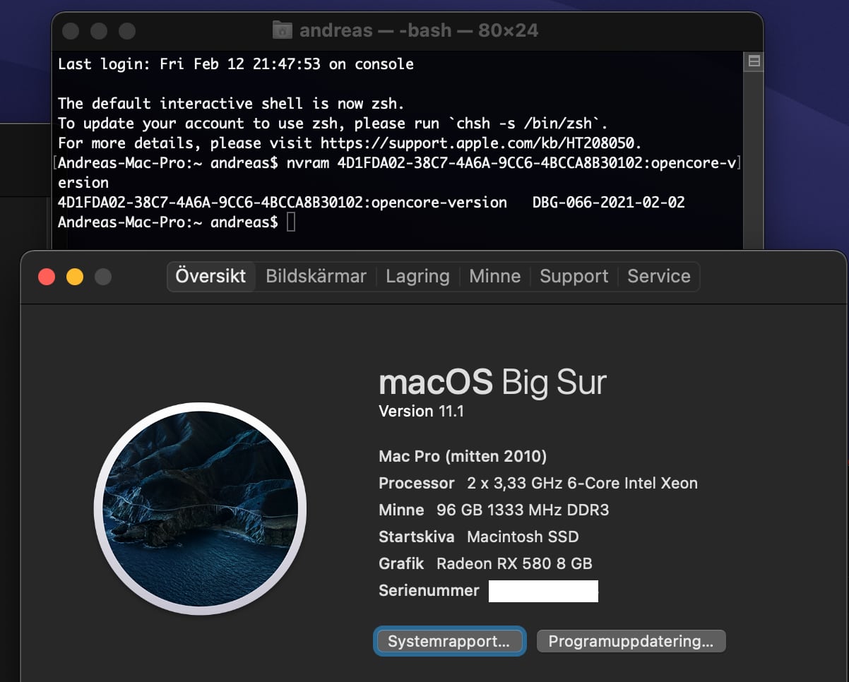

I'm seemingly getting kernel panics when trying to boot with OpenCore and SMBIOS info added. Without it (That is, default config file) it boots fine.
Tried VMM on and off, default SMBIOS from page 1, and other boardID (MP 7.1?), with or without Firmware-thingies, no difference.
If I change SMBIOS in any way I seem to get stuck in a boot loop with it crashing. I never even get a picture.
I'm doing this to be able to upgrade to 11.2.1. Weirdly enough I was able to update to 11.1 with older OC and other config. Sadly, those are not available anymore.
It's no big thing, but perhaps you smarter people might be able to see what's wrong :)
Specs below (this is booting OC with default config)
