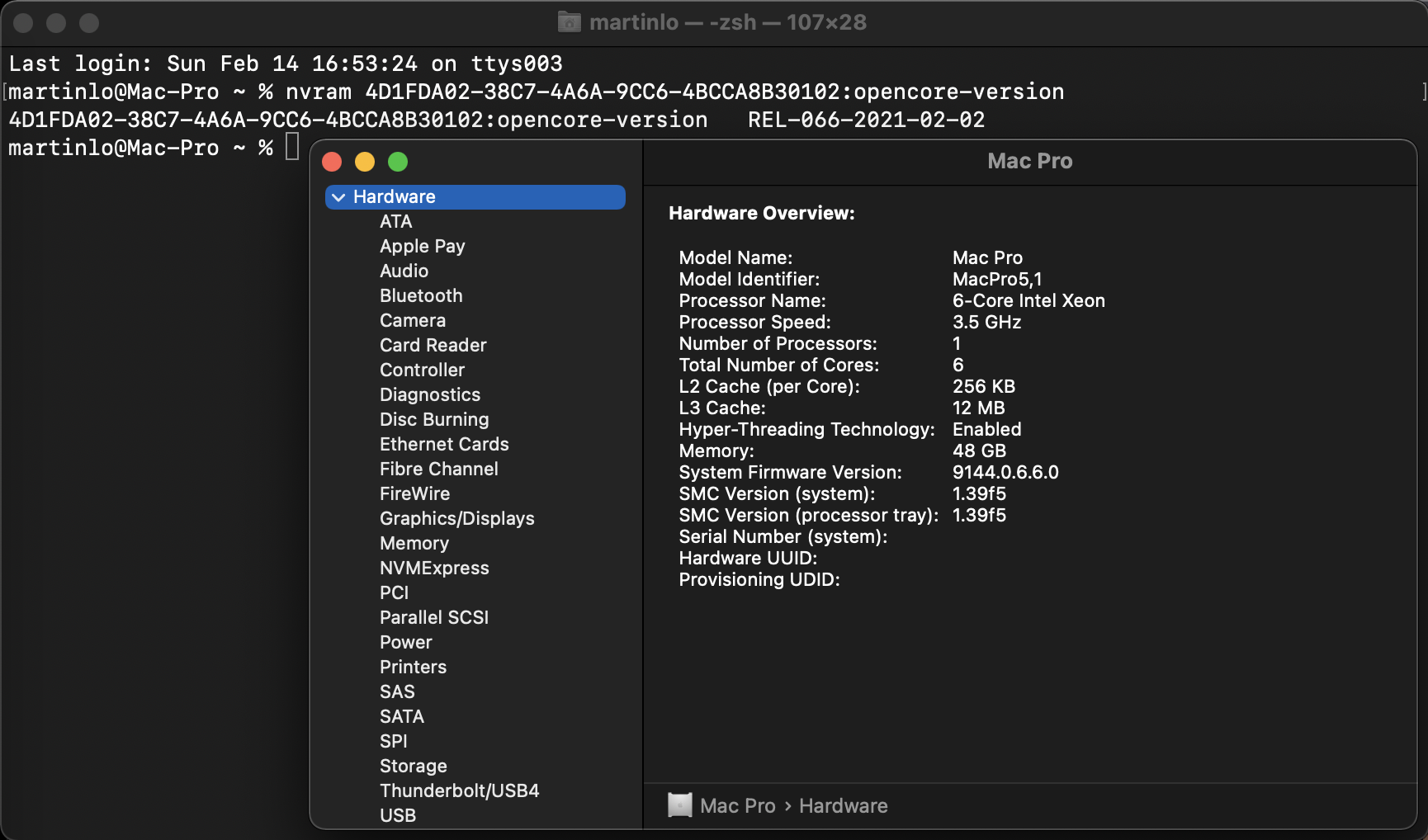

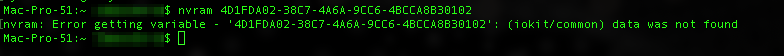

Sorry if my question is silly, but when I try to check my Opencore Version in terminal, I get this:

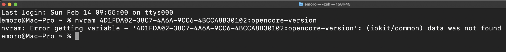

The same thing happened to me recently. I could no longer read the opencore-version nvram variable, even if ExposeSensitiveData was properly set.
When I booted natively into Mojave to diagnose the issue, I realized that something was wrong with the NVRAM. Perhaps it was just a coincidence, but I could no longer bless other volumes. I did a 4-time NVRAM reset, which finally allowed me to boot into recovery. I disabled SIP, rebooted and promptly restored a clean backup of my BootROM. Afterwards, everything was fine.
We've been warned many times by @tsialex about the eventual fate of the SPI flash memory. If you haven't done so already, back up your BootROM! I also have a replacement chip ready to go.

I have tried to set ExposeSensitiveData but that doesn't change the issue. In fact I had never changed it. It Always set as basic config.plst from #1
Should I be worried?
Thanks!
edited 17:55: I fixed the issue reflashing my BootROM using the reconstruction made by @tsialex.
ExposeSensitiveData is in 3 (default) and I can check my Opencore Version

You may dump out the BootROM now and have a check.
It's been tested that we can dump / flash the cMP's BootROM even boot via OpenCore.
Or, for diagnostic purpose, you may try temporarily boot via my OpenCore package. Which is known that can read the OpenCore version. Since it's a complete package for 5,1. As long as you don't mod anything, there should be no room for user error, and able to provide accurate test result.
For your info, if you boot from my latest 0.6.6 package. You should see your BootROM version change to 9144.0.6.6.0. This is a sign that you switched to my OpenCore package. Then you can try if you can check the OpenCore version in terminal.
If everything works as expected, you should see something like this.
Thanks!
See post by @startergo above yours.
Dump your current BootROM, reboot and do a Triple NVRAM Reset (Four Chimes) and dump the BootROM again.
Run the script on both versions and see if there is noticeable difference.

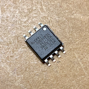

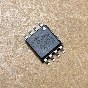

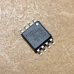

ROMTool identified my 2010 MP5,1 SPI flash chip as MX25L3206E. It stated though that it could be wrong and should be identified manually. Where is it located on the board?
U8700. See here:
Reactions: Enricote
U8700. See here:
Thank you! Looks like I have MX25L3205D.

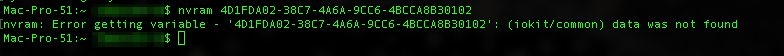

BTW, same issue here:

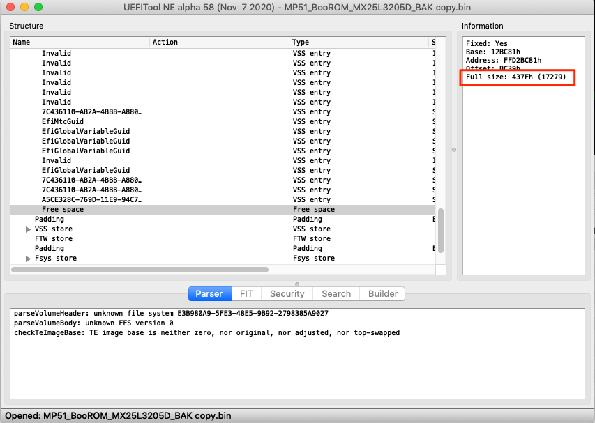

There is a extremely simple way (simple here as in not need to know how the NVRAM works/check free space indicators/validate checksums and etc) to check if the garbage collection failed and the need to reflash with the clean dump:
A clean reconstructed never booted image have the Free Space Full Size as 65448 - this is for a fully empty store:
A normal working single CPU Mac Pro with 3 DIMMs have the Free Space Full Size usually around 45000 to 40000 - this is for a healthy working dump:
A normal working dual CPU Mac Pro with 8 DIMMs (DIMM configuration data and SPD caches stored by MemoryConfig NVRAM entries are what takes the most space inside the VSS store) have the Free space Full size around 35000 to 30000 - this is for a healthy working dump:
A Mac Pro that the garbage collection is not working anymore will have less than 1/3 of Free Space Full Size available, less than 22000 bytes available. Any less than this and you usually start having problems.
This one has just 8921 and already corrupted the NVRAM volume:

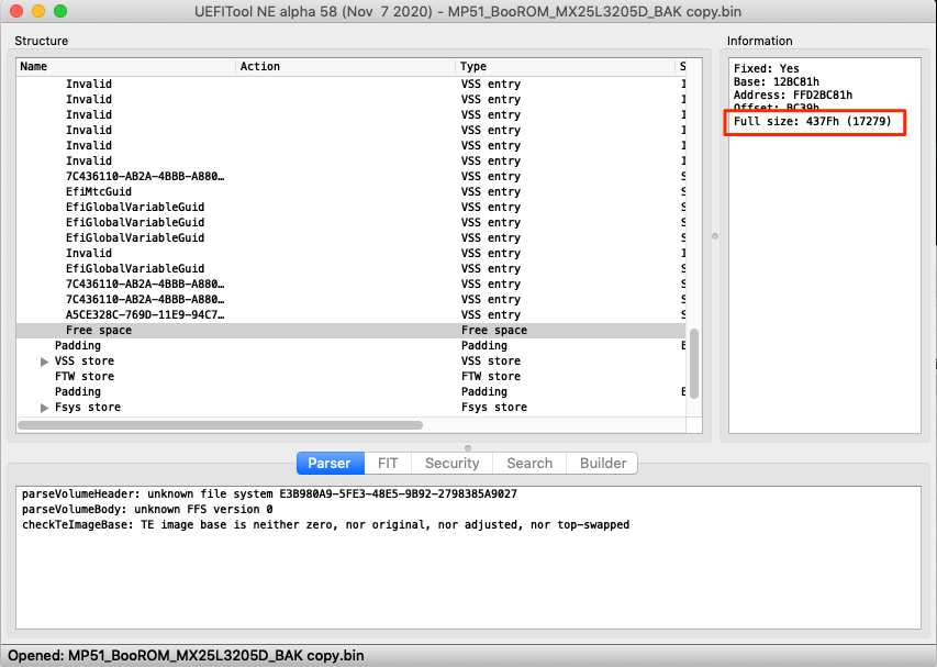

@tsialex thanks for the post above. For someone not well versed in this, how does one go about by cleaning the BootROM image? I was thinking of just cleaning NVRAM 3, perhaps 4 times then dumping that and keeping the saved binary file for backup.
If the NVRAM garbage collection already failed, cleaning the NVRAM will do nothing - only the secondary VSS store will be cleaned. If yours is functional yet, wait for the 5th chime and dump it.
For dumps where the garbage collection is not working and you don't have a backup dump, a reconstruction will be needed.
Reactions: JeDiGM and amstel78

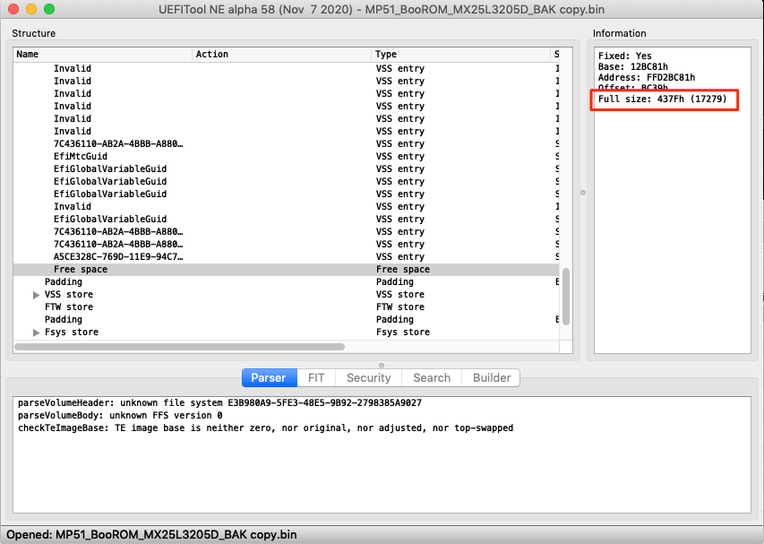

This is what my dump shows. Looks like I'm bound to start having some troubles down the road?
So do I just hold down Command-Opt-P-R until I hear the 5th chime, boot into non-OC MacOS, dump the BootROM and compare? If I get closer to 30000-35000, I should be good?
You probably already are overusing the last NAND sectors where the first VSS store is stored inside the SPI flash memory. This will cause SPI failure.
Always dump or flash from a vanilla macOS install - dumps, and the System Information reports, from OC installs are not reliable.
Garbage collection needs space to work. If the circular log lost it's control of the head and tails, usually happens when there are less than a third of available space, you will overuse the NAND cells and have problems with the volume itself.
MP4,1/MP5,1 was designed for another era of NVRAM usage, back in 2008 the NVRAM use was very sparse, today is heavily used for all sort of things.
