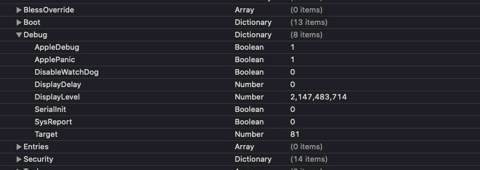

I've turned on debugging but can't seem to find the output log file in any of the EFI directories. I was hoping to generate this before uploading a bug report in GitHub. This is what I have set in OC config.plist:
For target, I used the following:
0x01 - enable logging
0x10 - enable UEFI variable logging
0x40 - enable logging to file
Converting to decimal gives me 81 but can't find the file anywhere. I even went to /var/log to see if perhaps it was placed there, but no luck.
OC boot log shows it's actually logging.
Setting the Target value to the wrong value can have bad implications.
Why muck around with manual changes when you are using MyBootMgr which comes with an app that will switch Debug Mode on, take care of changing all the files that need to be changed and set your OC config to the correct value?
Nothing wrong with doing it manually btw. Just that you need to make sure all the changes are in place.
There is a guide here: https://dortania.github.io/OpenCore-Install-Guide/troubleshooting/debug.html#file-swaps but do not go above 65 for "Target" on a real Mac as that is written for hackintosh.

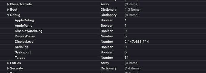

Try DisplayLevel = 2151678018, and Target = 65

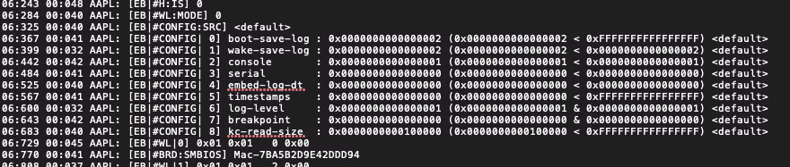

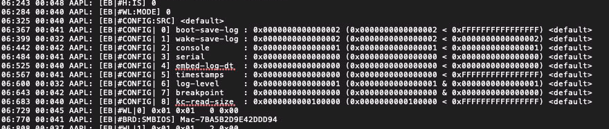

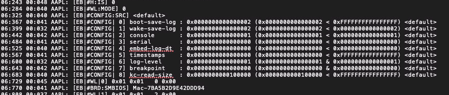

Understood but even with debug mode on via MBM, I couldn't find the logs. Where are they supposed to be saved?
In the ESP containing OpenCore.
You posted a log previously. It will be in the same location.
Reactions: amstel78
Ah, it's that log file which is saved as a text document. I was thinking it was going to be a different file or perhaps multiple files with a .log file extension.
