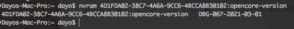

After booting using 0.6.7,
Code:
nvram 4D1FDA02-38C7-4A6A-9CC6-4BCCA8B30102:opencore-version
generates this response:
Code:
nvram: Error getting variable - '4D1FDA02-38C7-4A6A-9CC6-4BCCA8B30102:opencore-version': (iokit/common) data was not found
The same thing happens if entered with sudo.

After booting using 0.6.7...
I get this (different setup but to show it is working as expected):
My issue was caused by some kind of corruption in the NVRAM. Resetting it solved the problem immediately.
