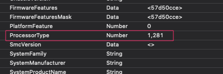

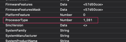

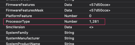

@cdf - take a look at my config.plist and screenshot. I'm using the config.plist from the first post with spoofing of the BoardID to enable continuity and updates (worked for 11.2.1 and 11.2.2) and VMM off - my processor is "Unknown"
Thanks for the info. If you could open an issue on the Acidanthera bugtracker with the output of sysctl machdep.cpu and dmidecode that would be great. Reports like this will hopefully get all processors compatible with the classic Mac Pro to be detected automatically by OpenCore. In the interim, you can always manually set ProcessorType (see the cpu list).

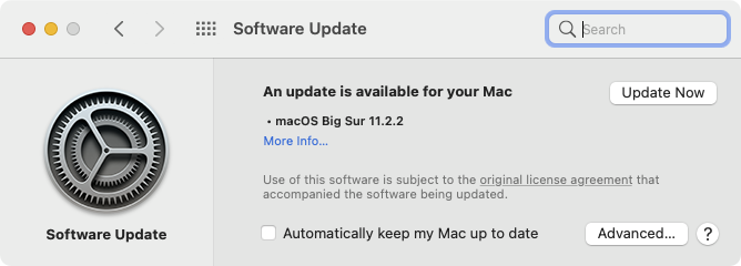

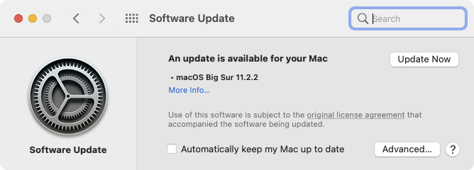

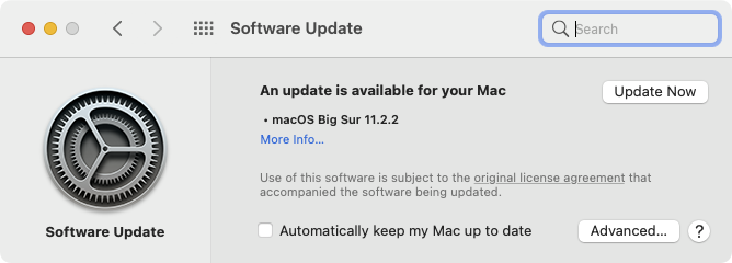

@cdf I got the 11.2.2 update this morning with VMM off by checking manually, but interestingly, I did not get an alert new software is released?
FWIW, with VMM on, the 11.2.2 update wasn't found. Installed it last night with VMM off with hybridization (iMac spoof). I did not change BIOSVersion to 9999.0.0.0.0 before doing it though (which was a bit of a risk) but it worked nonetheless.
Additionally, upon first reboot after initiating the 11.2.2 installer, the installer volume name was no longer called 'Mac OS Installer' or something to that effect, but rather 'Macintosh HD' which caused a bit of concern. Selecting it however allowed installation to continue. I was able to verify with others in the Big Sur unsupported Mac thread (https://forums.macrumors.com/thread....2242172/page-363?post=29638972#post-29638972) that this new naming scheme for the installer volume is indeed accurate and exists even in the 11.3 beta distro.
And no, I didn't get the notification either. Only found out about 11.2.2 update via another forum member.
@cdf - issue posted on the bugtracker.
Reactions: cdf
Thanks! I suspected that you had a W3690 because the X5690 does get detected properly.
