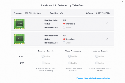

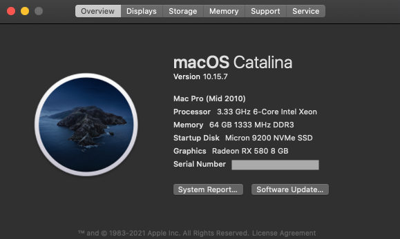

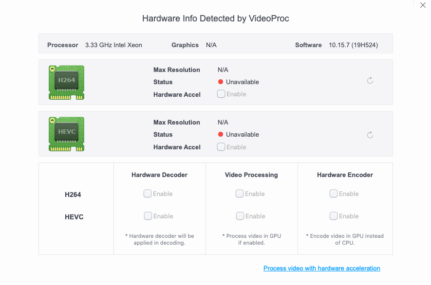

GPU Video Acceleration & DRM Support Not Working
I've spent most of the day reading through a number of threads but I'm stuck and would appreciate some help.
I"ve got a MP5,1 (Mid 2010) single processor with 3.33GHz 6-core XEON, 64GB RAM, a MVC Radeon RX580 8GB gfx card, a Micron 9200 NVMe SSD, upgraded WiFi+BT which thanks to OC runs Catalina. Most of the installation of OC was pretty straight forward, however the one thing I'm struggling with is video acceleration and DRM playback (Apple TV+). So far I've upgraded OC to 0.67, added the Lilu 1.5.1 and WhateverGreen 1.4.8 kextx to the OC/Kext folder and modified the config.plist as per instructions on the first page.
Gfxutil comes up with the following:
05:00.0 1002:67df /PCI0@0/IOU0@3/GFX0@0 = PciRoot(0x0)/Pci(0x3,0x0)/Pci(0x0,0x0)
I changed the address in the config.plist accordingly.
However I still get no video acceleration nor can I stream Apple DRM content. VideoProc (latest Trial) also shows both H264 and HEVC as unavailable.
I attached the config.plist to this post, it would be nice if someone could have a look at it and maybe let me know what's wrong.
Another thing: once I get video acceleration and DRM playback to work I intend to upgrade to Big Sur. Can I assume that video acceleration and DRM would work there, too?
